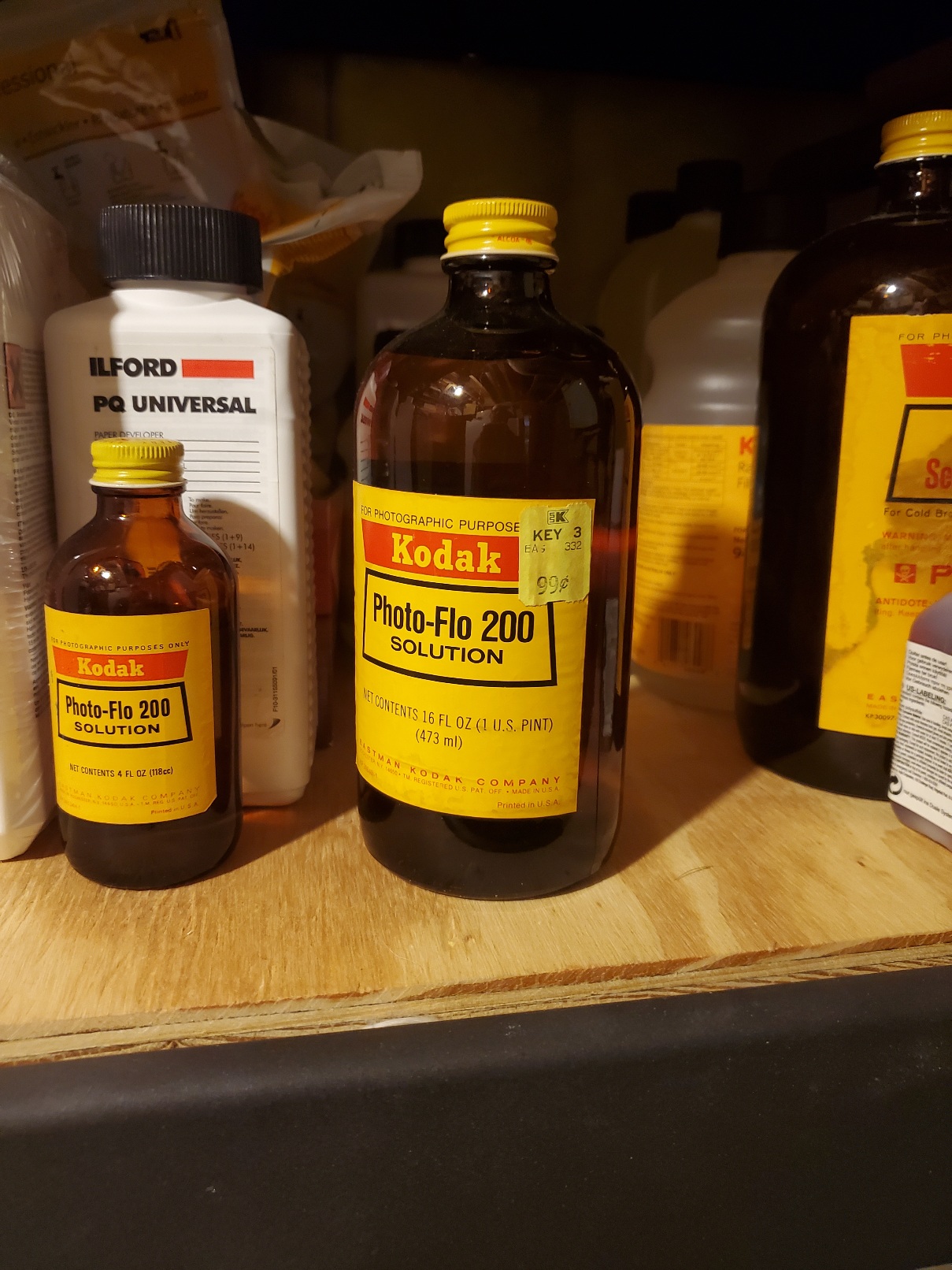

This is my situation. I'm where everyone says "do you want this?" Not sure when K-mart was selling glass bottles of Photoflo, probably the late 60's. The small 4 oz bottle is what I always used, "1/2 cap per 20 US fl.oz." That's the little tiny metal cap
