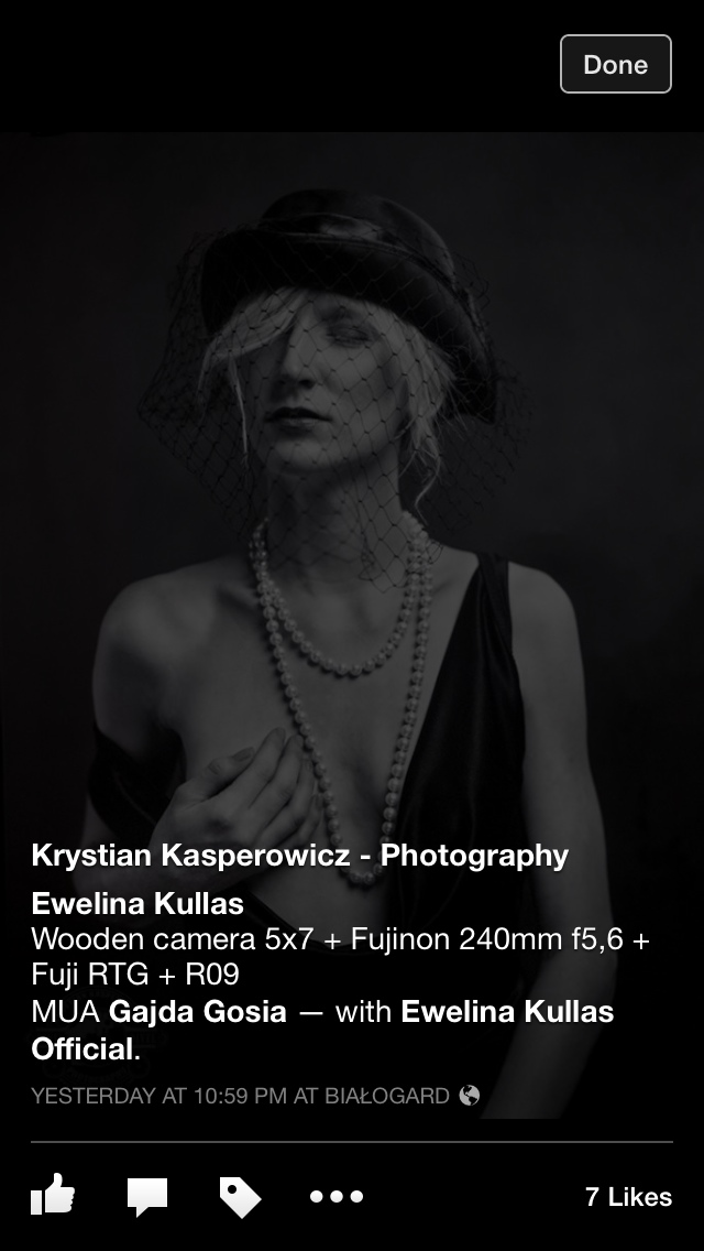

I just saw this and though of you....
Shot by another photographer on X-Ray film...
Credit:
I wouldn't call that terrible...
Without a 5x7 using TriX or the like, I can make no judgment. Sorry. I agree that it does not look bad. But who is to say what a "real" professional film could do.

The image of the girl is not my image, it's someone else's, because I haven't made any good ones yet... but I will ... but I've seen a TON of really beautiful landscapes taken with x-ray ... and I plan to make a bunch of my own.
I'm using AGFA Curix 11x14 x-ray film, which I'm pretty sure is a true x-ray film, the contrast was fine, the density in the negative was great, I just didn't aim it very well being was using a cardboard box... lol
The stuff I will use from Kodak, the Ektascan for my 8x10, is still film, even if it's specialized to something other than "traditional" x-ray .... and the point isn't weather it is or isn't x-ray, the point is that it produces a fine image and costs 400% less than the stuff kodak is selling as normal B&W film...
It's fine I suppose. But who knows what ph0t05h0p gymnastics were required vs working with a general purpose film. It's also a studio shot, which means the lighting, contrast etc etc can be controlled. I didn't realize that was your intended application, so point taken (sort of, not really :D). But I still think in the field this kind of film would be difficult to use and would be a fairly lousy performer overall, particularly with darkroom printing. It seems to me it really defeats the purpose of moving up in format size, but that's just me.
