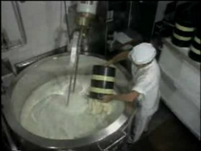

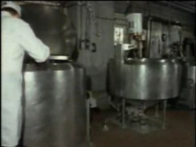

Attached is a screenshot from a video available at:
http://www.archive.org/details/corona_overview
The scene starts at 6:00 minutes
It shows some "kettles" used for emulsion making. The scene is VERY brief. I don't think it is worth downloading the video...just view the screenshots.
Emulsion
This was a hodgpodge of images from the 60s, 70s, 80s and 90s actually, and the screen shots do show a melt being prepared, probably for a color emulsion coating. The emulsion is not yet added as they are in the light and the mixture is already white as if it were carrying a color dispersion. Very nice overview of the project.
The estar used was 2 mil (0.002") thick and was used for John Glenn's launch as well as on the moon. It was developed for NASA and the USAF in the late 50s for space use. A Kodak engineer from the project was shown in one of the quick cuts.

Thanks Emulsion, that was interesting.
PE, this is the frst time I have seen those black buckets in use... have you seen these before?
Were they plastic?
I still remember being pulled out of bed REALLY early one morning (it was still dark outside!) to meet John Glenn. I guess he was just doing my dad a favor. Nice memory!
Ray;
I have never seen black buckets like that before, no. We had square black and also blue containers called bakelites and knee high stainless steel cans in film manufacturing. Paper mfg used more plastic containers, but I never saw round ones there. The square ones were used due to ease of stacking and storing.

I have been looking at those buckets and kettles again. They are not for emulsion making. They have the wrong type of mixer. And the buckets are for addition of chemicals that are being mixed. The emulsion kettles look quite different as does the support equipment.
