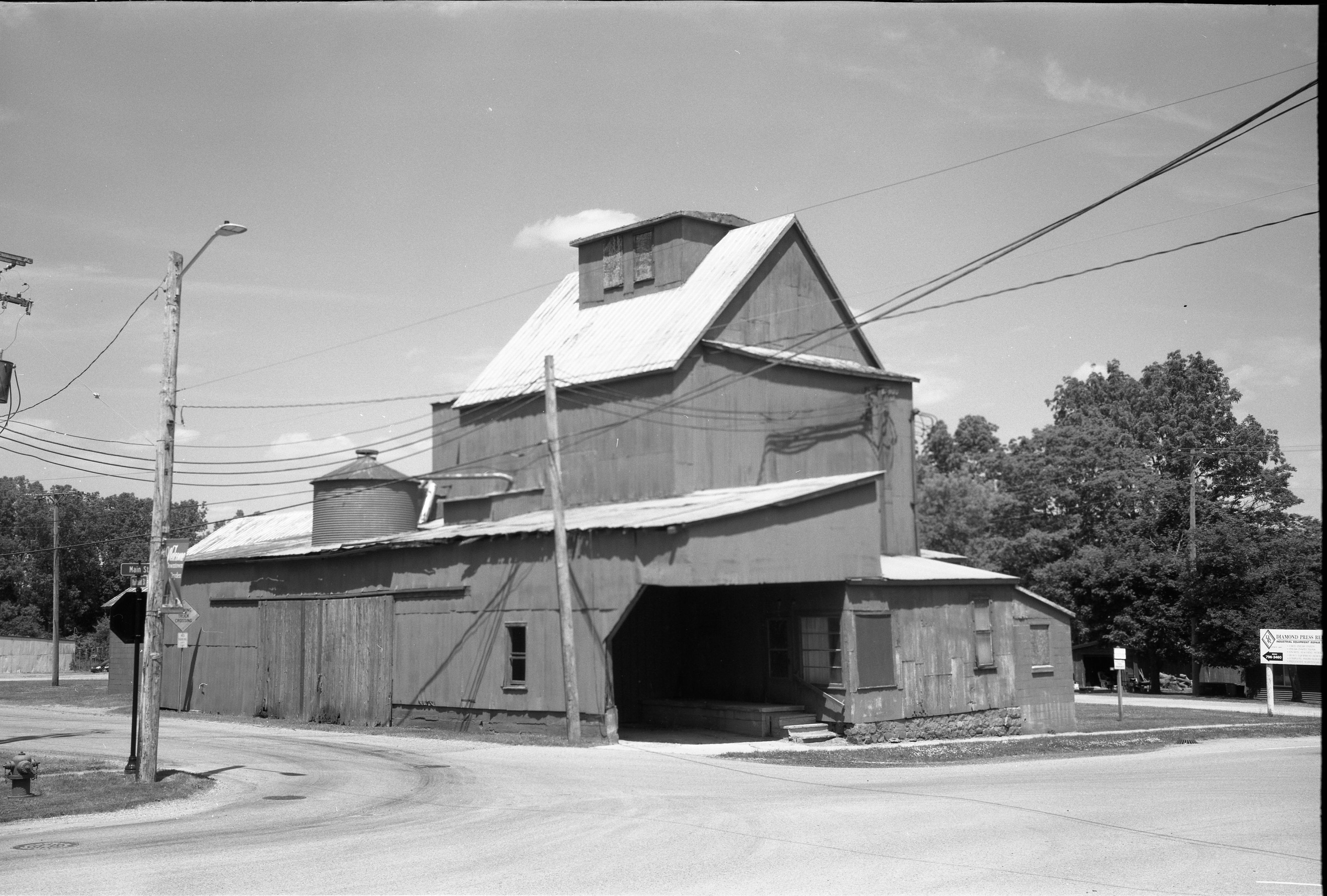

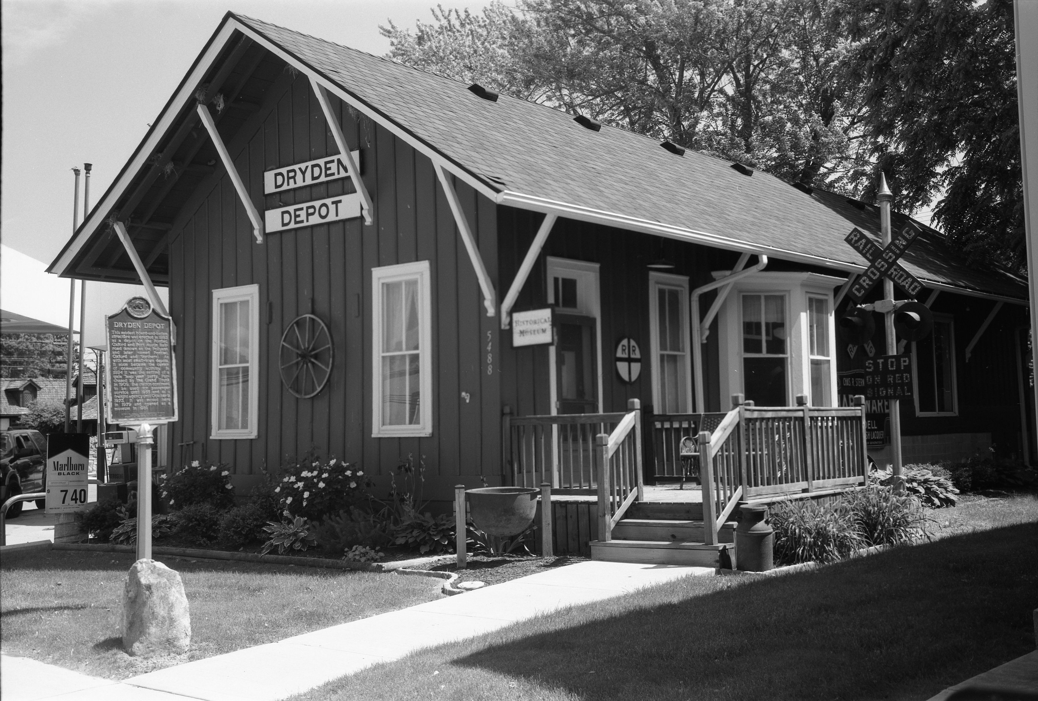

I got a couple rolls of Kentmere 200 and wanted to test one of them using my (up to this point highly reliable) Kodak Medalist. Film was transferred onto one 620 metal spool and then back onto another in a method that I have used many times with Kodak Tri-X, Gold 200 and Ilford FP4+ and Pan F without issue.
Upon development I found frames 3, 4 and 5 had unusual and inconsistent out of focus regions towards the center of the frame. The other frames on the roll were tack sharp as I would expect from the 100mm f/3.5 Ektar on this camera. I verified the areas of improper focus are visible on the negative with a loupe and not just on the scan.
The frames in question were all shot at either f/8 or f/11, whereas this frame was shot at f/4 and is sharp across the frame as expected.
I'm not inclined to think this is a lens adjustment or rangefinder issue. My leading theory right now is the film is buckling or warping and the pressure plate isn't keeping it flat enough, but I'm curious to hear other peoples interpretations and why I'm only running into it now.
Full size TIFF files can be viewed here: https://www.flickr.com/photos/158396499@N04/albums/72177720326903841/
(Please disregard the dust and imperfect cropping, these are pretty much straight off the scanner).

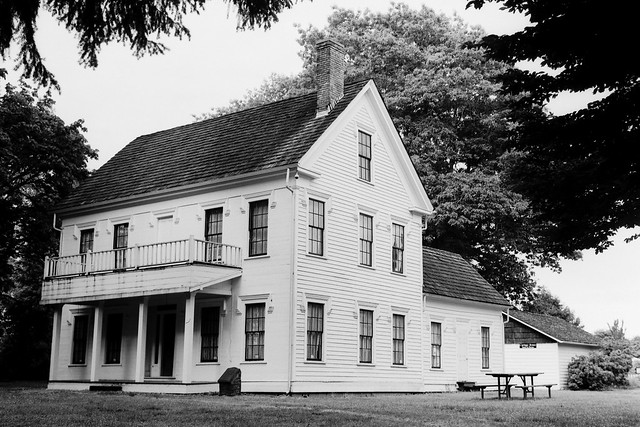

I just noticed the same thing on some shots with my Medalist from a few weeks ago. Ilford Delta 100 developed in Beerenol. I don't remember the settings, they were slow shutter speeds both done with a tripod. In the first one you can see the roof and top front of the building is a little out of focus. The rope below the roof which is on about the same plane as the upper portion looks to be in focus. The roof slopes back and looks out of focus but the right side of the building is in focus. The second shot looks fine.
Fort Borst Blockhouse by Bryan Chernick, on Flickr
Historic Borst Home by Bryan Chernick, on Flickr

The strange thing is that the plane of sharpness does not seem to be shifted anywhere. In your first picture the road sign in the foreground is unsharp - and the tree behind the house also is unsharp. If film flatness was impaired plane of sharpness should be shifted into the foreground or background it think...

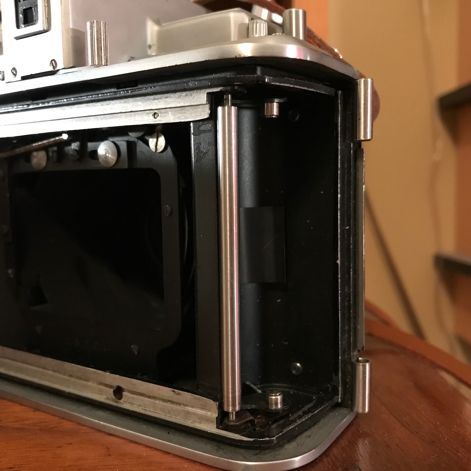

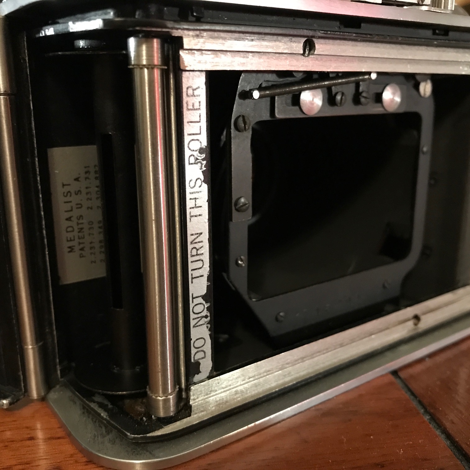

For those interested, here are what the rollers on the feed and takeup side look like:
Well then my theory doesn`t really apply as to my theory frame 1 and 7 also had to be unsharp.
I see small teeth on the roller close to the take-up spool, where the note is not to turn this roller. I assume these teeth to stitch into the emulsion, making the roller turn and probably driving the frame counter of the camera. These teeth could exert tension on the film edges.
Can't say for sure on a Medalist, but that's exactly what such teeth do in a Kodak Reflex II -- I've had the frame counter apart on one (about fifty years ago).
Yes, that's what the teeth do here too. Though it still poses the question as to why it's causing an issue here, and hasn't in the past. I think I'm going to check dimensions on the width of both the film and backing paper of this roll of Kentmere 200 in comparison to prior Ilford and Kodak rolls and see if there's any discrepancy.
The rollers on both sides look normal. The feed side roller issue I had a concern about is not happening here.
