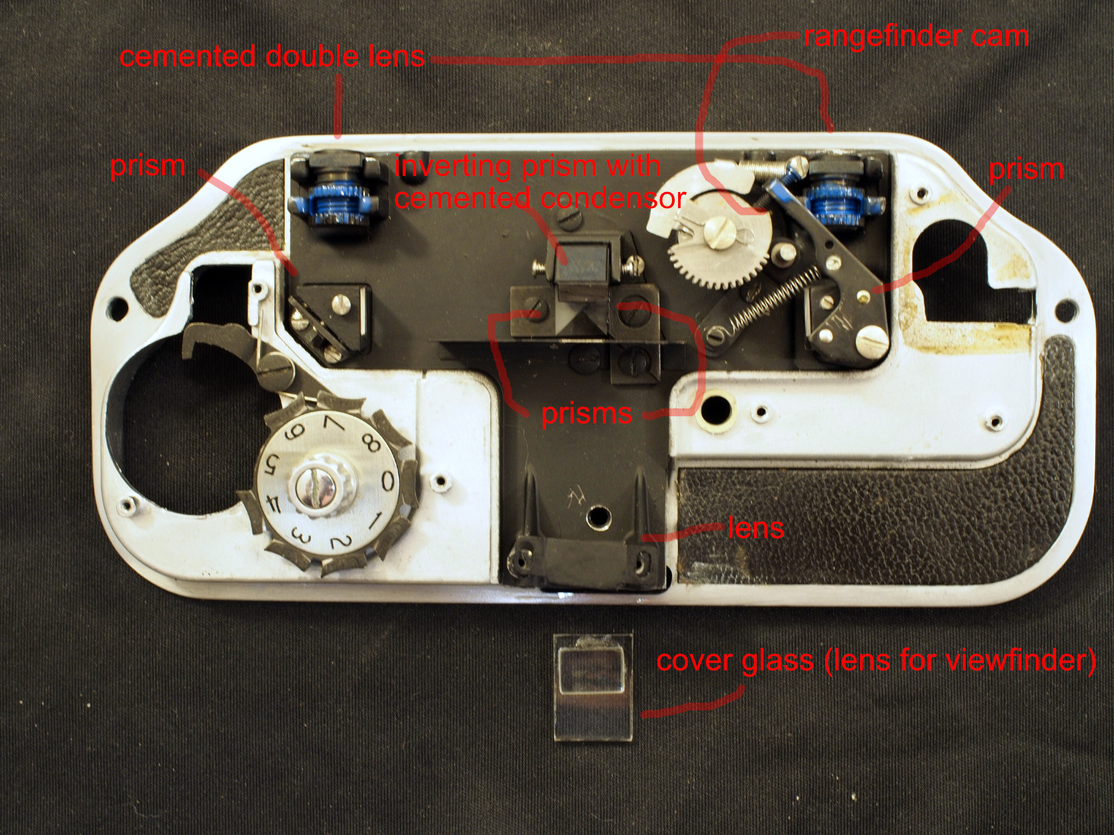

SImilar to the Medalist wind system overview, here are some notes on the rangefinder. Even less instruction.
(There are some silvered surfaces on central prisms for a short time...)

Vertical- move the left and right front tubes up and down. Move by prying- slide a screwdriver under the front and lift- or by hammering down. Both lightly and very small amounts, of course. Look at a triangle to get a match of the upper and lower image. After adjustment, be prepared for it to shift overnight and need to be adjusted before sealing up.
Horizontal- the Medalist does not have an infinity stop. The focus scale is arbitrary. The thing that really matters is the agreement between the film plane and the rangefinder. All the rest is fluff. On back of the lens tube, upper right, are a smaller silver headed screw and a larger black headed screw. The silver screw is a lock- undo about 1/2-3/4 turn. With ground glass in the film plane, open lens and focus on something at a medium distance. 10-15 feet. Now adjust the black screw, which moves the rangefinder cam, in and out to get the film plane focus and rangefinder focus to match. Turn lock screw back in. The basic idea is that with the rangefinder and lens in agreement at one point, the cam and helical motion agreement across the range will be maintained. In practice this does work out.
Short version of full rangefinder set up- Get lines straight, split top/bottom set (sorry, that's about four paragraphs). Lens at full extension, set focus scale with 3-1/2 foot line under red IR mark on scale. Have camera 10 feet (10.0 at aperture scale or so) and set cam follower (skinny black arm on right prism mount) so rangefinder alignment and 10 foot mark agree (Kodak manual says use 15 feet for this but I have a small shop and consider accurate close focus more important). Now do rangefinder/lens alignment procedure above.

Well, there is no > good < way to set the focus scale to hit both close and 15 feet. There is a very bad way to do it, involving twisting the end of the cam follower in and out to hit the points.
The lenses: You can use serrated needle nose pliers to loosen the rear retaining ring. And after removal of the lens tube, the middle ring can be loosened. Now you can move the lens tube back and forth. I've played with this and have had no real results of changing the focus of either rangefinder image. I may be missing something or may not be noticing improvements or changes. I have seen some separation in these lenses- newton rings- visible from the front. Maybe some lenses are simply never going to focus? Now there are ways to move the two 90 degree prisms in their mount and this can affect imaging for the rangefinder. But this is pushing my tolerance for random experimenting without any real understanding of optics and this particular setup. I assume that Kodak had some nice jigs and bench assemblies for making all 19 or whatever adjustments point play well with each other.
If you do find a way to make focus sharper, please let me know.
I may have gone through this earlier in this thread, or maybe I've changed my thinking since this thread, but the basic steps...
I assume that Kodak set up close focus to the camera standard- 3-1/2 tick mark at the infrared dot. So this becomes my reference point for installing the focus scale- rack lens out to stop, install scale.
And yes, my standard is to then set the scale to 10 feet (15 feet per Kodak manual). Using either adjustment screw, or bending the cam follower.
Now set focus on film plane and rangefinder to match using ground glass on film plane and the internal adjustment screw at upper right of lens tube back plate.
This gets me pretty close to infinity focus on rangefinder (distance electric tower for me) matching infinity on focus scale.
If using infinity as the set point rather than 10/15 feet is making it work oat ot her ditances for you, I don't see a problem. It should work this way?
