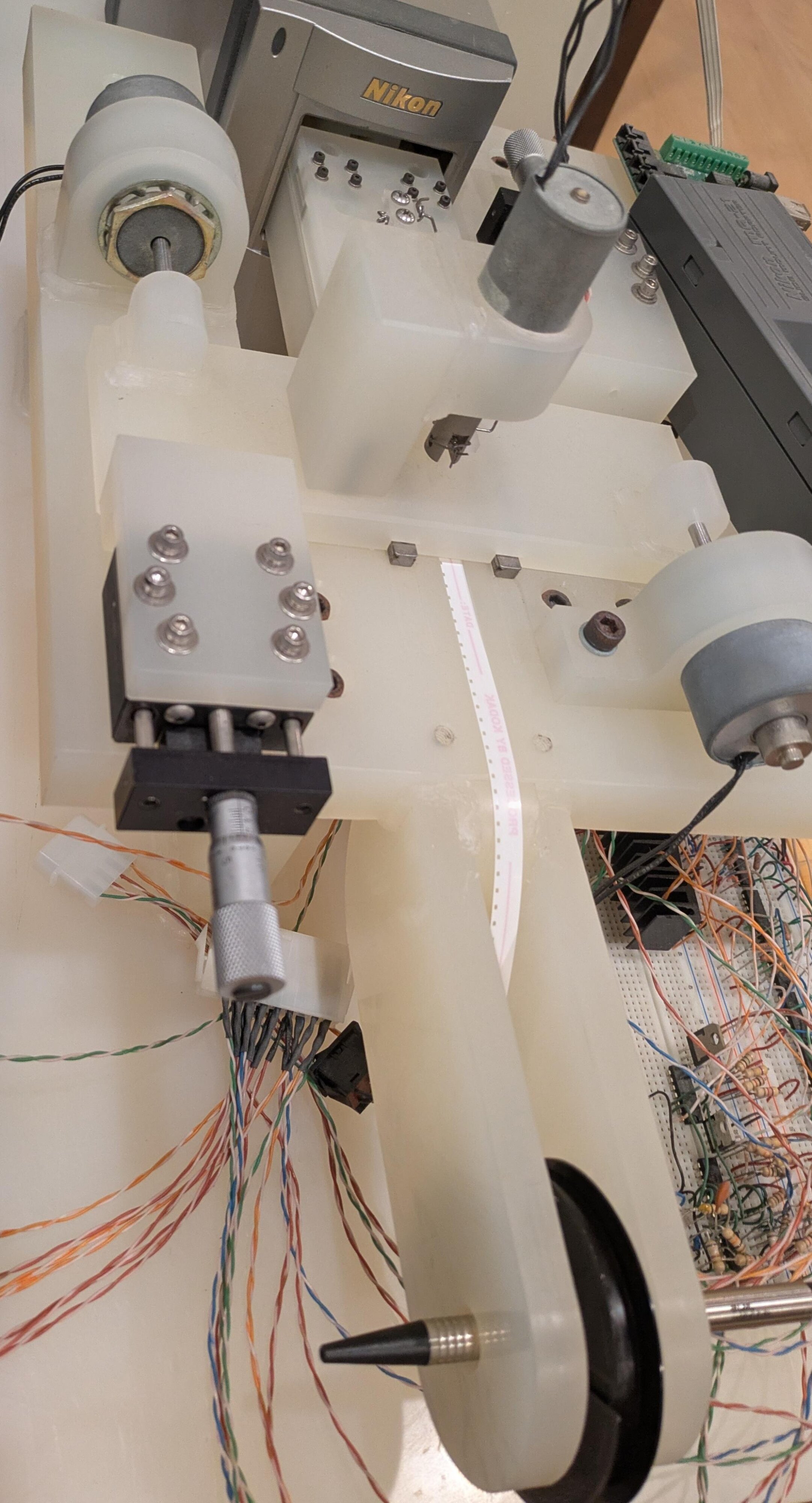

I realize this is an old thread. Do you still have your Q-60K3 calibration target? Or a spare? Or know who sells them? I'm going through a box of old Kodachrome from my dad and this is one the few places on the Internet I see someone mentioning this specific calibration target. I have an nikon ls5000 that I'm making an 8mm adapter for.

Some rig there. From looking at the photo it appears to be an automated scanning setup for a Nikon 8000 or 9000 scanner. I'm impressed. Can you tell us more about it?
I understand not letting go of or loaning the calibration target seeing as they're impossible to get a hold of.
It is based off a nikon ls-5000. I know most film adapters go inside the scanner, this one, the scanner fits inside of.
I have a box of 8mm reels from my Dad. This was a project I started over 20 years ago, you can tell by all the breadboards. This was the 3rd version of it I made. 1st version did work but was super janky. I started working in industry and didn't have time/motivation to finish. With more than a decade of time passed some of it doesn't work quite right anymore. But, I have more far more experience than I did back then. So with unemployment it is time for me to finish it, scan the reels, and then I can get rid of it! Instead of it being the albatross it is. I'm in the midst of writing a driver for the scanner and will hopefully finish with that by the end of the week. I need complete control over the exposure levels, when shading calibration happens, direct control over slide movement and when autofocus happens etc. I can't have scan parameters changing between frames besides focus. Besides there is almost no working software available for the scanner anymore.
