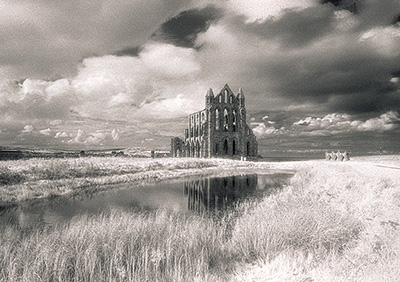

Here is a resized scan of one of the frames that shows how bad the grain is.

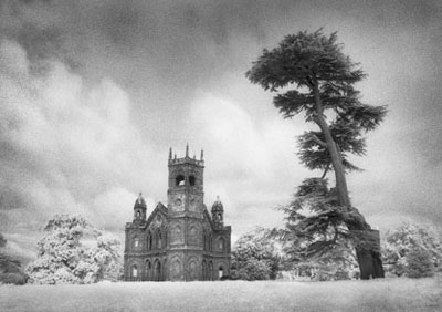

Compare the grain in the last image with a frame I shot at Stowe a few years ago.

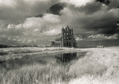

Here's the first image after the 3 frame HDR treatment to reduce grain.
