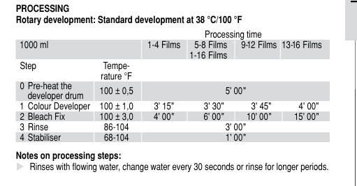

Adox recommends a short water rinse, and I’ve been following this practice since the time when Tetenal advised the same. I haven’t noticed any adverse effects from doing so. Why do you recommend otherwise?
You'll find an answer to this by reading the whole thread :smile:
See post #60.
It's unclear to me why the water rinse is proposed after the development step. It really makes no sense, regardless of who came up with it.
See post #60.

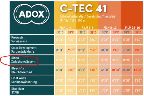

Thanks. My brain is playing tricks on me. I searched for the original TT C-41 manuals, and there’s no water rinse between the developer and the blix. So it must be Adox who added that step, maybe to preserve the blix?"
The rationale is most likely indeed to preserve the blix, but it seems they misjudged the significance of developer carry-over into a plain water rinse. I hope that in a future kit they'll include an instruction to use an acetic acid stop bath and perhaps supply an additional bottle of something like 10% acetic acid, which should be weak enough to not get into any consumer safety trouble.
This thread has already explained why we shouldn't rinse with water only after developing. The thread is long but it's worth reading in its entirety.

See post #60.
The water rinse after CD makes a lot of sense, if you then go into a BLIX. Note, that Kodak never recommended a BLIX.
BLIX is neutral, and CD-4 will happily oxidize with the BLIX and then form a dye. There were many reports here on photrio about "yellow blotches in blue sky on C-41 negatives", and it was most visible on medium format negatives.
The "Kodak&Fuji" way is to use an acidic bleach, which avoids the issue. If we want to use BLIX, then a stop&sulfite bath as described by @Spektrum is highly recommended.
It makes sense from the perspective of the blix, but looking from the other end of the process, it doesn't make so much sense to go from CD directly into a water bath.
