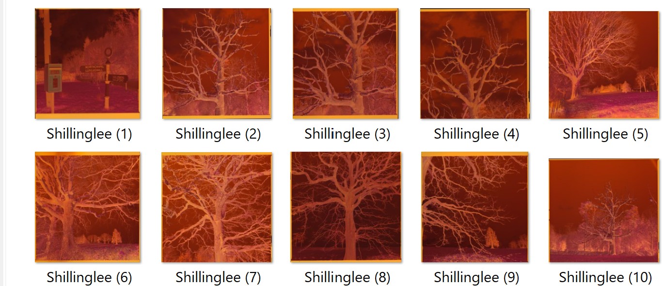

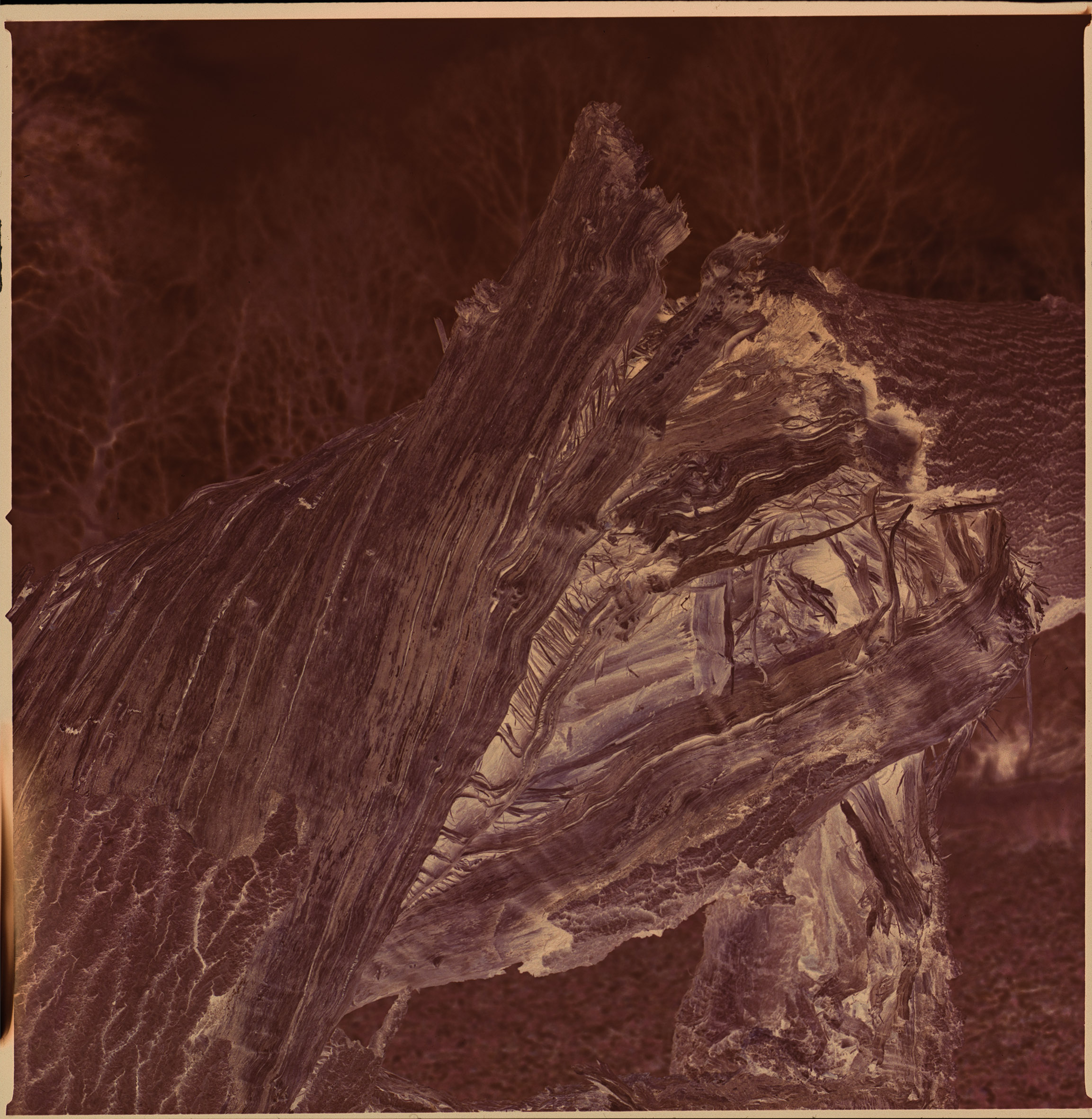

I've no experience with 35mm film but I've had excellent results with 120 Portra souped in the ADOX C41 kit. I process at 30 degrees with a Heiland processor (no temperature control) and add 40 seconds for the temperature drop while developing (total time 8'40"). I blix for 7'30" and use a 5 minute pre-soak (no agitation) at 30 degrees. All chemicals including wash water kept in bath at 30 degrees.
Processing at 30 degrees gives substantial timing advantages in my opinion.
Exposure was at box speed and whereas the negatives seem on the dense side they scan beautifully.
Attached snip of the negatives (note the bright orange mask) and an example of one negative after removing the mask in Lightroom
This is at least to a large extent due to generous exposure. Especially frames 3,4, 8 and 9 received at least 1 to 2 stops more exposure than necessary. As you observed, they can still scan just fine; the main drawback with overexposure to the extent shown in #8 is that you tend to get a lot of highlight blooming.

It works, evidently, but there's also a penalty in terms of color fidelity. This may be entirely acceptable especially when scanning, however.
Yes, I agree that they are somewhat over-exposed although it was certainly not my intention. I was in a rush (and a bit lazy) and metered off the (convenient) blue sky which I accepted as neutral grey. That was my mistake I think.
Not as dark as you think! The sky is generally lighter than the foreground. It's also illustrated in your negatives; the sky is denser than the subject matter in the foreground.
Hmmmm but that would then not explain why my negs are over-exposed unless my lightmeter is way off. Goint to check it.
Exactly; something odd is going on with the metering. What kind of meter is it and how are you using it exactly?
Btw, I personally sometimes use the sky for metering too, but assume it'll be 1-2 stops brighter than the main subject (unless the main subject is the sky...), depending on the conditions.

Using a Digital Pentax spot meter, spot on sky opposite the sun.
I've a day off and nice weather so will shoot a roll metering with two different devices
Thanks for the interesting comments :smile:
OK, that approach should work, although as said, it would result in underexposure instead of overexposure. Maybe the shutter on this camera is (very) slow?

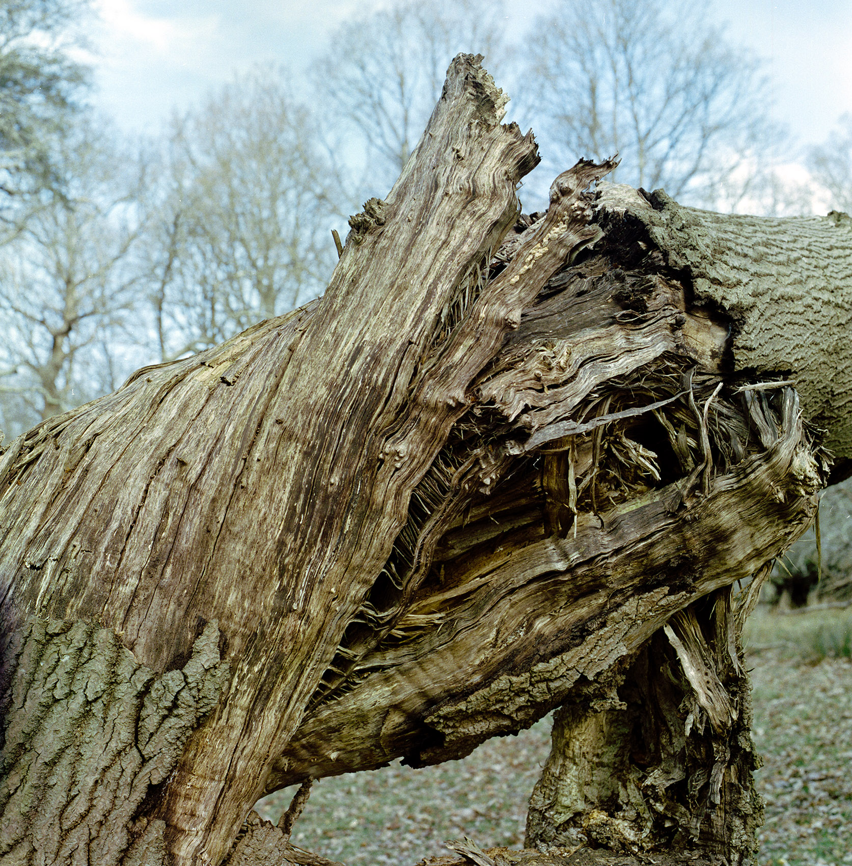

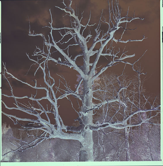

I was out again yesterday (I'm documenting ancient fallen trees) and here is one example (Portra 800, exposed at box speed) developed at 30 degrees in ADOX C-TEK 41. The negative is slightly dense (overexposed) again. I'm still trying to find out the reason.

Thanks Walt - these things are of course personal preference and monitors etc play a role here, but do you notice a small cyan or perhaps greenish dominant in your example? Again, perhaps just personal preference or the impact of seeing this on my own monitor.
