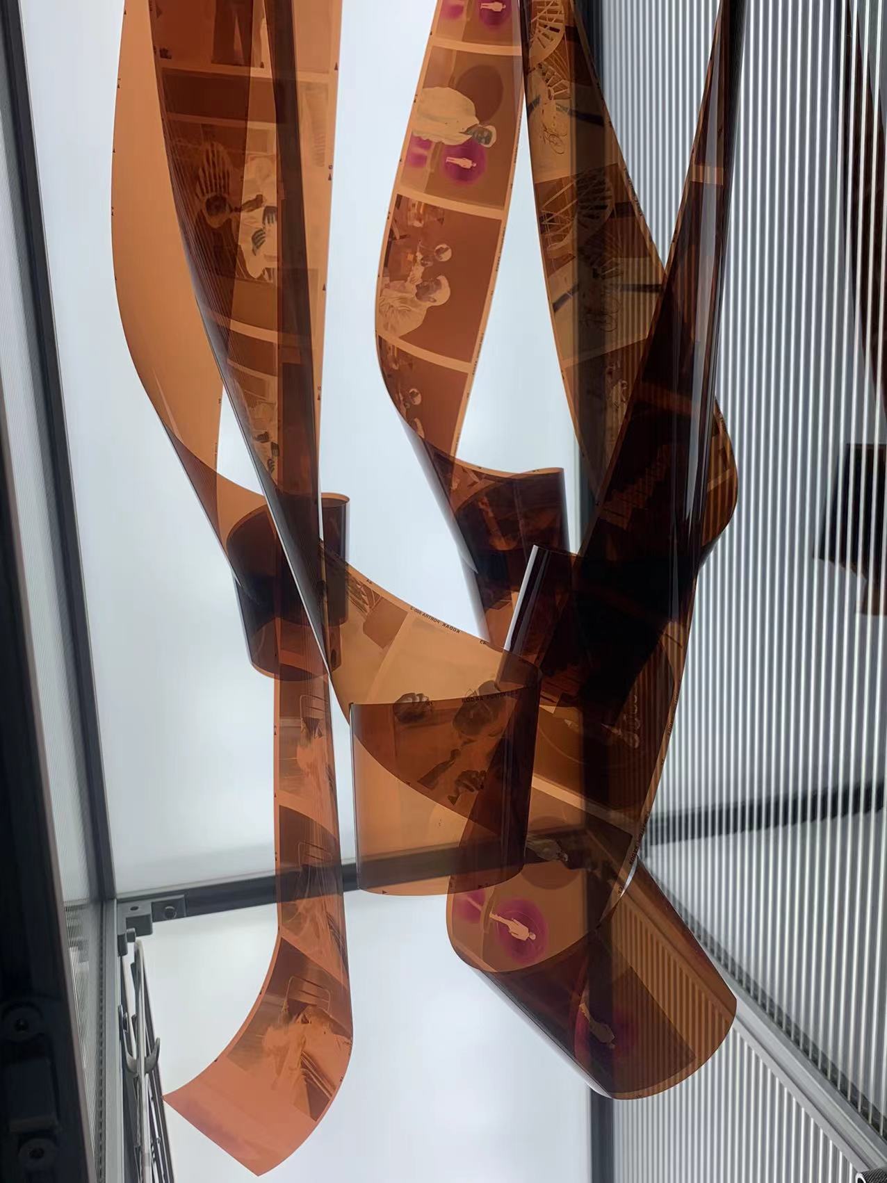

I develop 10 to 15 rolls of film every day. This type of film base has been in use since the beginning of this year, and it’s the same every single day. The feel of this film base is quite poor and not user-friendly at all. It generates a lot of static electricity, attracts more dust than before, and is very unpleasant to work with. However, Kodak 5207 and similar films don’t use this kind of film base. Kodak is simply cutting costs without considering the user experience, as they now face no competition. Every change they make is driven by capital.
None of mine curl at all.
There is something awry in your process or environment.
