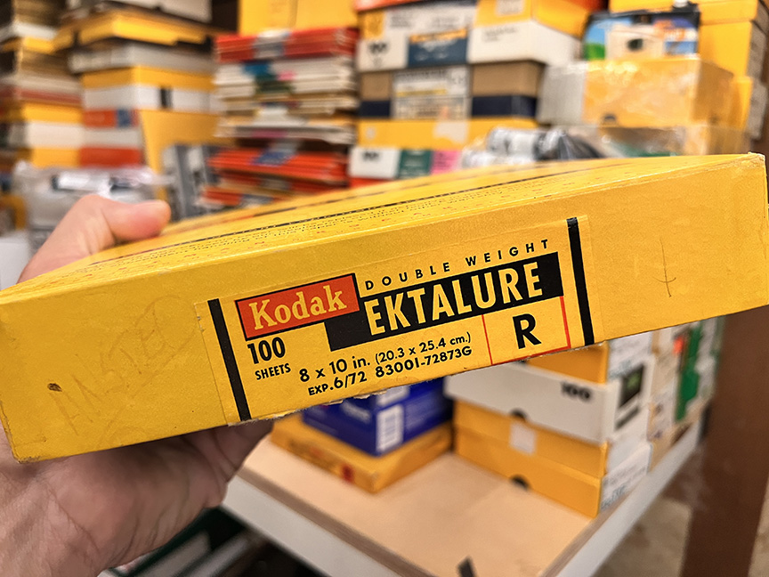

I've got one unopened box of the R left, had it for 20 years. Got it from an old friend who had cases of it around and always said "Now I just have to print it all before I die"...then he died. I dont know what happened to his paper collection but you coulda filled a U-Haul with it. I'm going to Lith print it. As stated here, it prints beautifully if you're into Lith printing - but at 5 to 10 dollars a sheet if you can find it on eBay, probably going to let that ship sail after this one. Saw a box of 10 sheets of 20/24 for 35$ a sheet recently! Guys out there selling folklore. It is a lovely paper, but there are many more...and if you Lith, you can get similar lovely results with even older papers with no folklore attached.

I've got one unopened box of the R left, had it for 20 years. Got it from an old friend who had cases of it around and always said "Now I just have to print it all before I die"...then he died. I dont know what happened to his paper collection but you coulda filled a U-Haul with it. I'm going to Lith print it. As stated here, it prints beautifully if you're into Lith printing - but at 5 to 10 dollars a sheet if you can find it on eBay, probably going to let that ship sail after this one. Saw a box of 10 sheets of 20/24 for 35$ a sheet recently! Guys out there selling folklore. It is a lovely paper, but there are many more...and if you Lith, you can get similar lovely results with even older papers with no folklore attached.View attachment 407077
Love the background of that pic ! Love that kind of vault 😊
Dang Vincent, you better get printing! That is quite the stash....

It would take 10000 years to lith print all that paper.
I'd try regular enlarging on the Ektalure before deciding on lith.
Beautiful, and Welcome to Photrio!

Haha, you guys are great...that's about 1/4 the stash...about to start my sons on black and white photography with some old F3's...maybe they'll print it all in the end!
