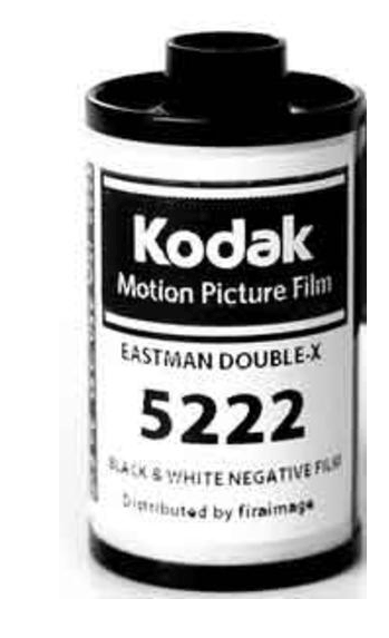

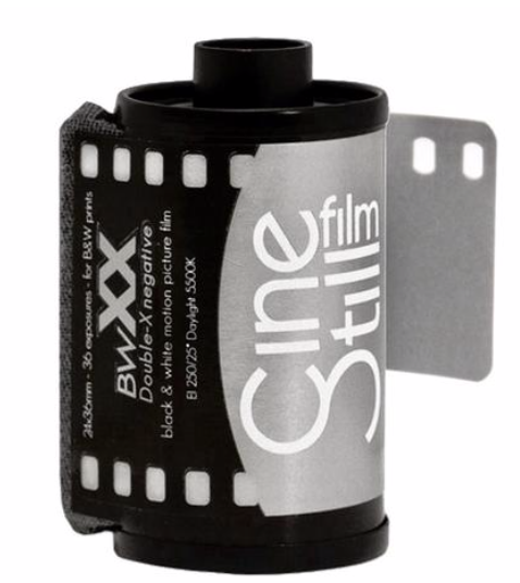

Hi there....I'm going to shoot 16mm motion picture Eastman Double X on my Aaton camera for a project and I wanted to get hold of a roll of 35mm and shoot it to see what it looks like before I roll camera......
I see two options available to buy......one is the Cinestill BWXX Screenshot 2019-02-12 at 10.58.56.png and the other is packaged as Kodak Eastman DOUBLE-X 5222 Screenshot 2019-02-12 at 10.51.26.png ...are they both the same film just sold by different vendors?
OK other information I have is this film is best used with D-96. This is what Cinelab London use in their BW bath for the motion picture industry. Obviously 'best' is interpretive but Im going with D96 cos Im doing a test with the film as I mentioned......
It's the same. AFAIK Kodak doesn't do any other b/w cinefilm. I bought a couple of rolls from a shop in HK a few years ago. They put on a printed label similar to your second option. About €5 each, which is expensive enough and half of what Cinestill charge.
