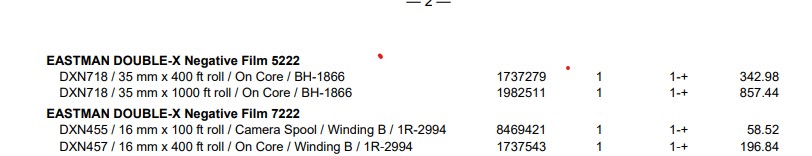

The reason why chose to go big with the 400' as apposed to buying 100' rolls where I would have to pay shipping etc in US funds. 4x100' would have cost me $ 640 CDN. Another is the freshness of the film. BTW these are CDN prices
