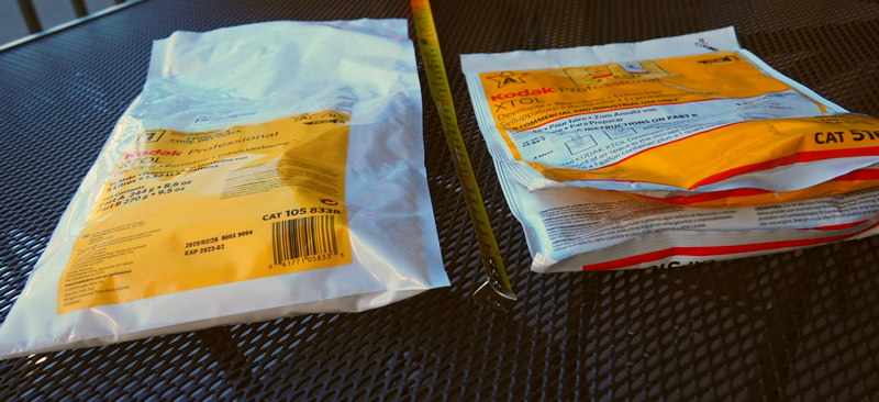

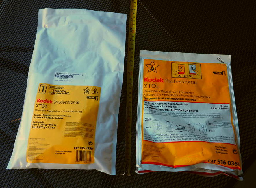

I'll try to take a dimensioned digital picture to post here, for reference.
Here you go.
The latest packaging on the left, and the historical, pre-Tetenal receivership packaging on the right.
Note that the large, outer package in the new packaging contains two separate bags of the same durable material - one for part A and one for part B.
The historical packaging had no exterior bag - it is/was just two bags attached together.
I don't have an example of the interim packaging, which I understand to be in the same arrangement as the historical packaging. I've heard, but can't confirm, that the problem with the interim packaging was related to the way that the bags were attached together.
