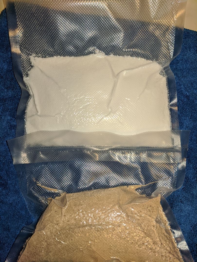

Got my replacement D76, decided to rebag it using my vacuum sealer. Then for grins, re-bagged my bad batch (I confess, I bagged the bad stuff as a test run).
Any guesses as to which is which?
:unsure:
grat
May 8, 2020
2,046
Gainesville, FL
I was considering trying to use the bad batch, but I noticed some black bits in there as well (not visible in the photo), and it was seriously clumpy.
