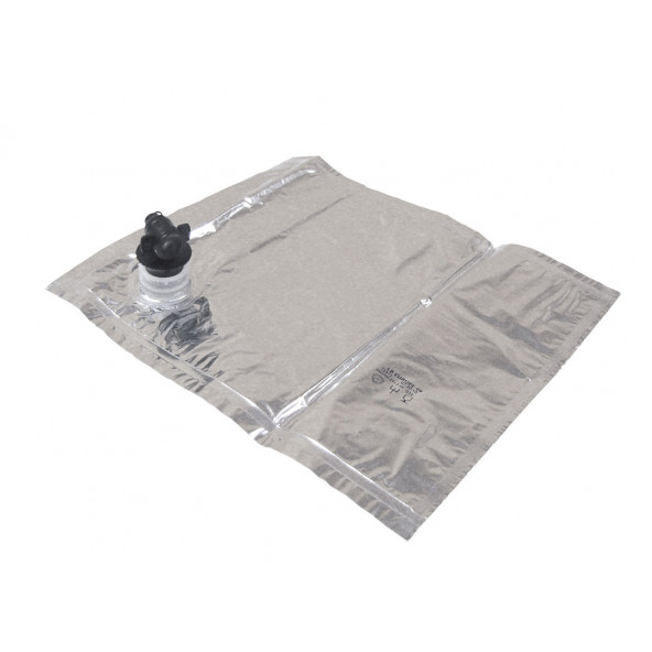

Could you please give a link to the wine bags you use? (I'm in the EU, but hopefully will be able to find the ones you use somewhere.)
Also comes in 5L and 10L sizes. They also sell boxes that envelop the bags precisely.

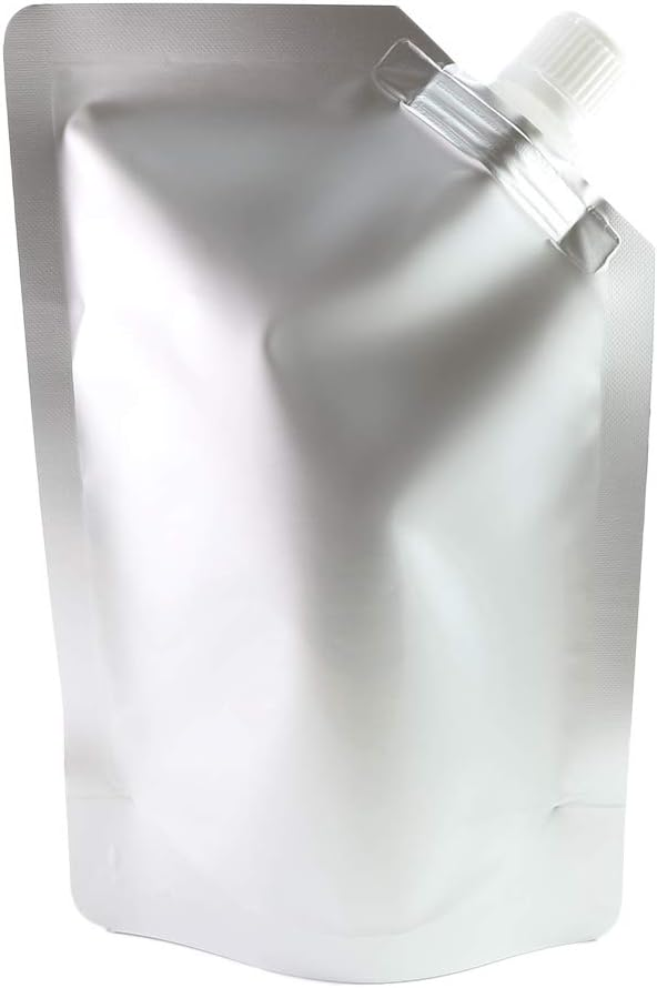

Mine looks like this, they can stand up on their own.
And the Amazon link:

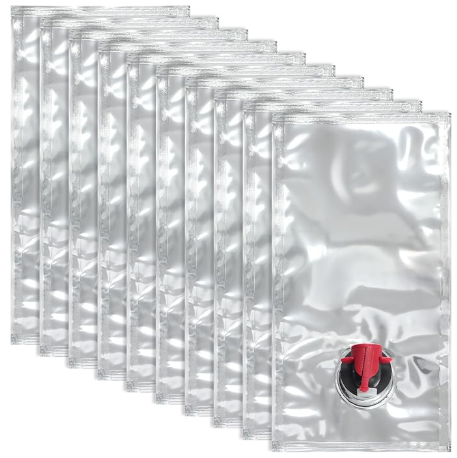

That's a nice design. The bags I purchased will not be as convenient. I'll figure something out though... The ones I ordered are this style:
Thanks, they look more practical!
Yes, if one is going to put the whole bag in the bath, these look great. I plan to dispense what I need into a PET bottle, so I won't have to worry about the lack of support that the bags I shared will (or more appropriately, will not) provide...
The ones for fruit drinks/smoothies etc have a screw top and a funnel is provided with them. (That's why you don't want "wine bags" with taps!)
I did a "wet" run with water to test all of the procedures I knew what I would have to do priort to putting chemicals and chemical exposure of me at risk. These are terrible. Well, not intrinsically, but I do not have the right tool to remove the tap easily and re-filling them is a nightmare. The dispensers are so tight that would require superhuman strength to remove them without a tool. I'm using PET bottles in 1 L and 0.5 L size for now. Developed my first two rolls today and it went well and the negatives look good. The final rinse left a few stains (I can probable rinse in distilled water to remove), but I was proud of my first C-41 negatives ever and using this kit.

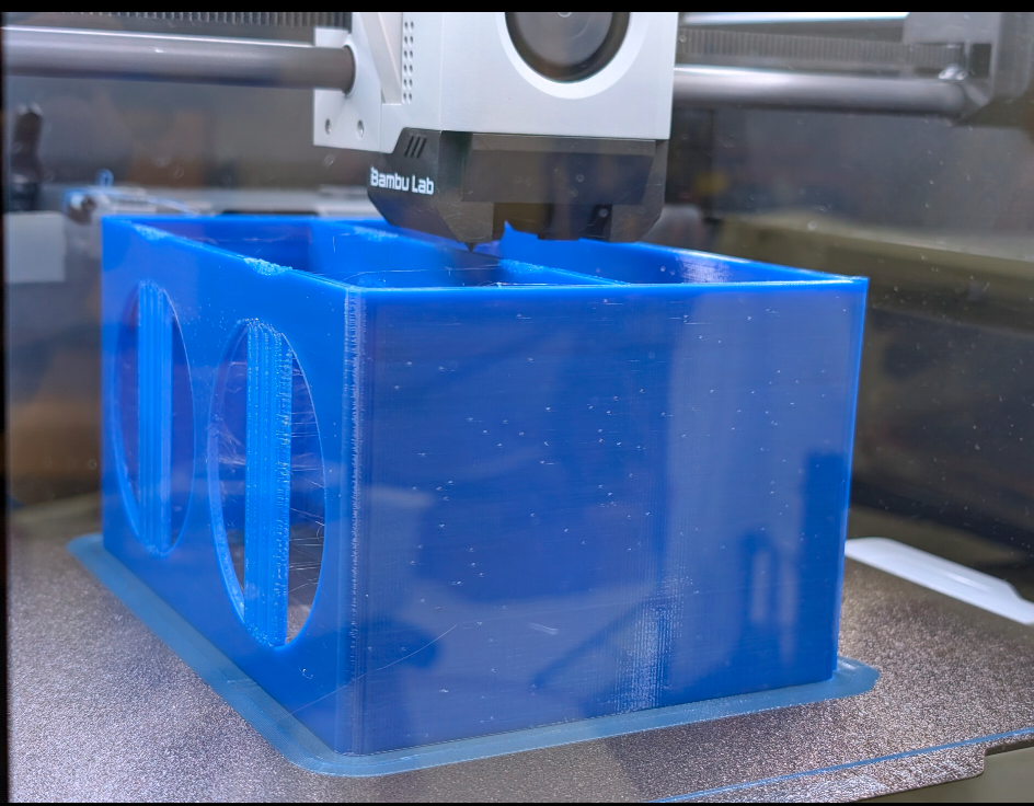

Currently printing a rack for securely holding 4 x 500 mL PET bottles in the warm water bath.
Just out of curiosity - why use so much material for something that only acts as a spacer? I imagine that takes ages to print, but you could achieve the same functionality with about 80% less material and thus a far quicker print job.
Indeed, it is 270 g of PETG. I was looking for a hex patterned side wall model that was already designed that was also parametric and couldn't find one. This model was interesting. It was a web-modifiable file that I believe was based on OpenSCAD. Other than the fact that I would have preferred a hex side wall, I liked the design enough and valued my time in Fusion more than I valued the extra 100 g of PETG that I would have saved... I don't mind that it'll be more stout with the solids walls, perhaps it'll last longer that way. Didn't really care about print time - I check in with the networked camera from time to time, so I was happily doing something else.
Ah I see; I always just fire up Fusion, make a shape and then if I feel it's too much material, take away stuff by making holes in it, LOL!
