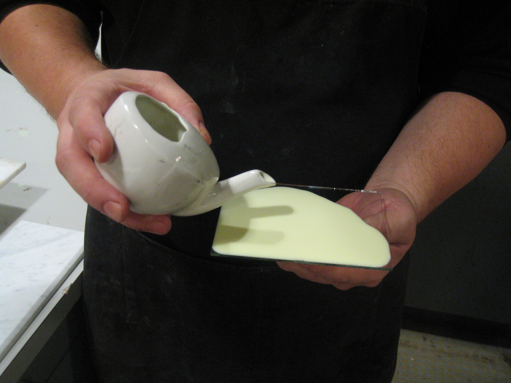

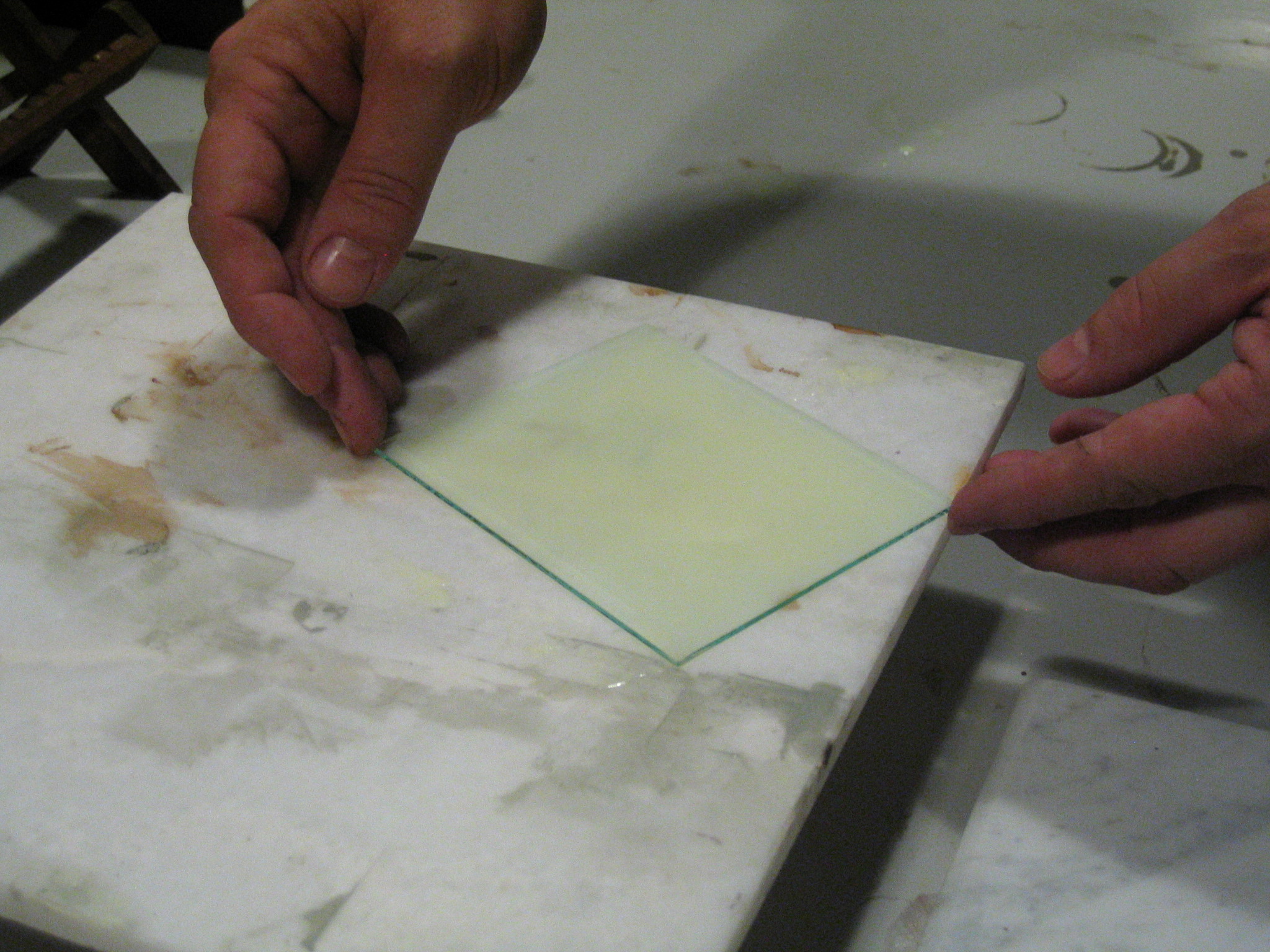

Mark Osterman uses a teapot to this day to coat plates. I still cannot do it his way though. I end up with emulsion dripping off my elbow.

The correct kind of "teapot" has a long crook-neck spout attached near the bottom of the flask, not
the top, so that any foam or bubbles in the emulsion or glop floats at the top, while the fluid itself
comes from the bottom. Not too long ago I noted a stainless mfg which still offers one of these,
what for I really don't know ... certainly not tea! We do have tea parties in this country, but they
generally involve cracked pots.

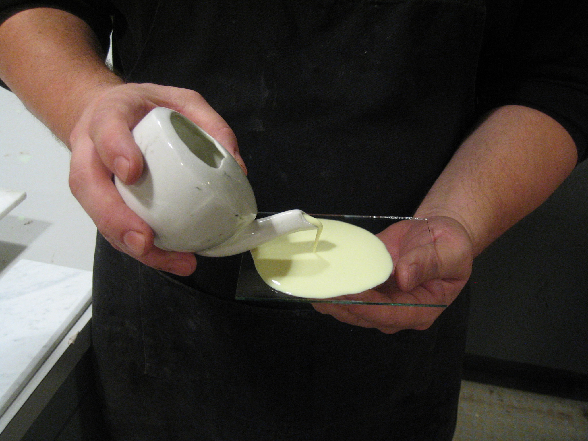

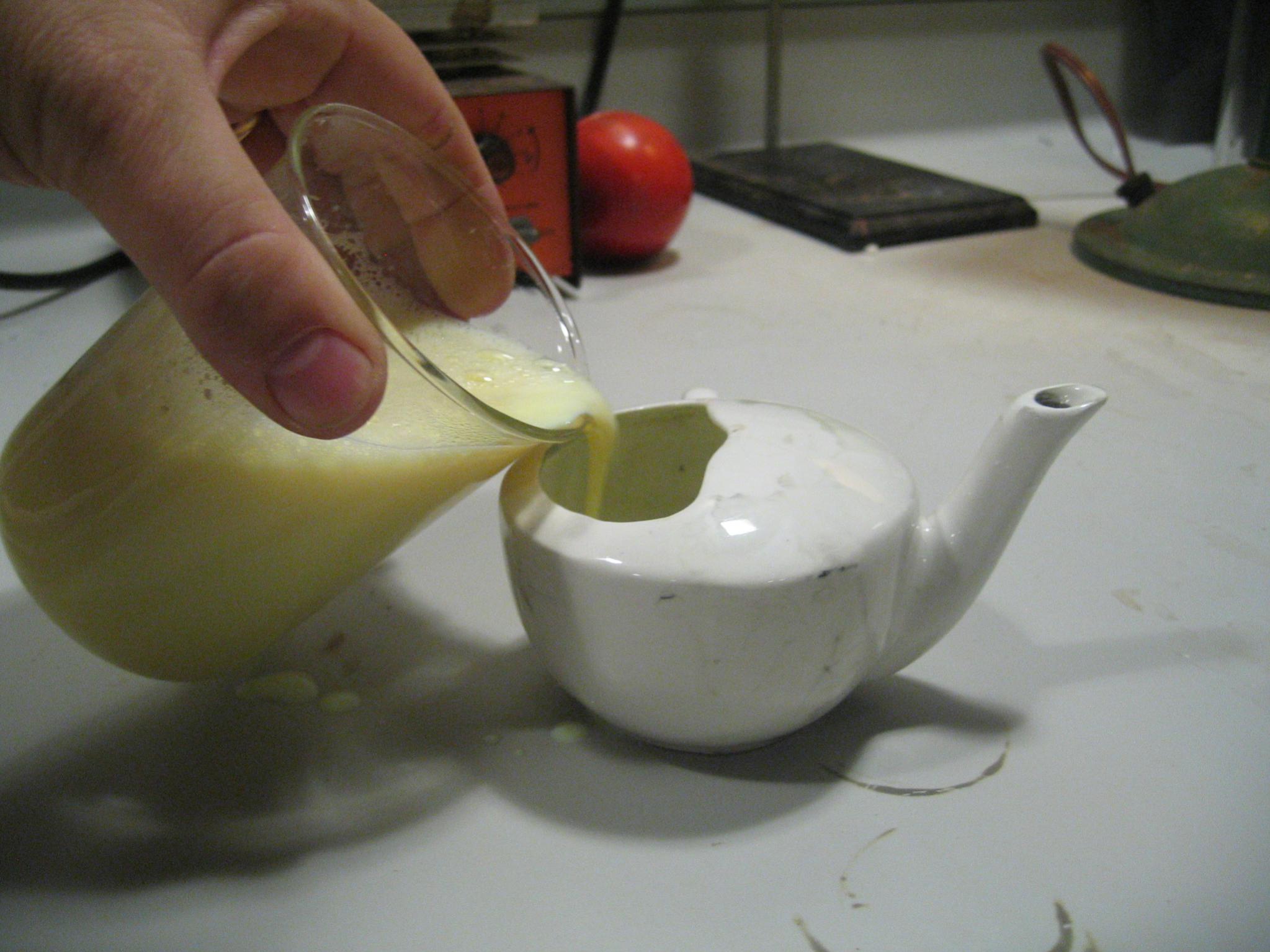

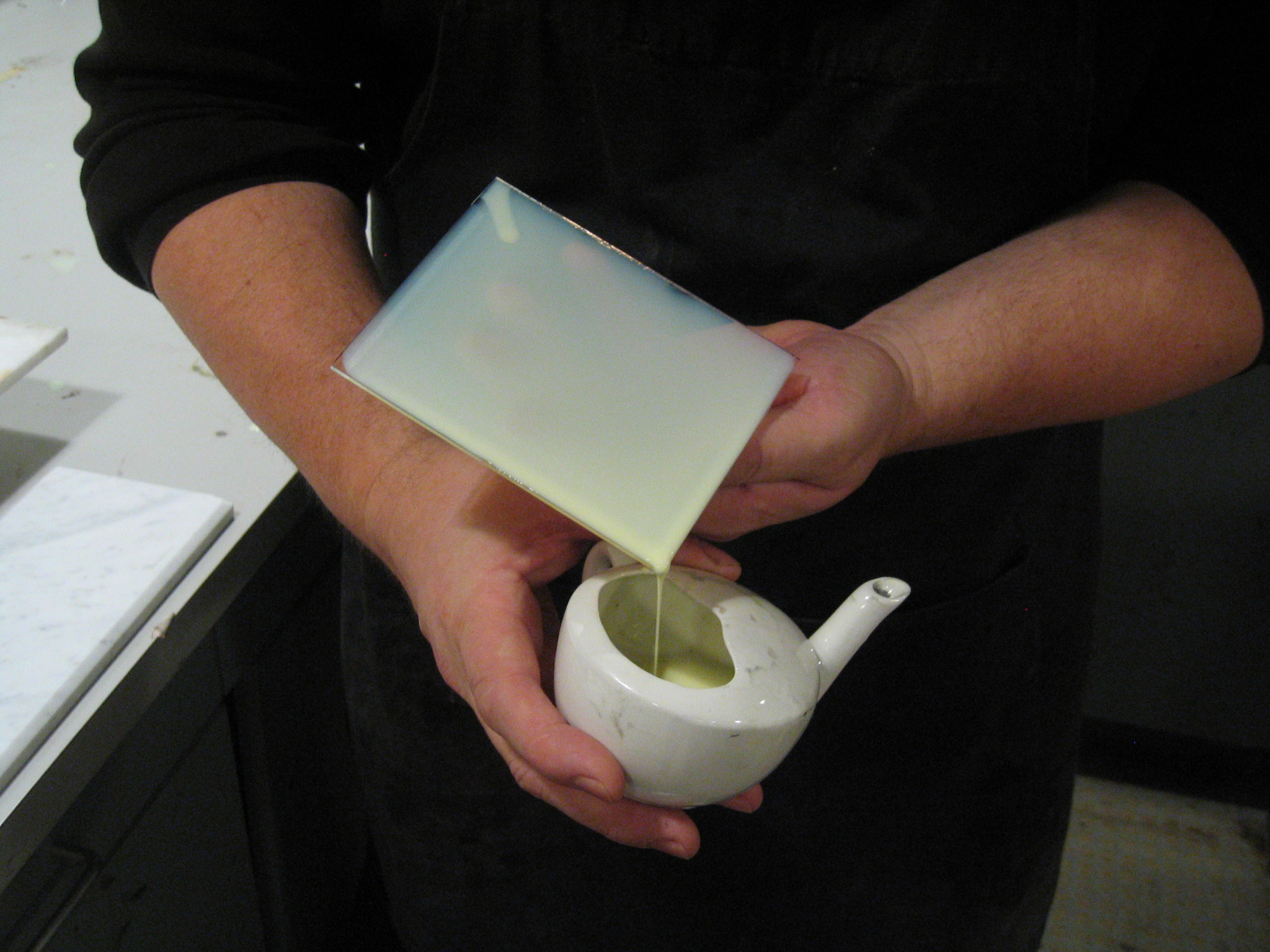

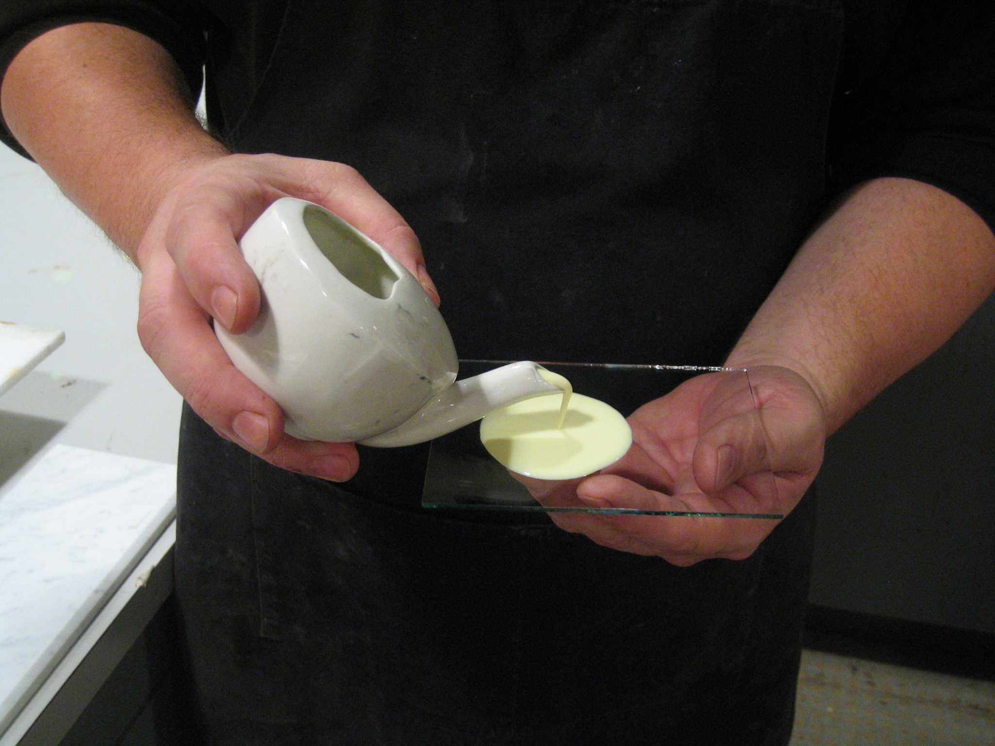

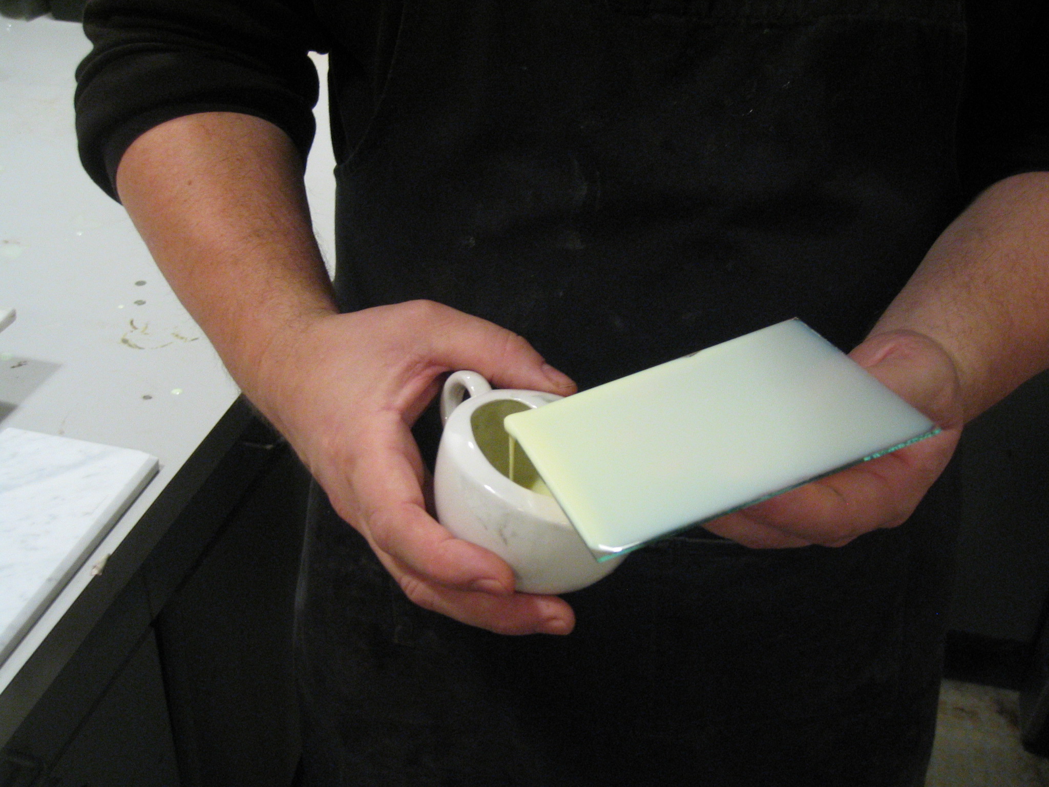

Now, for those interested, here is the sequence as supplied by Mark. Remember that pouring from opposite corners, as shown, is a required step if you wish good coatings.
PE
