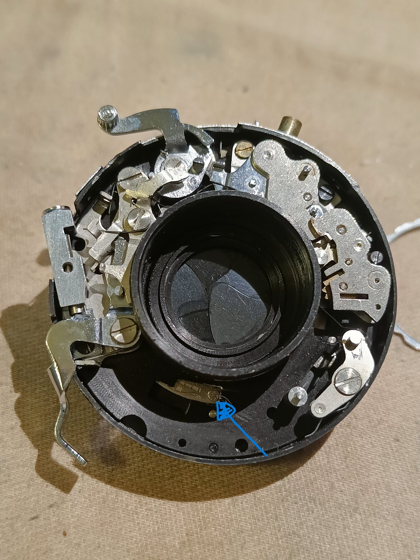

I have a Kodak 66 Model III with a Velio shutter. The camera is in good condition but the shutter does not fire. The shutter lever is locked and I do not want to force it. The shutter is free from oil and if I move the shutter mechanism manually, it moves freely. I can not figure out why the shutter lever is locked. The speed escapement moves freely. Anyone here have experience of working on the Velio shutter?

I am no expert, but looking at the photo, I suspect your problem might be with the circled spring. The upper portion of the spring does not appear to be in a position to be captured and exert force, in whatever manner is supposed to exert.
Carefully examine the area around this spring and see if it was not installed upside down. The upper portion of the spring appears to have an end facing upward. Is there the chance it should be facing downward and engaged in a slot or hole that provides downward force against the other end?
Thank you for your message. I did not notice that spring. I move it back to the little notch where it should be I think. It is still the same. Thank you

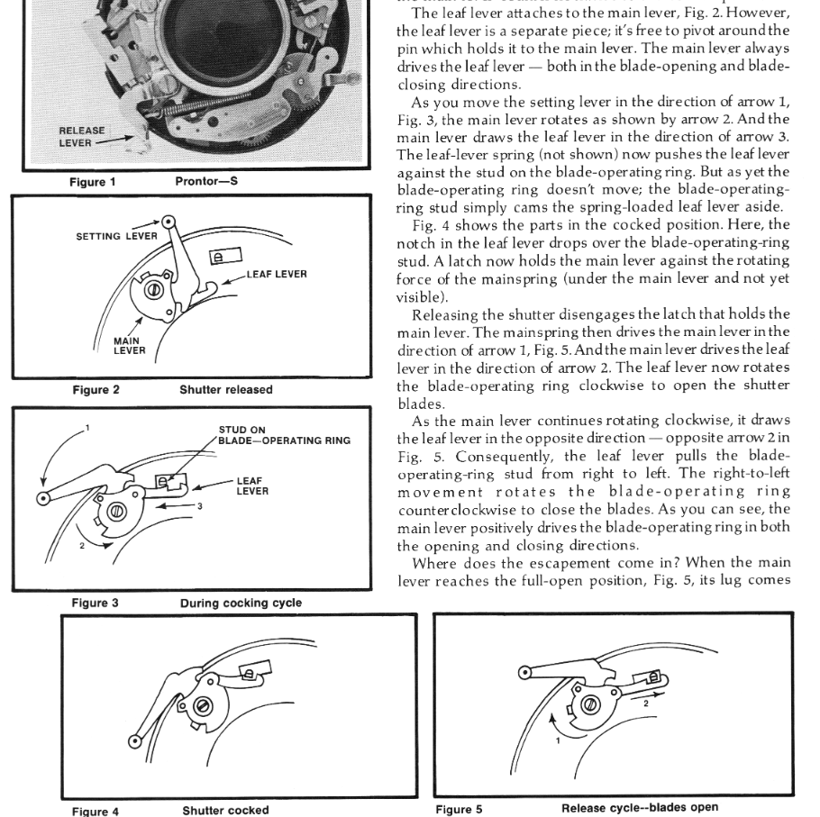

It looks like the shutter is cocked but the release lever remains locked? You can try to manually push the lever that blocks the release and see what happens. There is a nice NatCam service manual for this shutter

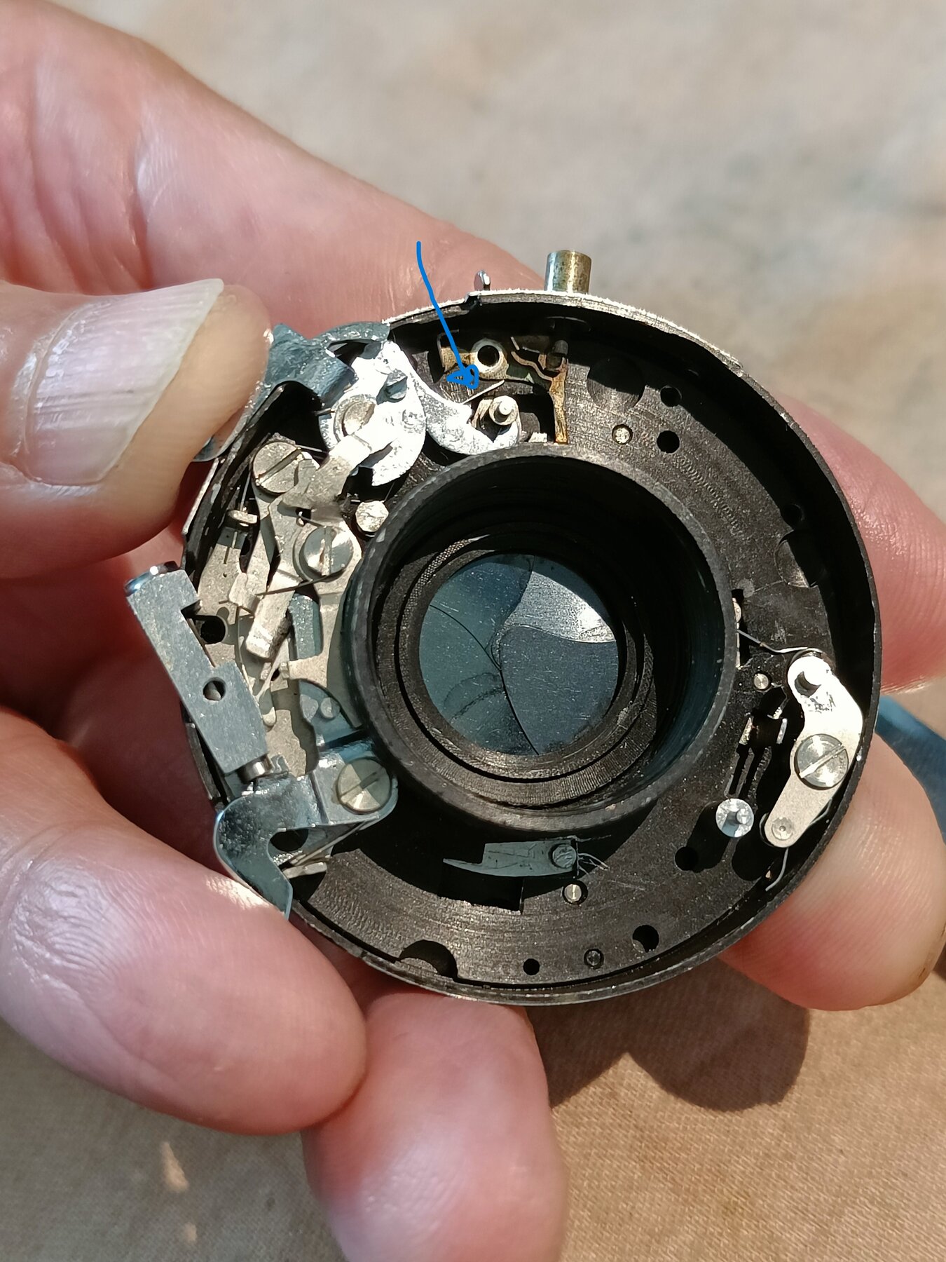

I am able to open the shutter by moving this. It opens and closes freely doing this.
If it moves freely, that means the main latch to the right of the main spring/cocking lever mechanism is not engaged. Which makes sense because the cocking lever itself should be closer to the body if fully cocked.
You can pull the escapement out and see this better.
@Dan Daniel is correct, the leaf lever on the cocking lever is loose, it should catch on a stud similar to the one you were manually actuating. It has a tiny spring that should push it away from the lens tube; it may have unhooked.
Thanks all, I will try to take the escapement out to see if the spring is unhooked.
You are correct @OAPOli. There is a spring out of place. After removing the escapement, I saw a spring out of position. I moved it back to where it should be and the leaf lever does what it should do.

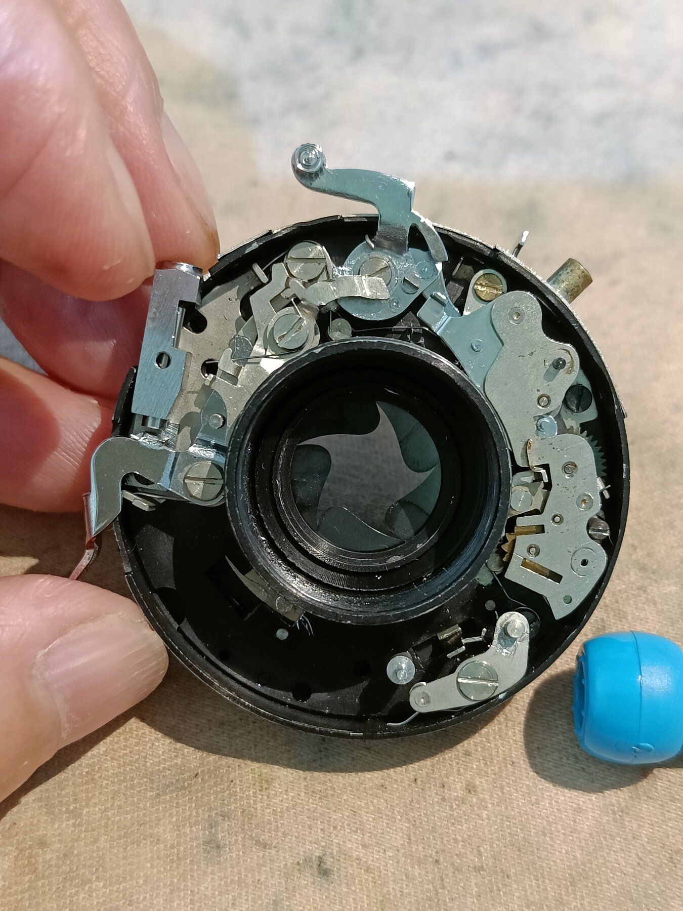

However, the cocking lever does not latch. It just activate the shutter as soon as I releases it. I think I may have to take a careful look at that side of the shutter.

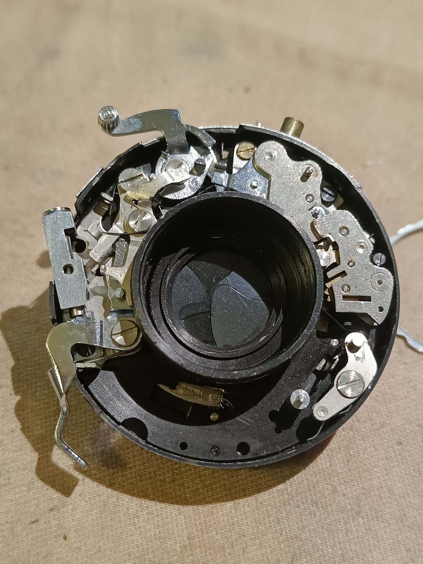

I found a loose spring near the release level after taking some of the levels off. Now the shutter lever is latching and shutter is actually working as it should. There is one problem though. When latched, the shutter is partially opened. Not sure what the problem is. I feel I am almost there.

It might be that the shutter blades or the shutter blade ring or the escapement is not really clean, causing the shutter to jam.
Ok, first shot showing latch lever and blades closed. On the main cocking circle, there is a notch at about 6:30 o'clock. Something is supposed to go into that notch to hold the cocking lever (and latch thing) in position so the blades stay closed. Then when the shutter release is pressed, that tab pulls away and the shutter should fire.
Last time I worked on one of these, mentioned above, someone had forced the shutter hard enough to bend that tab over flat.
First, puit the speed cam back and confirm B tab position. Then find that tab and work backwards to the shutter release lever.
