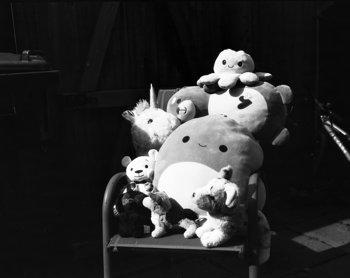

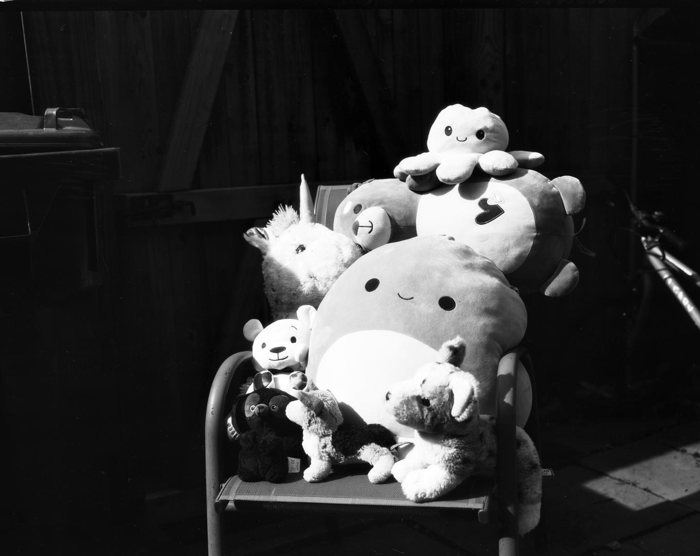

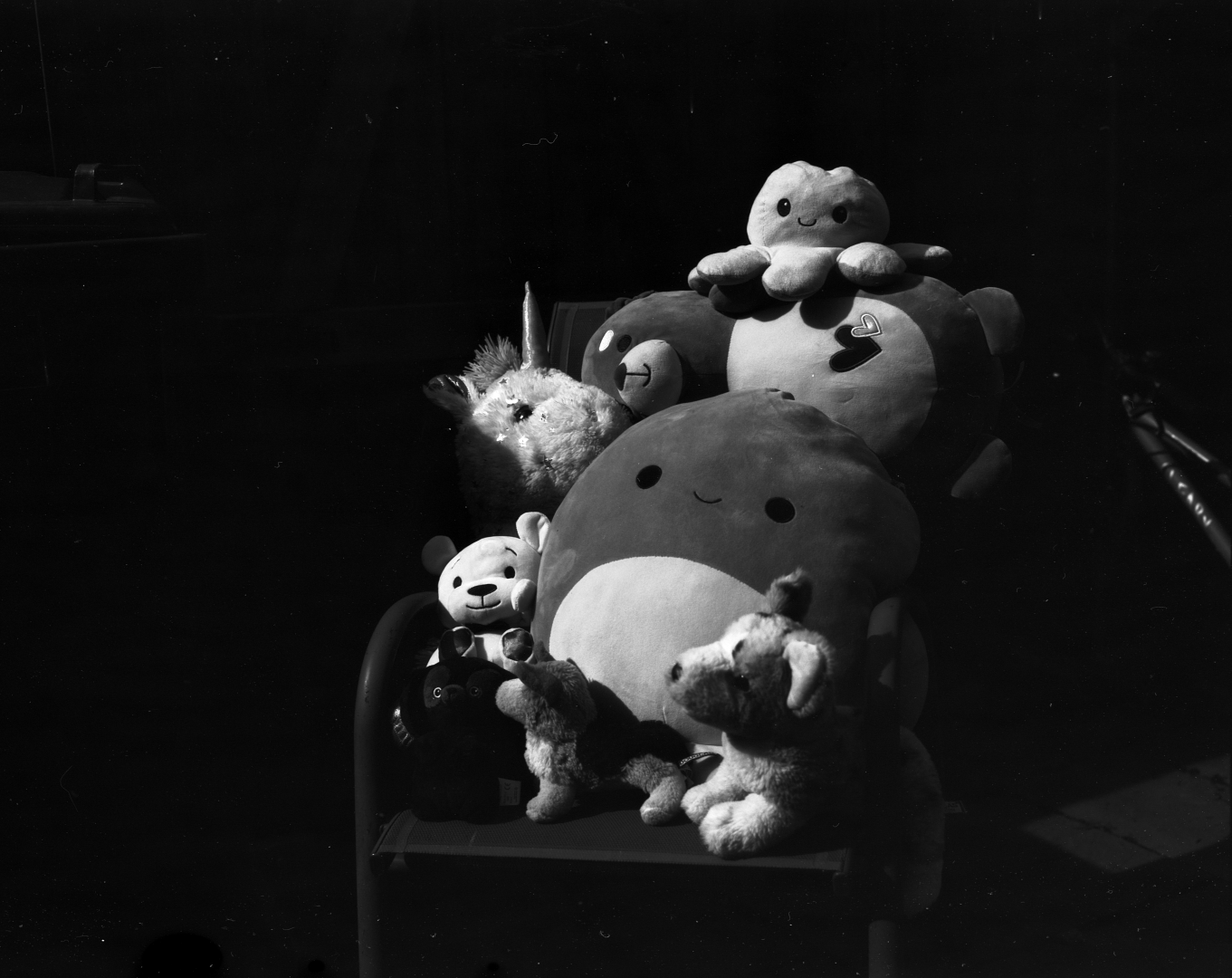

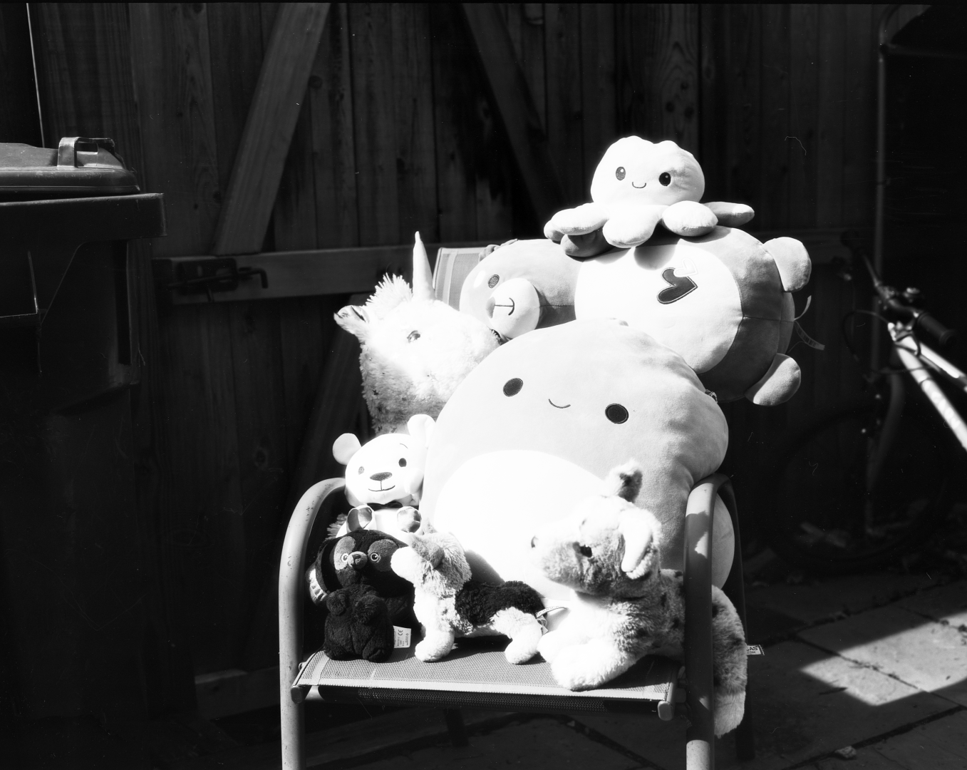

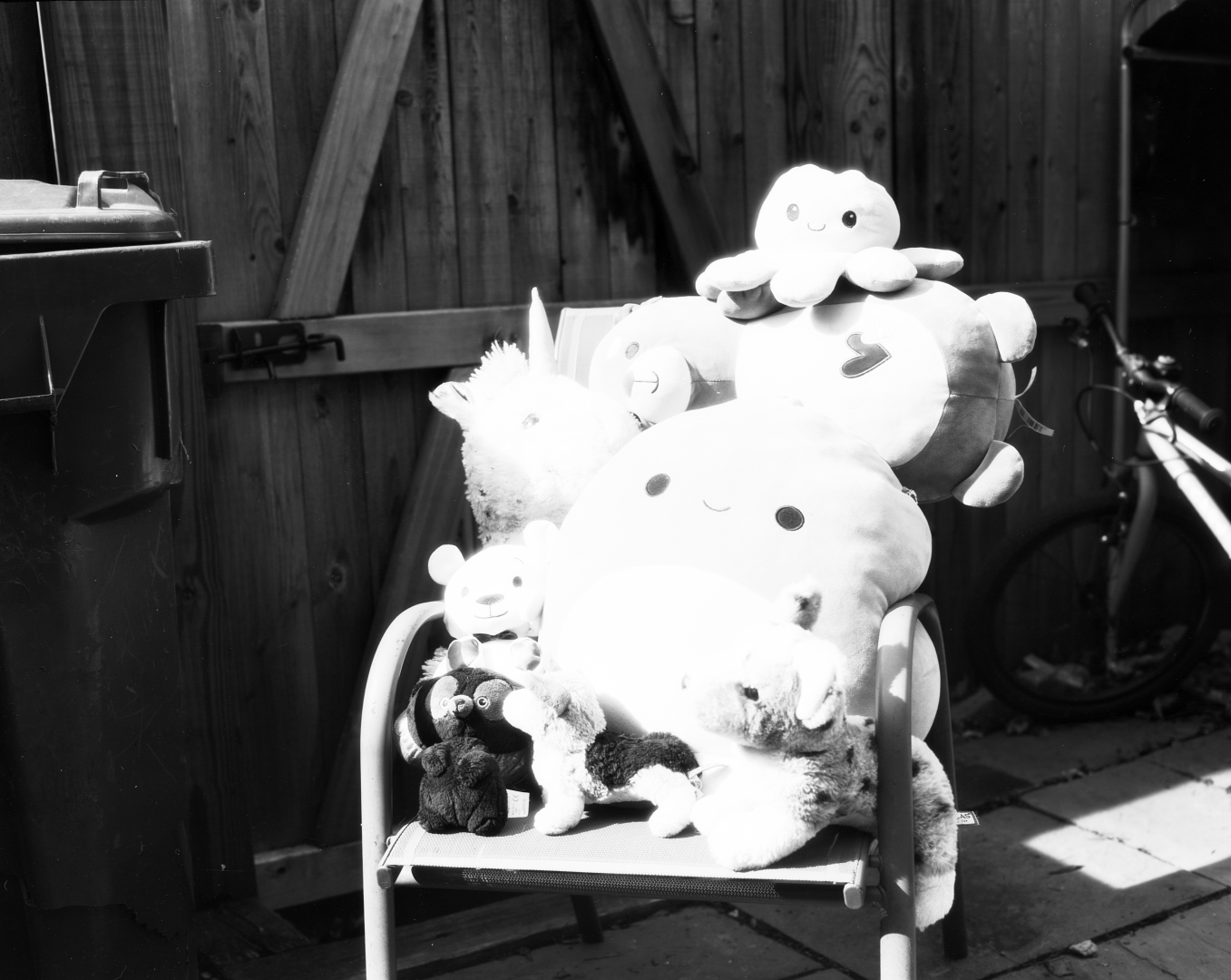

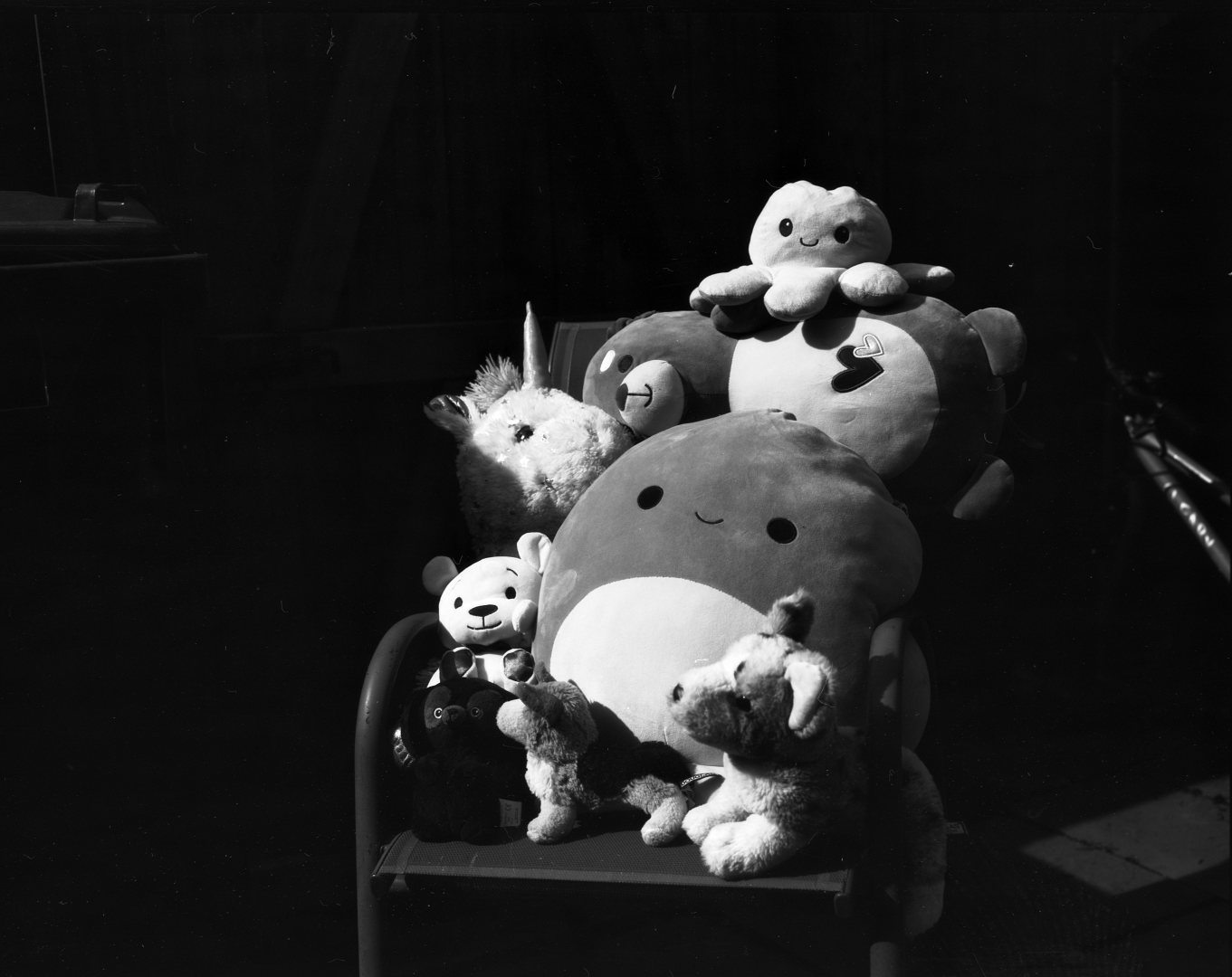

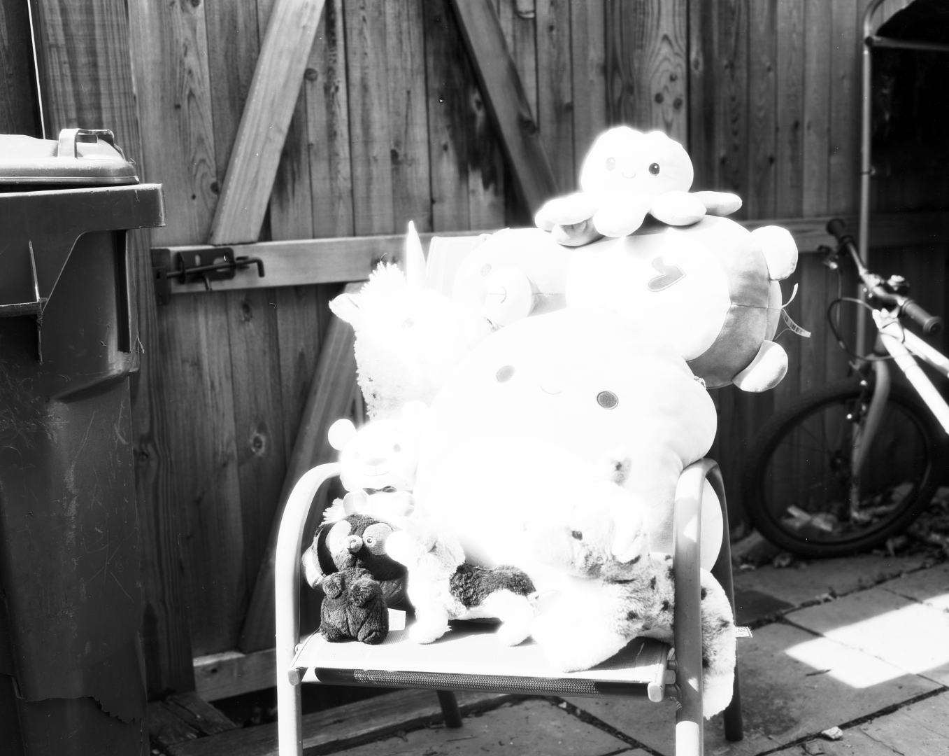

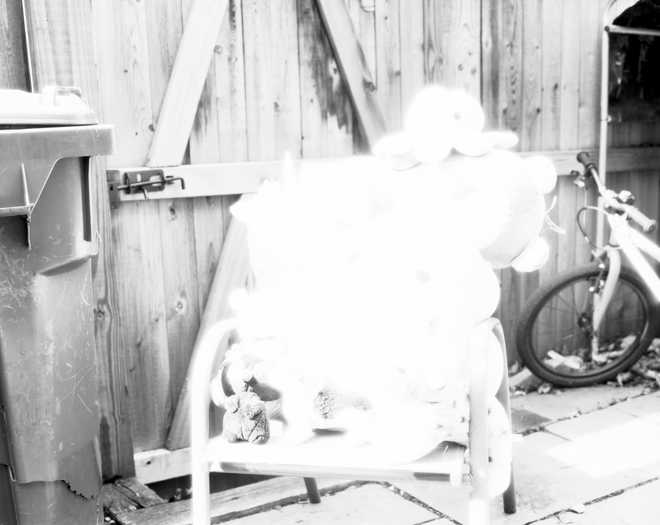

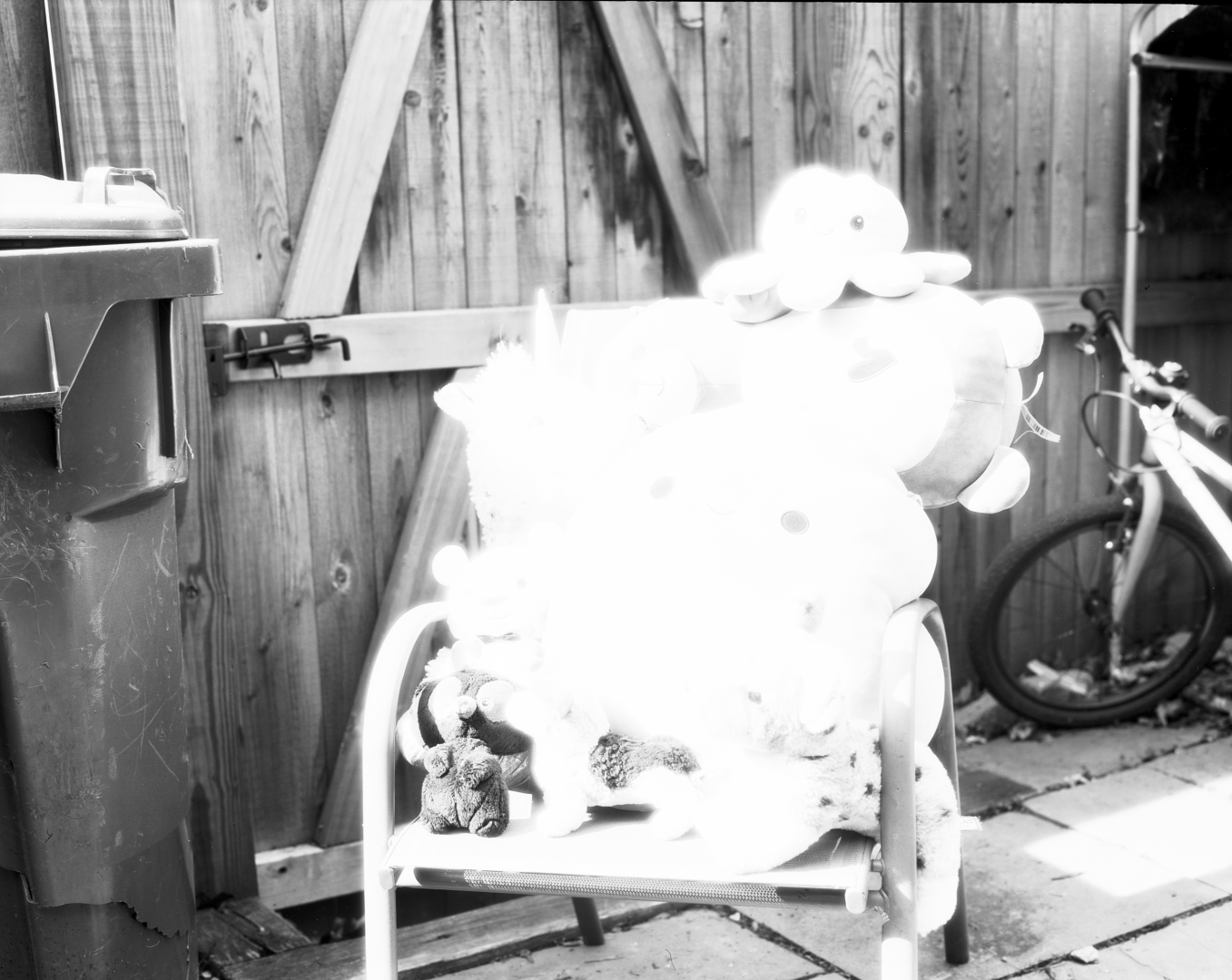

Unsure of where to start, I did an ISO bracketing test from ISO 25 down to ISO 0.12, using my children's stuffed animals positioned in extremely bright light as subject matter. I shot on my RZ67 Pro II, 90mm lens at f/8, using a tripod and mirror-up cable release. I developed the film in Xtol 1+7 for 2 hours stand development.
For the sake of consistency, I made no adjustments to the SilverFast settings when scanning these negatives using my Epson V600, so I am sure each frame could be improved in different ways. Pardon the dust on the negatives as well. Since this was a test, I did not bother to clean them up.
The film is microscopically sharp but extraordinarily slow; it also has poor latitude. But I am quite pleasantly surprised with the results from this first test roll, and it seems useful in the ISO 3–12 range.

ISO 25
ISO 12
ISO 6
ISO 5
ISO 3
ISO 2
ISO 1
ISO .5
ISO .25
ISO .12

Thanks for sharing your very interesting experiment.
If I can make a suggestion, it would be this:
Try doing some tests with more even and diffused and moderately directional light such as a scene illuminated by high overcast sky, and no direct sunlight. Include in the scene something with a more recognizable mid-tone and range of tones - like a Macbeth Colour Checker or one of the Kodak tools that provide a range of test densities. Use those results for your evaluations.

Thanks for the suggestions. I will definitely shoot the next test roll under more even lighting conditions. I'll also see about getting a color checker next month when I have a fresh photo budget.
