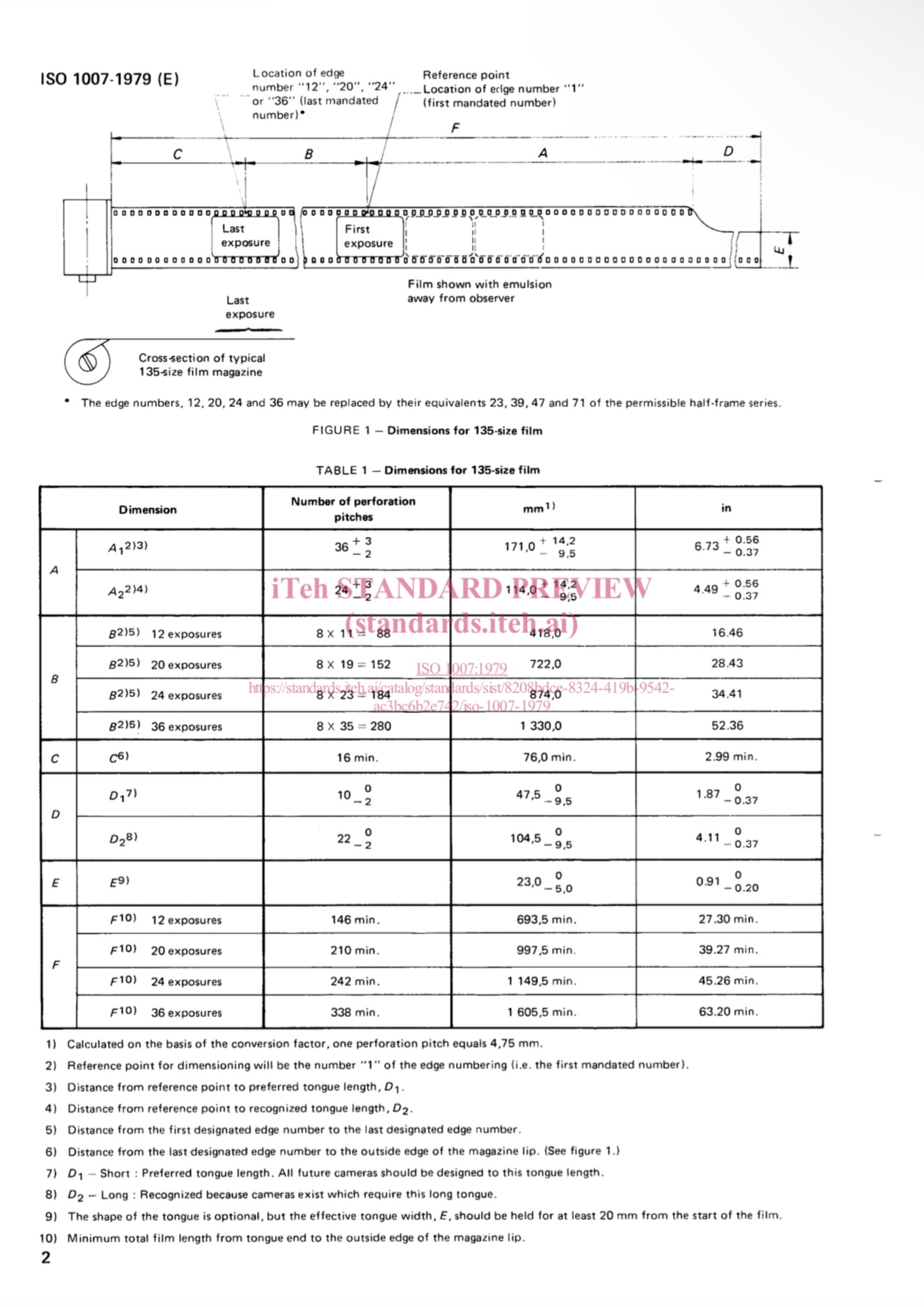

There are no splices in any rolls of 35mm film, it’s all one strip. no opaque leader is attached to the front. The only exeptions to this may be for extremely rare film that you don’t want to waste, or film prone to light piping. But these are not common situations, and I don’t know anyone who actually attaches bits of opaque leader to 35mm films even in those situations.
The little cutout at the end of the film is nothing special, I’ve seen people just cut the film 45° and it will work just fine.
I have attached the relevant ISO standard so that you can see what I am referring to.

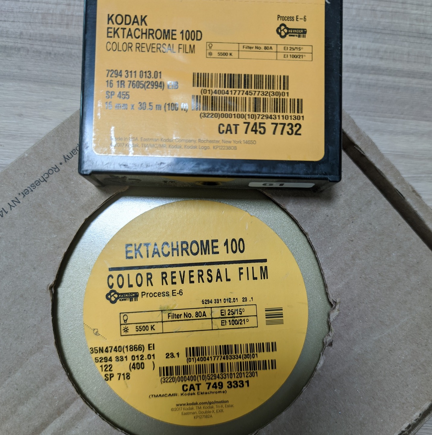

Talking about this - a picture of my jewelry :smile:
