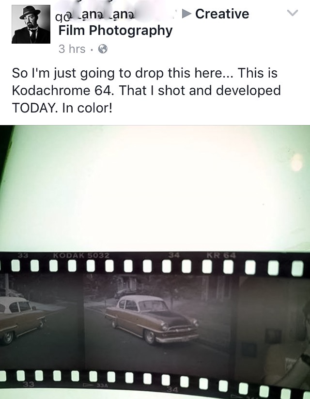

So this happened today in a Facebook group..
I blurred the name so as not to violate any privacy rules but the group is open for anyone to join. He says it's a very difficult process but basically identical to Kodak's; just using alternate chemicals.

This is a surprise 0_O. What chemicals were exactly used in the k14 process?
If you search this forum PE has posted extensive documentation, a link to the patent and even info on how to use c41 color Dev mixed with the color dyes as the developer.
Impossible no, very complex yes. The colors on the above image seem quite off, but nice work.
True. The colors may be due to the age of the film or the fact that the process hasn't been honed 100% yet. He says he'll be writing up documentation on it soon.
Nice! I'm curious to see how he did it, in particular the two re-exposures if he did a whole film.
EDIT: He is actually using the Rockland toner kit! :smile:
For those of us who will never be on FaceHook, I hope he describes his equipment and procedure on a web site.
Without the original couplers the image stability will be bad.
They were optimized for a property called "glass transition temperature" which imparts a lot of the reported Kodachrome stability. The other part is due to the color developing agents. They are CD3, CD3 and CD6.

Looks like the gentleman that developed the Kodachrome has written a blog post about it. Apparently it's a two-tone process which now explains the colors. What's strange is that the image he posted on FB shows processed slides and in the article he uses sheet film.

Hey guys, I know this thread is a bit old but someone mentioned that it was here. I'm the person who was mentioned earlier who has developed Kodachrome. I've refined my process a LOT since the image that was posted farther up the thread, I'm now getting good color balance and pretty consistent results. The process is an absolute PITA, as many people have mentioned before but I'm pulling it off without any sort of special equipment. It's also somewhat expensive, as you can't really source the chemistry in small quantities.
I'm using couplers I'm sourcing from Sigma Aldrich, and instead of filters I'm using narrow band LED flashlights for re-exposures. I'm happy to answer any questions on my process, and I've attached two NEWER images, one shot and processed yesterday, and another from a studio session a couple weeks ago.
Both images are 35mm Kodachrome 64.
