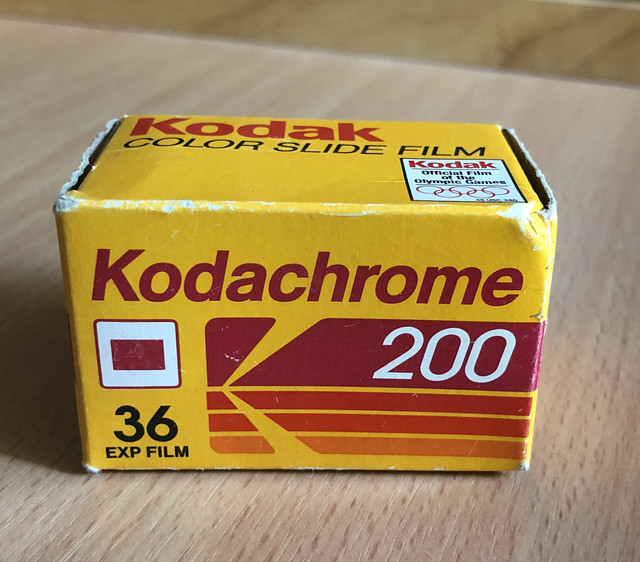

Speaking of Kodachrome, I discovered this in a bag of expired film someone recently gave me. Expired 1/98. I'm not sure what to do with it. Can it be x-pro'd?
Only as B&W really. I'm working on K14 colour processing, but its a long winded and expensive process by hand.
