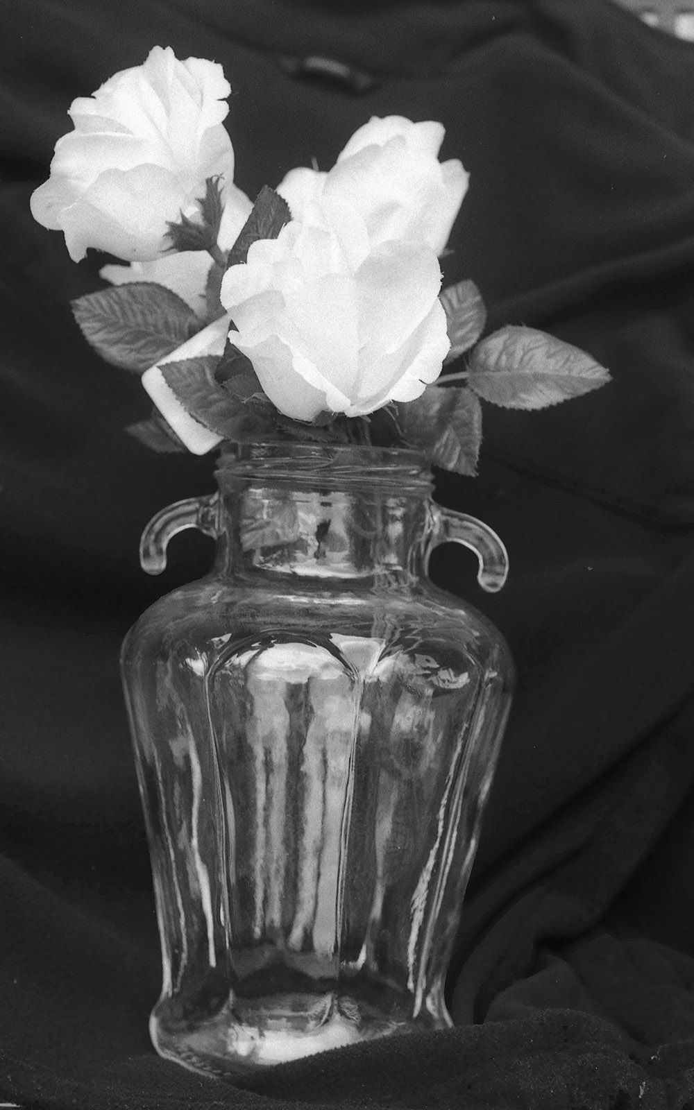

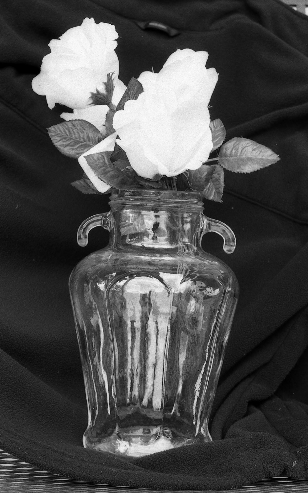

Posting two images from each lens
Hey guys,
which one do you think has clarity?
Todd
ToddB
Jul 10, 2012
1,134
The one on the left is from vintage 50mm Nikkor 1.4 and the other is the stock 50mm 1.8 lens that came with FE kit.
Todd

Hey guys,
Todd
The photo on the left evidences higher contrast.
I would say, however, that the plane of sharpest focus is different between the two.

I agree with him ^
slight difference in view too, so handheld?

Your second photo is front focused, so it's not fair to discuss the lens optics... as for the 50mm 1.4, it seems sharp to me, was your original post not about it's sharpness... perhaps you should photograph at 1.4 with and without the polarizer.
