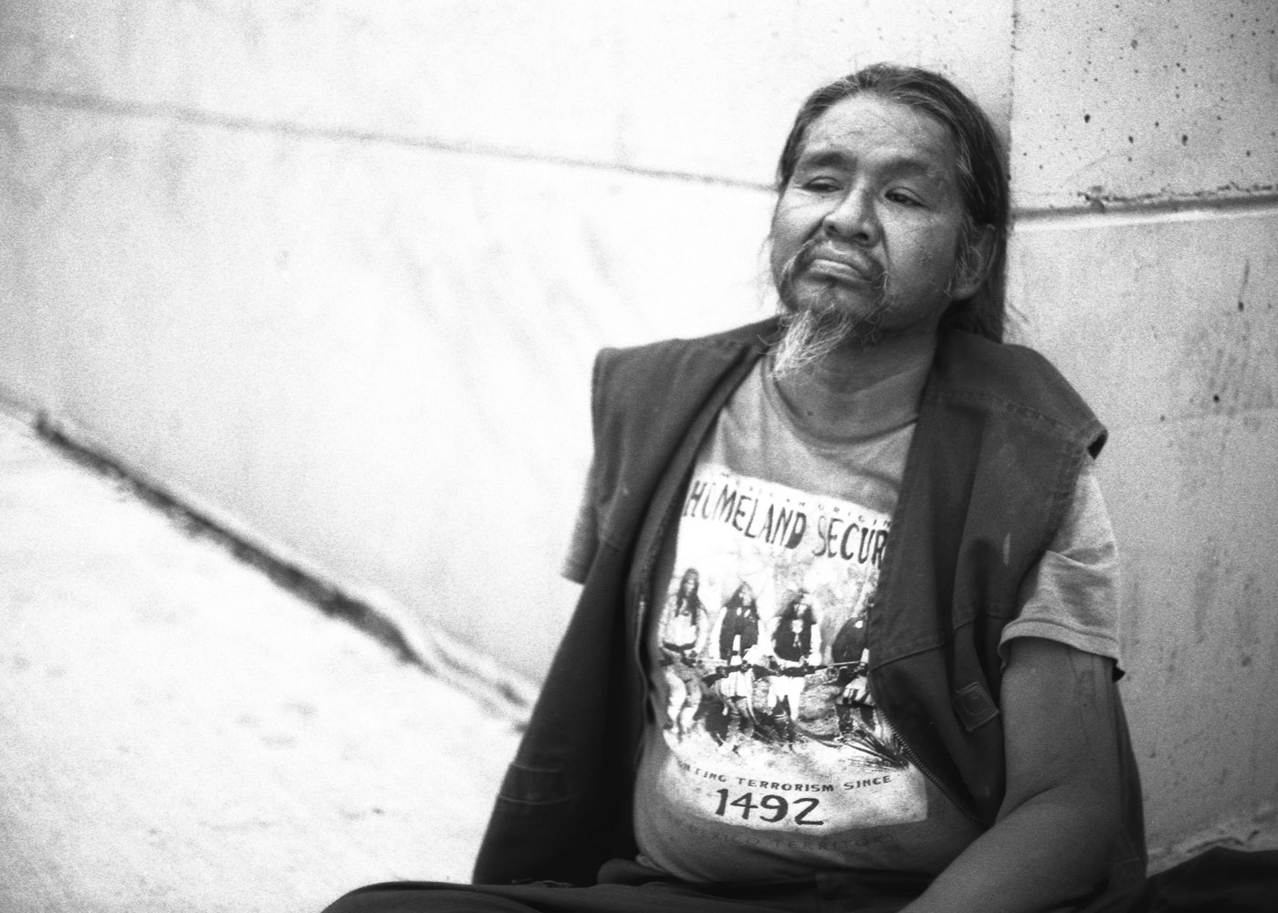

Ok.. Here is a sample pic of my shoot last weekend. To me it looks a little soft and grainy. I use delta 100 35mm 68 degrees @ 12min.
Todd

Is that a scan of a print, or a scan of a negative?
ToddB
Jul 10, 2012
1,134
Scan of negative..un-manipulated.
ToddB
MattKing
Apr 24, 2005
53,262
Delta, BC Canada
ToddB
To me, it looks like you have missed the focus slightly - the plane of sharpest focus is near his sleeve, not on his face.
And in order to try to eliminate any problems with the scanning, try re-scanning the negative after rotating it 180 degrees (don't turn it over, turn it around).
The "graininess" may be scanning artifacts. Rotation of the negative may change the appearance of the scanning artifacts.

I would agree the plain of focus is slightly off, definitely. However, I have no idea what film was used - but the grain isn't too excessive. It does look somewhat overdeveloped though.
Lamar
Dec 22, 2008
375
Georgia, USA
Yep, I've found my scanner is a bit soft at the frame edges and produces ghosts/double images in high contrast areas. I was blaming lenses at first but it didn't' take long to figure out the scanner optics were the source of my problems. I don't think the OP's problem is scanner related though. I think he is just going through a learning curve......
The lens is probably 1,000 times sharper than the scanner...

All three shots posted exhibit front focusing. Shooting at f/1.4 exacerbates this misalignment. Recall that the image you see in the viewfinder is reflected by the reflex mirror, flipped around by the pentaprism, then projected on a ground glass (with fresnel focusing aid) screen. That screen MUST be the same optical distance from the lens as the film plane, otherwise front focusing or back focusing will occur. The focusing screen needs to be realigned. I do this by removing the back and taping a ground glass to the film track and focusing on a sharp target 12 feet away to obtain a perfectly focused image on the ground glass with the shutter open, THEN I release the shutter and adjust the focusing screen until I see the same point of focus as the film plane sees. It takes a few tries to get it good and dialed in.
