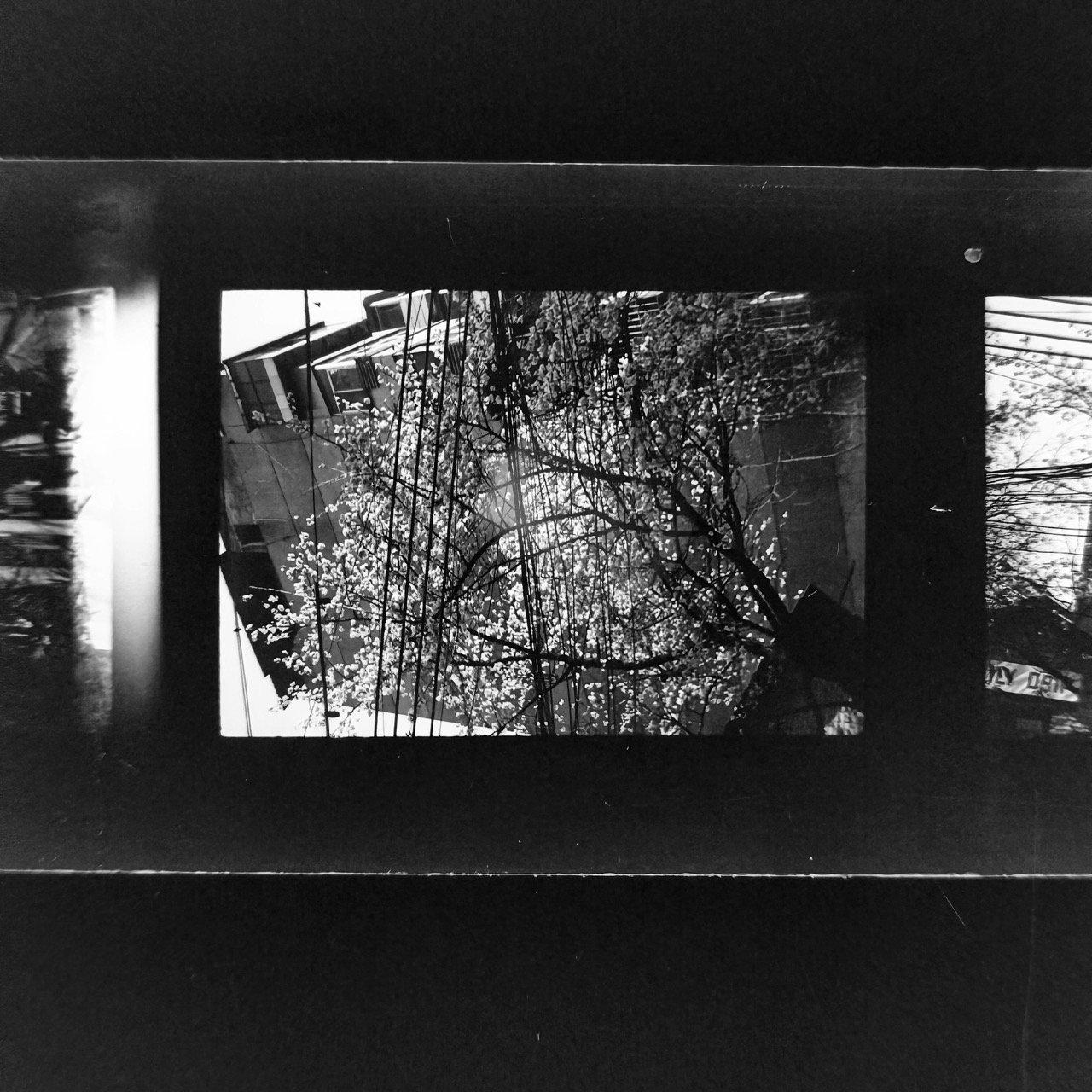

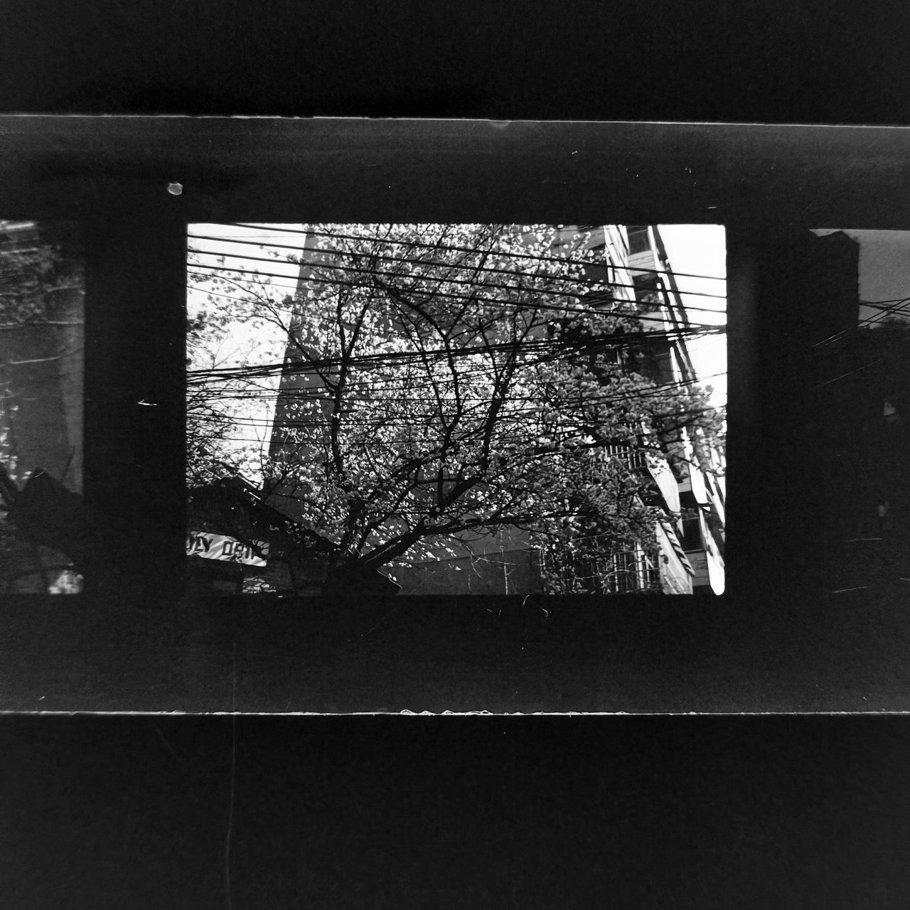

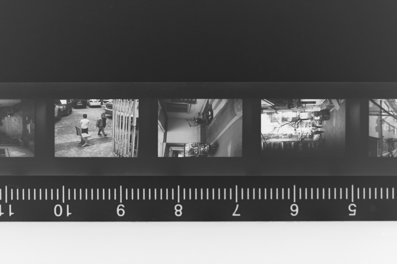

这些照片是我用柯达 ImageLink HD 拍的。它已经过期大约四年了。我仍然用 100 ISO 拍摄。我拍了以下照片。我对冲洗和拍摄经验不多,但我喜欢这些照片。另外,胶片底座是透明的。
These are the photos I got using Kodak ImageLink HD. It's been expired for about 4 years. I still took photos at 100 ISO. I got the following photos. I'm not very experienced in developing and shooting, but I like the photos I got. In addition, the film base is transparent.

View attachment 396211 View attachment 396212 View attachment 396213
What developer did you use?
