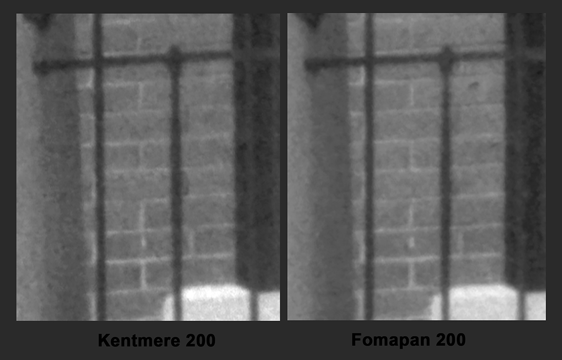

I wet scanned them. Kentmere still has better acutance, but they are so very close. Much closer than the scans using the holders, so @flavio81, you are on to something! For future comparisons, I'll be wet scanning. The Kentmere is still grainier... 🙂
I disagree here, because the film holders used cannot guarantee that each film will be focused at exactly the same point. So the differences could as well be attributed to focus error on the Foma 200 scan. In my view, the scan on F200 looks -to me-like focus error, not smoother grain.
Again i still think it is a good video, and useful too, just not on the grain&acutance part.
Well, as they say, we can agree to disagree.😉
But @Andrew O'Neill's follow-up in #28 is in favor of @flavio81's reading. Then again, I already said the same thing flavio suggested, so it's no surprise I agree to agree with him...
I still think that scanning this film on a higher-resolving setup, or enlarging these snippets onto B&W paper, may cast yet another light on the story.

Yes, I can agree now...........My reply was typed in after my MAC had sat idle and the browser not refreshed so I didn't see the wet scanning part. Dummy me! So, the whole problem with Foma 200, other than emulsion defects, is in the curl itself when it comes to scanning? I'm so used to glass carriers for scanning and wet printing that I automatically think everyone uses them to hold negatives flat. My fault! As for Foma 200 film? I actually like it if it weren't for the defects in the 120 format sizes emulsion. Once you learn how to expose and then to develop for highlight detail it has a very nice tonal scale and wet prints very nicely too.
Thanks and thanks for the re-test.
We all know Foma 200 is not really ISO 200 but a bit slower. K200 is probably true 200 speed, so OK if it's a bit grainier.
