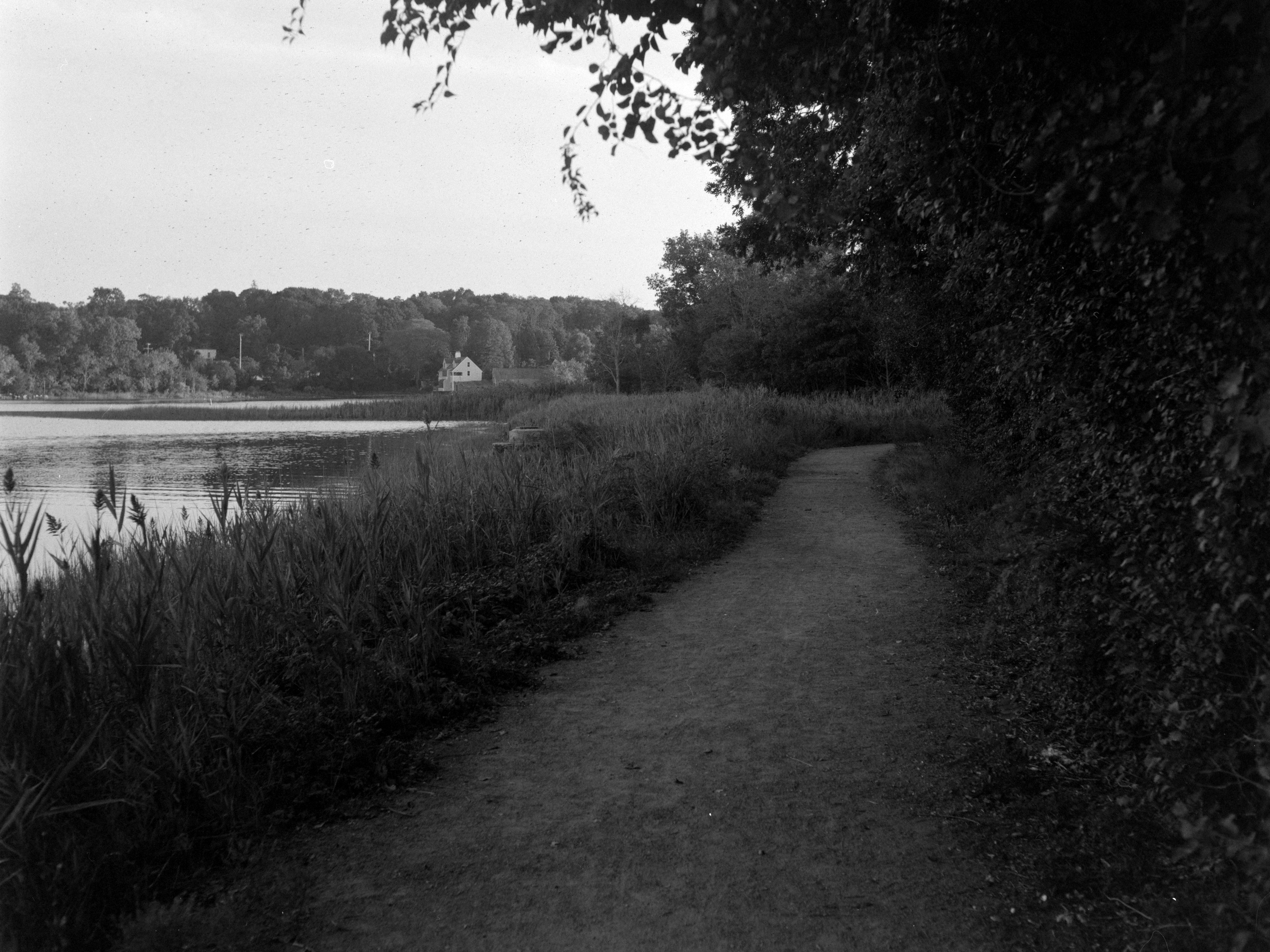

This is the other type of emulsion defect I get with fomapan 200. Not sure if that's holes in the emulsion or what, but they're little white spots in the negative which show up completely black when scanned.

This is the problem I've seen in my Foma 200 120 film negatives. My bulk roll of Foma 200 in 35mm doesn't have it. I haven't tried Foma 200 in sheet size so can't comment, but I haven't heard of problems with their sheet sizes.

Yeah, that's the issue I asked about. I also got that on 120, many other people have had the same experience. This defect does not occur on the sheet film or 135 formats.
