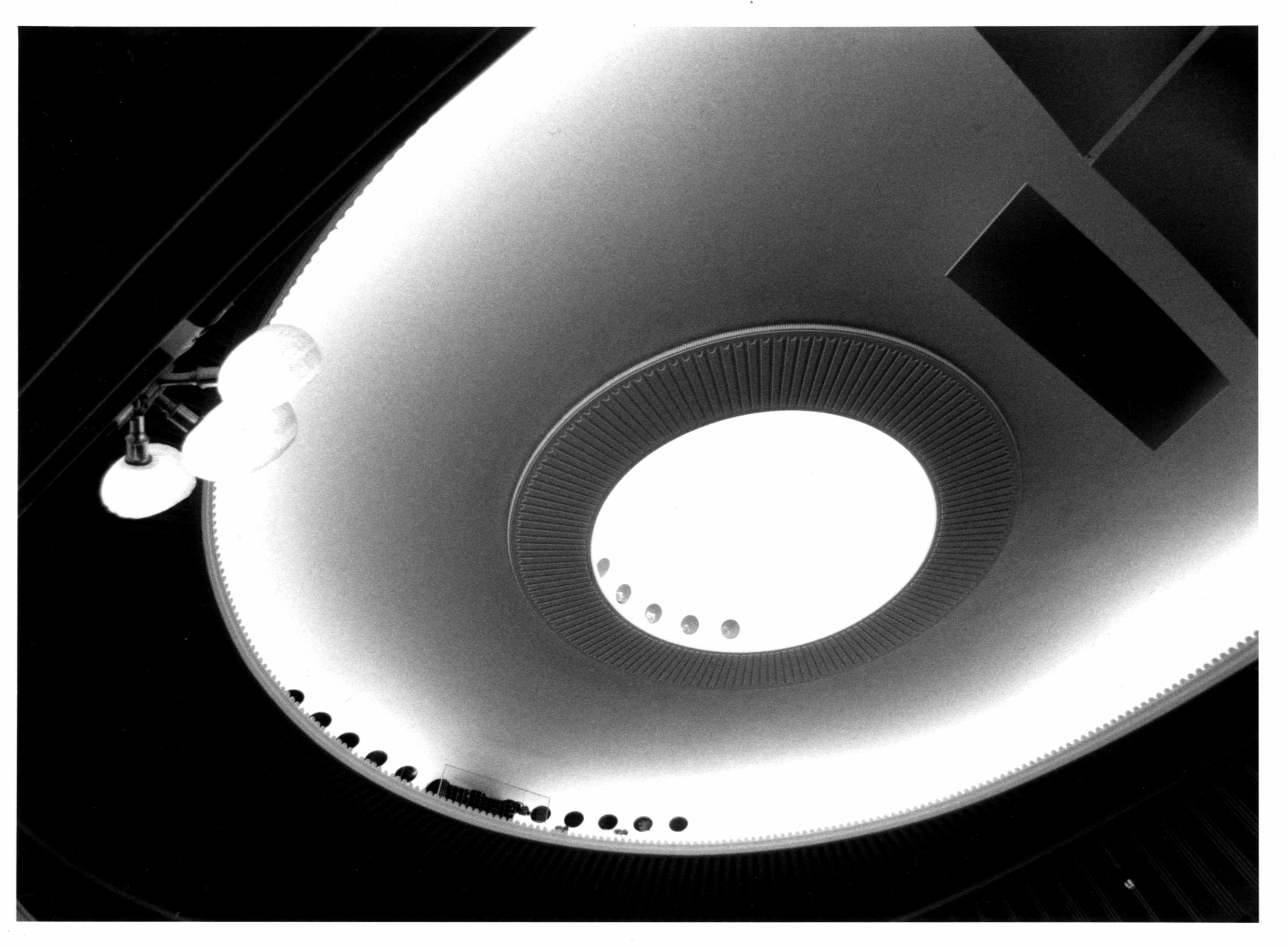

Kentmere 400 in XT-3 is not too grainy. Here is a sample.
Gallery of the Opera House in Düsseldorf, Germany.
Praktica MTL 5, Carl Zeiss Jena Flektogon 4/20 mm.
Kentmere 400, ISO 800, Adox XT-3, 1+1, 16 Min.
Silver Gelatine Print.
