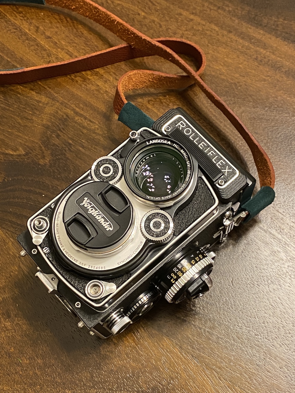

Yep, Rolleiflexes are nice cameras but their lens filters+cap situation is miserable. Here's what I did: I mounted two UV filters on both lenses, and I'm using a generic 39mm Voigtlander lens cap on the bottom lens only. I don't use the annoying Rolleiflex cap. This way the filter operation is the same as with any other camera.
I bought this kit, which includes two UV filters and a nice lens hood. These filters are coated. I also have a Heliopan filter on my 2.8F and I have not noticed any differences in flare.

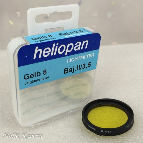

This is specifically why I asked about the Heliopan filters. I think they are stackable, so they have a Bay 2 front connector on them (at least based on the photos I have seen). Here's a photo from an Ebay vendor for a middle yellow filter:
If that is the case, then it should be possible to use a pair to have the original caps work.

AH, hadn't known that the Heliopan filters have a bayonet on the front. I'll have to keep an eye for this.
