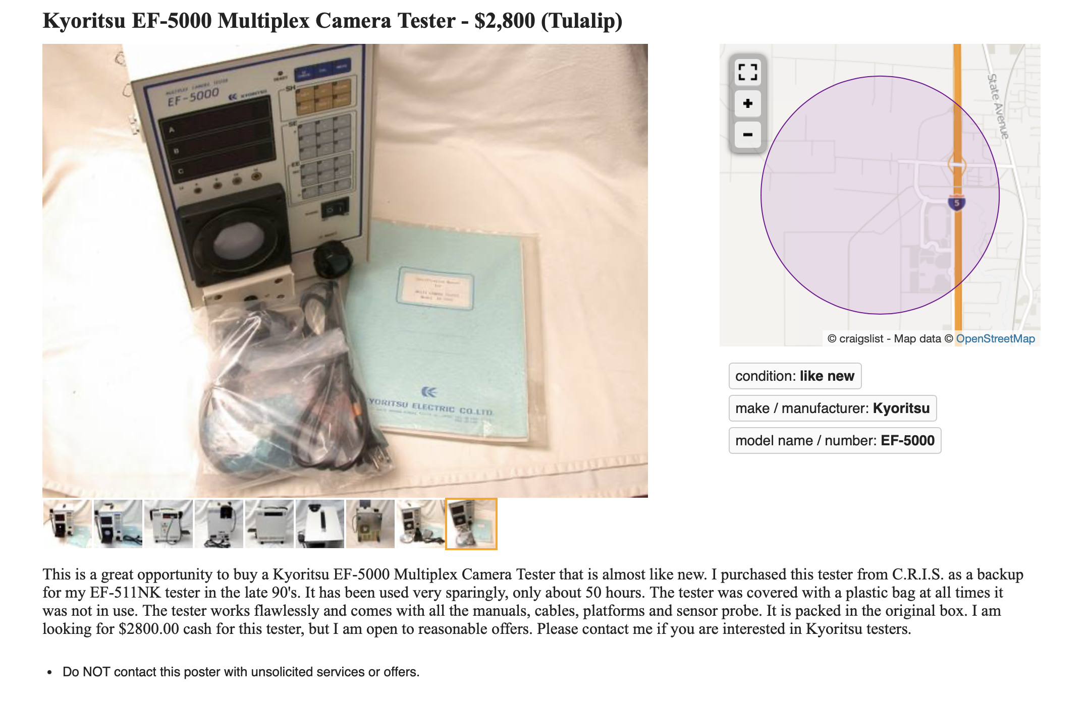

This is on Craigslist. Defiantly worth $2,800! I'd buy it if it were closer.

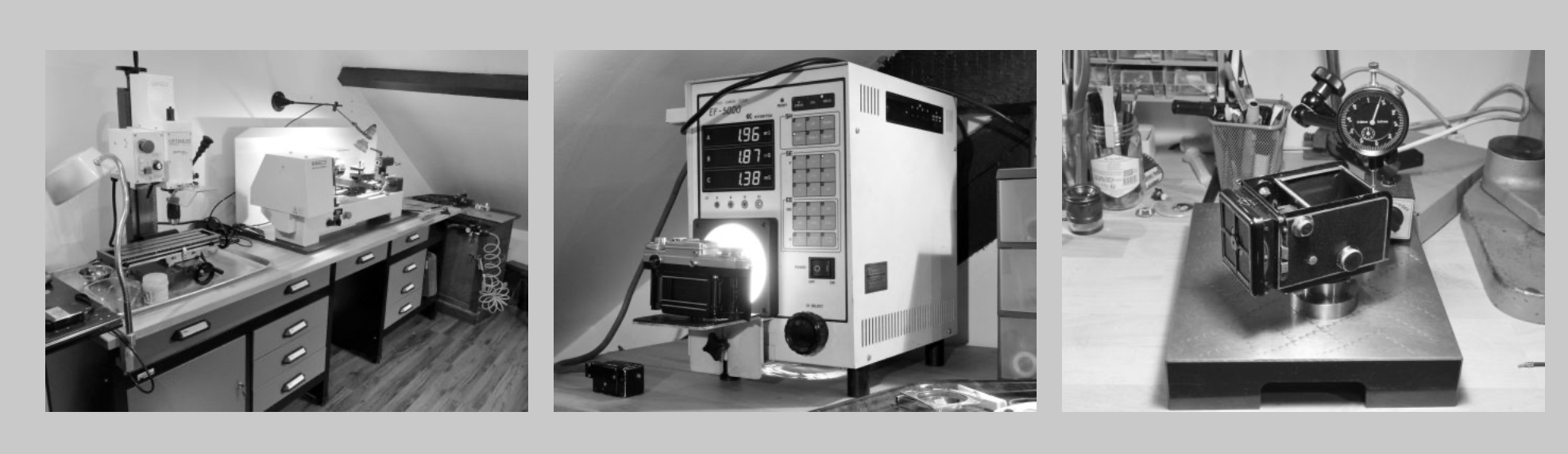

This was posted on Large Format forum. A new shop for film camera repair opened in France at the start of this year. They have some nice equipment!
I used Maël's services some years ago, before he went to another adventure, and trust him 100%. Easy to deal with, good communicator, good service...
update: I sent him a lens last week, got a call today to discuss the work to be done and the cost estimates... quite cool!
