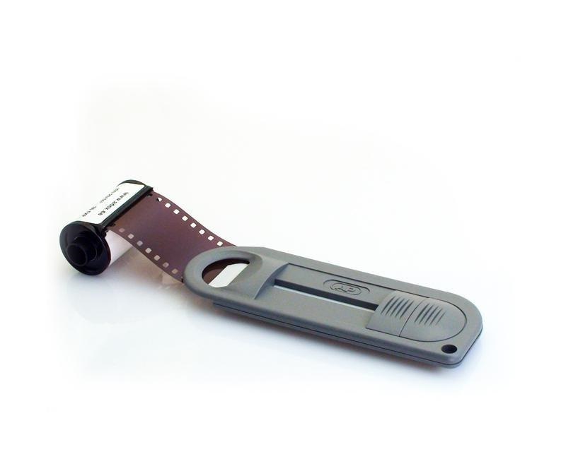

Just from the photos I assume:
Kaiser:
2 plastic tongues
1 movable
1 with barbs
AP:
2 steel tongues
both movable
1 short plastic tongue
AgX
Apr 5, 2007
29,972
Germany
I don't use it very often these days but for over 30 yrs I've had a Hama Film picker. Easy to use and reliable.
The Hama one is the model I tried and failed. Maybe I should give it another run of attempts.
It is interesting to see how many technically different approaches were done. A topic for collectors...
Steve@f8
May 5, 2017
342
UK
Kaiser:
2 plastic tongues
1 movable
1 with barbs
AP:
2 steel tongues
both movable
Hi AgX
Based on what you’ve said, the AP has:
2 steel movable tongues
and
1 short plastic tongue (fixed or movable?)
That adds up to 3 tongues in total which doesn’t sound right looking at the picture of the device.
My misunderstanding, possibly, so asking if you could check the details.
Many thanks for your trouble.

Already far above in the thread I had it on models with 3 tongues.
There is at least one video on Youtube that confirms my statement on the AP model.
Steve@f8
May 5, 2017
342
UK
Thank you AgX
That’s the clearest and most helpful video I’ve seen. Order on its way.
