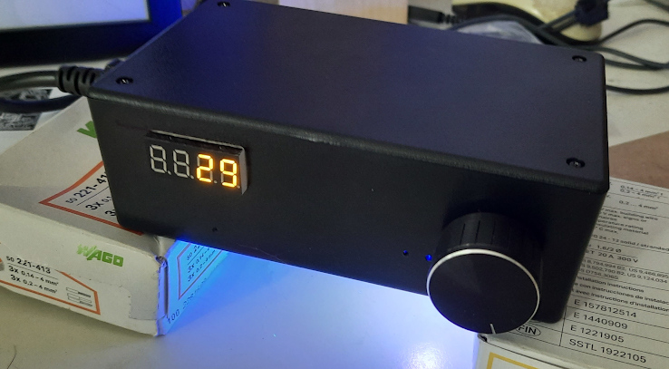

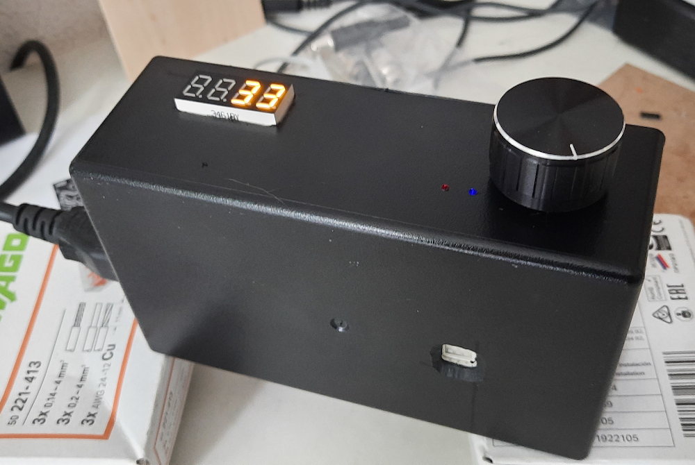

I already have a UV exposure unit made from UV tubes that I use for alt. process prints as well as PCB's. Because I was waiting for components for another project so I had some 'dead time', and I also had some parts in the parts bin that I thought I could put to good use, I did a quick and dirty min UV exposure box. It's essentially a 10W UV COB led with the necessary parts around it to make it work stand-alone. Its primary purpose is really to expose PCB's for my DIY projects, but it should also work fine for smallish alt-process prints; I think anything up to 5x7" would print within an acceptable amount of time.
Excuse the abysmal cameraphone pics. Just to get an impression of the finished contraption.
The main reason for making this is to see if the quasi-point source of a COB LED would give a noticeable resolution advantage over the large bank of UV-B tubes I've been using so far. Not really of of necessity, since the UV-tube source actually works fine as it is, but just...you know, because I can.
It's not going to win any beauty contests in any department - mechanical construction, electronics design or software engineering. It's all done very quick & dirty, but it seems to work. Haven't tested it yet for its intended application, but all seems fine so far. I have in mind to mount it underneath a shelf above my workbench with a couple of brackets so it's conveniently out of the way when I don't need it, but close at hand whenever I do. So that's why the LED output is actually at the bottom of the box as you can see further down this post.

I didn't take pictures of the PCB because I don't feel like disassembling it all again, but suffice to say that it works, but it's ugly. I DIY all my PCB's and while they generally work after some obligatory troubleshooting, they never end up looking like Miss Universe (which I don't mind, as long as they do their job).
Here you can see the bottom of the finished box; the little white square is the actual light surface of the UV LED.

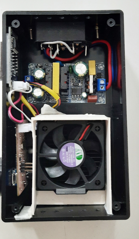

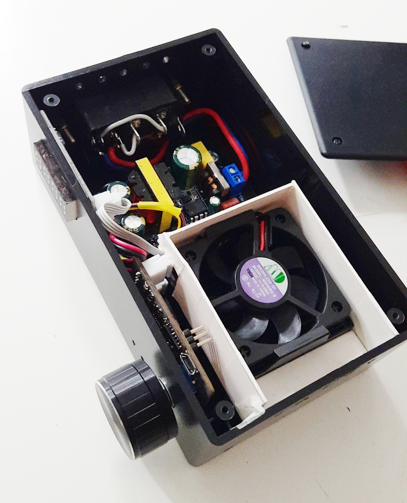

And here's what's inside:
Second picture, just above shows:
* At the top a standard 230V device plug with fuse and switch.
* Just below it a 230VAC-12VDC 2A SMPS module (cheap Chinese junk, works fine, but has no primary-side filtering.)
* To the left of the 12V supply you can see the PCB of the TM1637 module. I had some of these lying around anyway which I bought for another project and it is kind of appropriate for this contraption.
* Bottom left shows the vertically mounted processor PCB with the micro-USB jack and the SPI connector visible. The PCB mounts to the case by means of the rotary encoder which is soldered directly onto the PCB.
* The UV led is hidden below the fan and the heatsink; those are probably from an old 1st generation Pentium processor and I had those sitting in the parts bin anyway, so put them to good use here. The white cardboard thingy is an airduct which allows the fan to suck air from the case through the heatsink fins, taking the heat from the LED out of the case through the ventilation holes at the bottom of the picture. Above the 230V power inlet there's another series of holes that allow cool air to be sucked in. It's all very basic and improvised, but works fine.

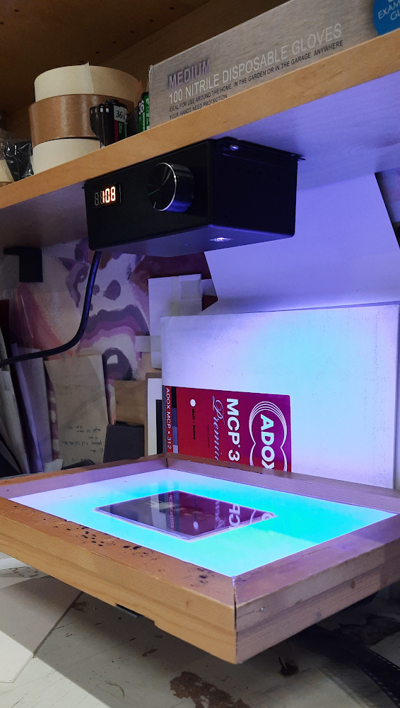

I just did some very informal 'testing' on this - i.e. holding the device against the shelf I had in mind to get a feeling for the falloff. It seems that the COB led throws quite a wide beam, in fact; I'd estimate it as 100 degrees or even more. Since it's UV, I can only visualize the falloff using a fluorescent surface (office printing paper works fine), but it doesn't seem like a big concern for exposing smallish PCB's or prints. Especially for PCB's it's kind of a moot point since that's line art anyway with a lot of leeway in terms of exposure. Maybe I'll be doing some testing with 4x5" Van Dyke Browns or something like that once I have figured out a way to mount this thing in place. I had hoped I would have some 90deg. brackets sitting here that I could glue to the box, but sadly the ones I have are way too big. It'll probably have to wait until tomorrow or next week.
Either way, the falloff concern is a valid one, but I have good hopes. Of course there's a relationship between coverage area, distance between light source and print and light intensity, but I haven't yet determined if it's favorable for alt. process prints. I'm fairly sure it'll be perfectly fine for PCB exposures which are generally pretty short anyway with the UV resist I've been using (the blue paste you get from China).
The biggest PCB's I anticipate having to make are only 10x16cm anyway, so I'm not really shooting for the stars here. For anything bigger I have my UV tubes anyway which will cover way more than A3 paper size at direct sunlight-equivalent UV levels.

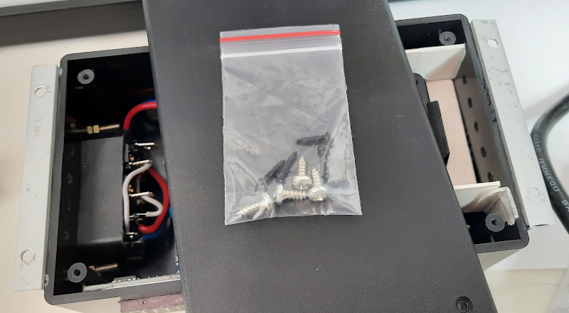

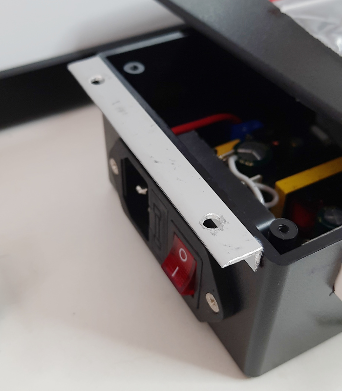

Looks like the bracket challenge could be solved pretty quickly with some lengths of aluminium L-profile and a dab of polyurethane glue.
Now comes the tricky bit - 24hrs of patience to allow the glue to cure.

To keep it a bit photography related, here's the 'first light' print. It's a random glass plate (a little under 4x5") that happened to be within reach and sort of matched the density range of Van Dyke, which is the quickest way to test for me. Since it's been pushed and shoved around my workbench for 18 months or so, it's scratched quite badly, but that's actually an advantage in this case. Here's the print, on random paper (which actually doesn't work very well for alt. processes, but again, close at hand):
Here's a closeup of the scratches just to the top right of the vacuum tube at 600dpi:
The scan doesn't do justice to the sharpness of the real print. Even on this rather coarse paper, the sharp rendering of those scratches is quite shocking when viewed with a magnifier. I haven't done side by side comparisons yet, but I'm pretty sure this is significantly sharper than my UV tubes.
Exposure time was 270 seconds at a distance of something like 30 cm or so.
So, it works.
