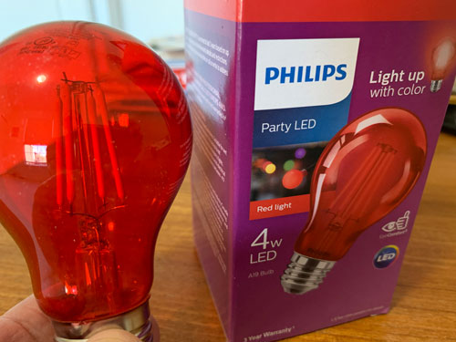

Will this work? it's the only red lightbulb I can find anywhere near me. I tried checking philips.com for wavelength info with no success. There's one more photography store that is closed over the weekend. It either of these don't work, it will likely have to come from B&H or Freestyle.
If that works, I will be surprised.
Most likely those are white light LEDs inside a red glass envelope.
That's exactly what it looks like to me, too. I tried it in the bathroom that will be the darkroom and it is pretty bright, so it would at best have to be in a clamp-type fixture, pointed away from the work area. It's going back to the store.
Only thing I can suggest is to test one. My current safelight is reasonably similar -- a (white) incandescent filament inside a ruby glass (coated?) bulb, and it's fine. If the glass filtration is correct, it'll be fine.
If they have one you can see operating at the store, take in a CD to use as a diffraction grating and see if you can detect any blue or green in the diffracted reflection from the bulb. If not, it's probably safe enough to at least buy and test.
Interesting test! Never thought of it, but it makes sense.

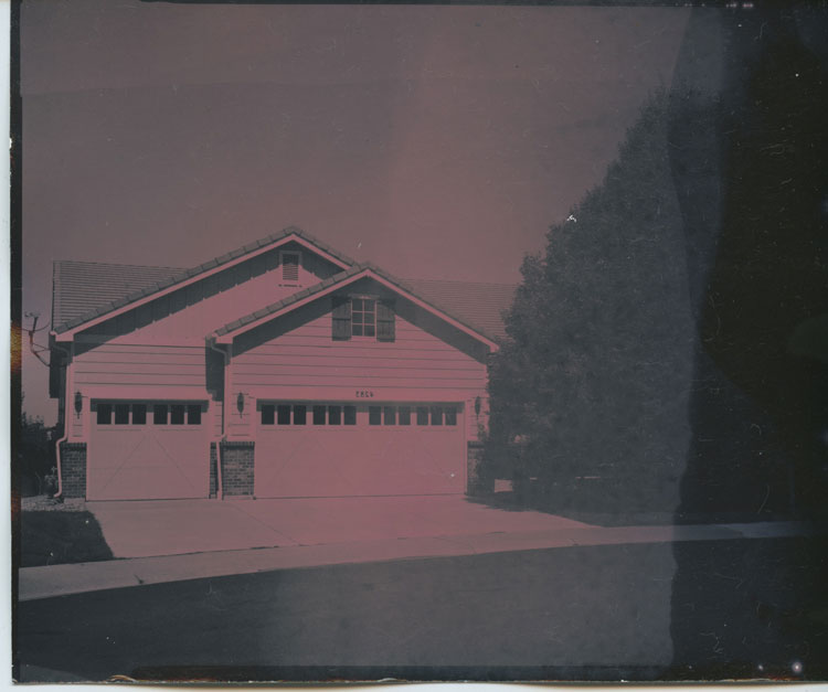

Last night I went solo in my own darkroom for the very first time, a temporary bathroom setup. I have no training whatsoever, so this is a completely autodidact thing and APUG, and all of you, have been a huge assistance. To ease into it, I limited it to developing the 4 sheets of HDPP. They were 2 sheets of preflash test and 2 taken outside my home - within about the first 10 LF exposures I have ever made. The photos themselves turned out to be a shambles and I will post a scan of one of them to see if anybody can count all the errors I made. But the operation of the tools and the workflow , pre-soak thru drying, went surprisingly well. It gives me confidence to move on to the next phase, to enlarge 2 chosen 35mm negatives on Ilford 5x7 MGRC Deluxe paper and do some safelight tests. The plan is to continue to work on these 2 negatives until they come out nicely.
For now, I do have one question. All the highlights on all the sheets still have the pink coloring that the HDPP starts out with - not white at all. What did I do wrong there? Developer and fix (both Ilford) were both fresh and mixed to spec. Timing followed data sheet recommendations.
It was very bright, not a cloud in the sky, mid-day. I purposely chose a very high contrast subject, just to see what would happen. I sure got that. HDPP, 4x5, in a 4x5 tray. Should I have used a 5x7 tray for more room? 3 minutes in Ilford Multigrade 1+14.
How many things did I do wrong?
That's still pink, so it may be underfixed (less pink on the right hand end?). Did you preflash at all? Finish fixing, rewash, and completely dry, then post another photo of the print. It'll tell everyone more.
