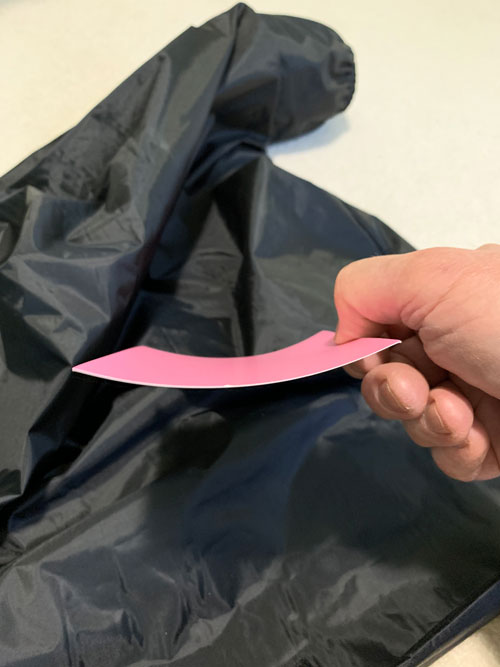

First impressions from unboxing first sheet.
1) It has a lot of curl. This concerned me until I remembered that in a holder it sits flush and flat.
2) The curl will be a problem if using the Jobo 4x5 reels to tank-develop more than one sheet at a time. I remember them being difficult to load with flat Delta 100, but mounting this stuff was really difficult to do, even with my eyes open. And it looks like it will easily fall out during processing.
3) Being paper, it is very soft and the emulsion easily dented without very careful handling. The edge can become frayed while loading/unloading holders.
4) It fits 4x5 holders perfectly. Fidelity Elite, Lisco Regal, Graflex, all good. I had read there may be a problem with it being thicker than film, but did not find this to be the case.

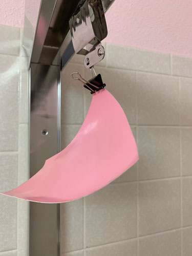

I took some more steps to test out the materials and equipment.
The Ilfochrome developing tube takes only 250ml of fluid so I was concerned whether the paper would get enough/even development. It turns out that the HDPP gets real flexible when wet and also sticks pretty tightly to the tube wall. With a pre-wet, this should allow developing more than one 4x5 sheet together without overlap.
If hung up and left to itself, HDPP dries with a LOT of curl (see pic below). Now after being pressed overnight it has flattened a bit, so I will leave it in a bit longer to see what it does. Its in Horan's Matthew Brady biography, which seems fitting since it's orthochromatic and prints will be backward.
I checked out one of the Revere print driers from the pile, and it heats up nicely, so next move might be to wet the paper again and see how that comes out.
It's really interesting how this project is finally backing my way into darkroom work. The next steps will likely be to either develop the 2 sheets I exposed on Monday, or cut out some black sheet plastic and see how dark the bathroom will get and set up the Durst F-60 for pre-flashing.
Curled HDPP after air drying:
