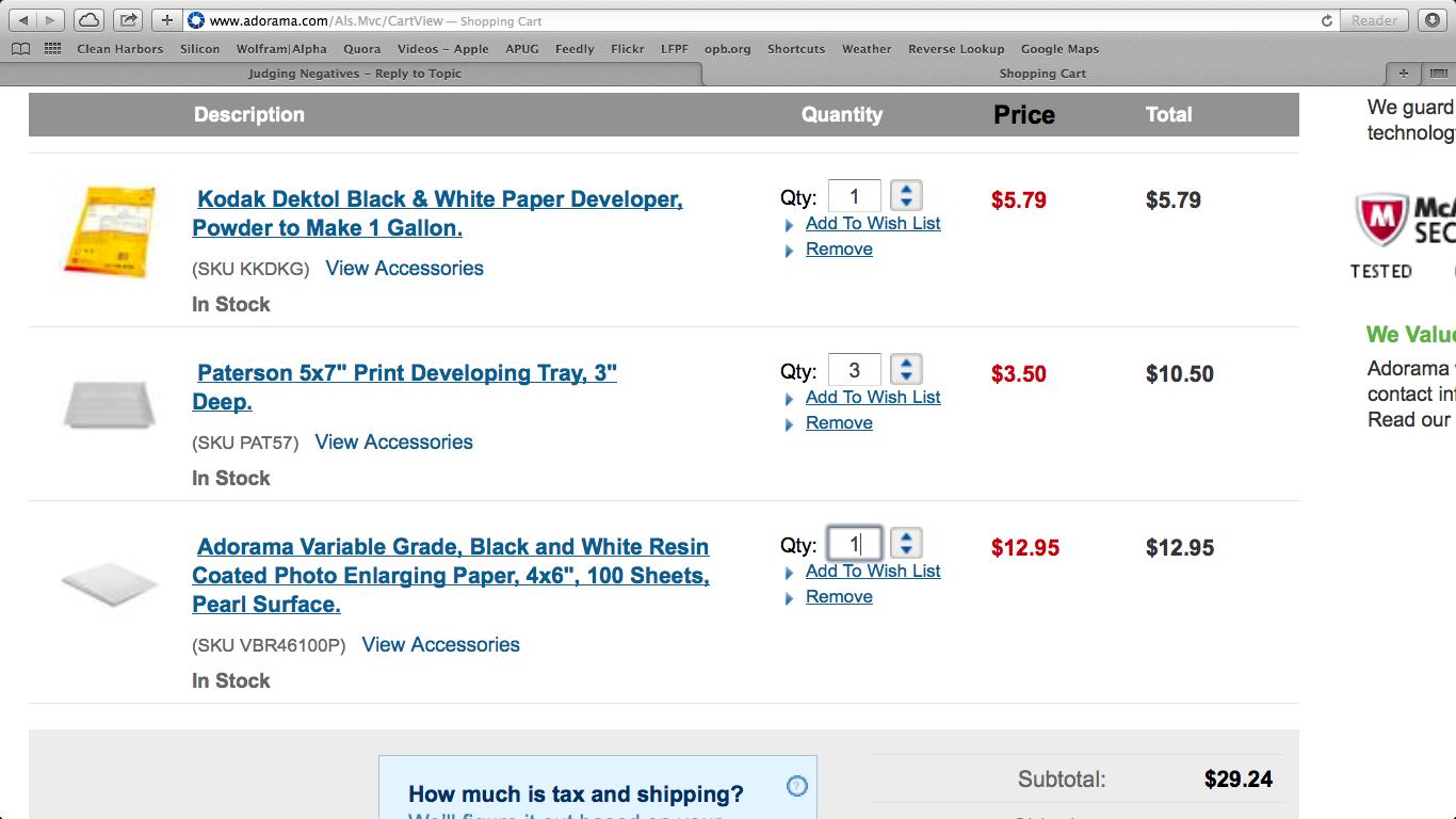

That stuff plus the fixer you already have and a light bulb in a dark closet and some practice is everything you need to do a contact print.
These are essentially the same tools Weston used, albeit smaller.
