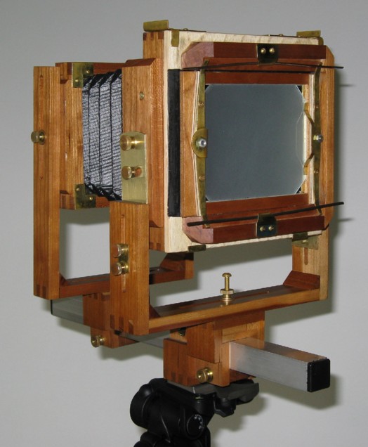

I agree the three glass idea seems like a good one! In my case I used an 8x10 piece for the grinding glass and a 4x5 for the ground glass for my camera. I used the fine end of Wurth valve grinding paste, stock number 089199. I don't know what the grit is, 600, 800?
The 8x10 grinding glass gave me a lot of surface area to make sure I kept the ground glass flat and the "fine" paste gave me a very bright screen. I had originally thought of buying a ground glass but in the end used the one I made.
