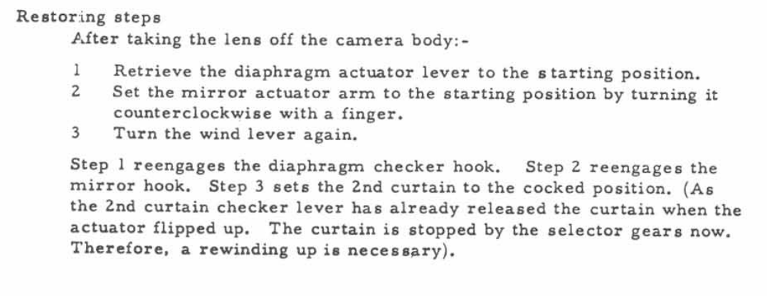

The reset function will sacrifice one frame of the roll to effect correct reset.
There is another reset procedure that doesn't lose a frame, it is described on the service manual.

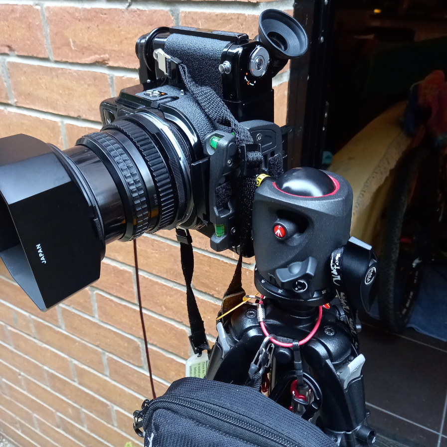

My two 67s are always tripod-mounted and remains so each and every time, all over the 20+ years of thousands of rolls of film. I do not risk ruining a single frame (or more) to blur when a roll of film is now $50 and rising! Most newbies coming to grips with the 67 will find it mightily heavy (some users I know are now quite averse to this camera's heft and bulk and they, too, now work from a tripod!) with, especially, one of the LS lenses (the 165LS in my case), add the wooden grip (which is a nuisance when packing the camera away), right-angle finders, etc., etc. Definitely no lightweight to tote around on a cake 'n coffee walk (but then, neither is an 11x14 Tachihara View and 40kg studio tripod... 😆)
I'm not a service person or having seen any such service manual, so I use the gentlemanly option despite gnarling and grumbling at the waste of a single frame (I've done worse historically! 🥺 ) — service as and when necessarily is left to VinTech Service down in Melbourne. Can't remember when I have used the reset function on either/which camera actually — probably 10-13 years ago with a sketchy memory of an incident...
Here's the procedure:

Most instructional.
What is meant by the last sentence: therefore, a rewinding up is necessary...?
Not sure of what they mean, but i'm 90% certain that this procedure doesn't require losing a frame. On the other hand, this procedure means carefully putting your finger inside the mirror box (for flipping up the mirror) and it's obvious Pentax knew this wasn't an user-friendly or foolproof procedure. Thus, they quickly introduced the little button for resetting the camera (the first versions of the P6x7 camera didn't have this button)

My Pentax 6x7 is a compact machine...

Most instructional.
I don't have any experience with a Pentax 6x7, but from the text, it seems clear to me that they are explaining why Step 3 (wind the lever again) is needed. If they had written "re-cocking" rather than rewinding it would probably be clearer, but the text is also likely written by a non-native speaker of English.
