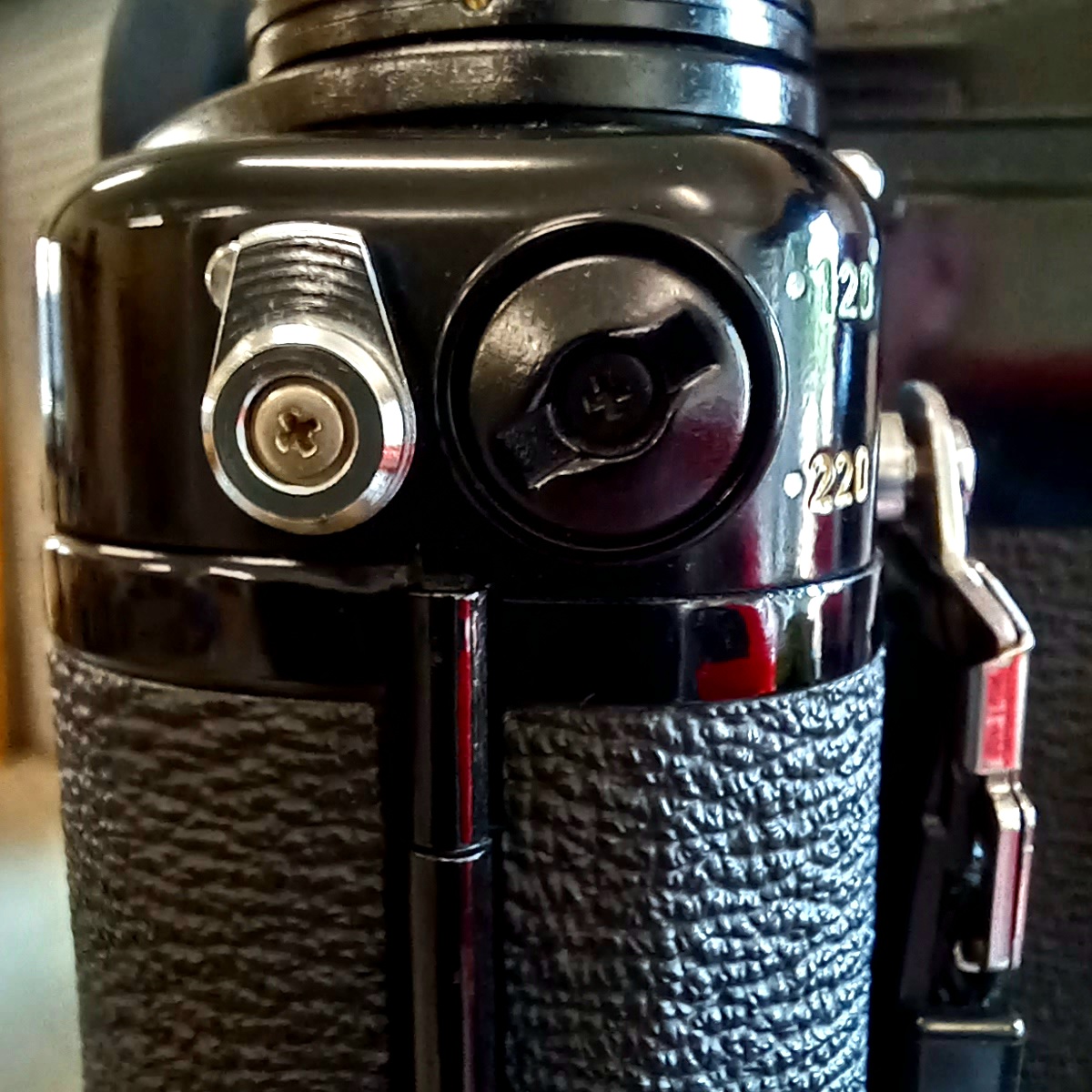

Be cautious if you land an early (1969 to 1976) 6x7 over the final-generation (early 1990s)) 67-badged cameras. So very, very many have gone through multiple professional in-service with attendant abuse over the years. Weak spots are the winding mechanism, specifically winding pawls stripping or breaking; film counter roller and sometimes broken film reel studs (early model cameras). Old, neglected cameras will require the light seals replaced around the prism and internal dovetails around the back cover — a gnarly and grizzly task best left to people with lots and lots of patience and 'elbow grease' — 'tis a loathsome chore! Some cameras come factory-fitted with a multiexposure facility (see pic below) — handy for stacking the scene for different effects.
Retarded shutter speeds in the 1/250 to 1/1000 range also show up in user gripes. Decay of mirror operation occurs regularly, with service of the solenoid being a good fix. The meter coupling chain is a bit delicate and can snap if a specific procedure for dismounting and re-mounting prism and lens is not followed. Repair entails disassembly of the lens mount and fashioning a replacement line out of e.g strong TigerTail beading wire that is very flexible and very, very strong, then re-calibrating the mount for correct alignment (it uses shims). Would recommend you look for a 67-badged camera with mirror lock-up that allows you to effectively isolate judder and shake in landscape (which assumes you will be using it tripod-mounted for the very best results it is able to deliver).

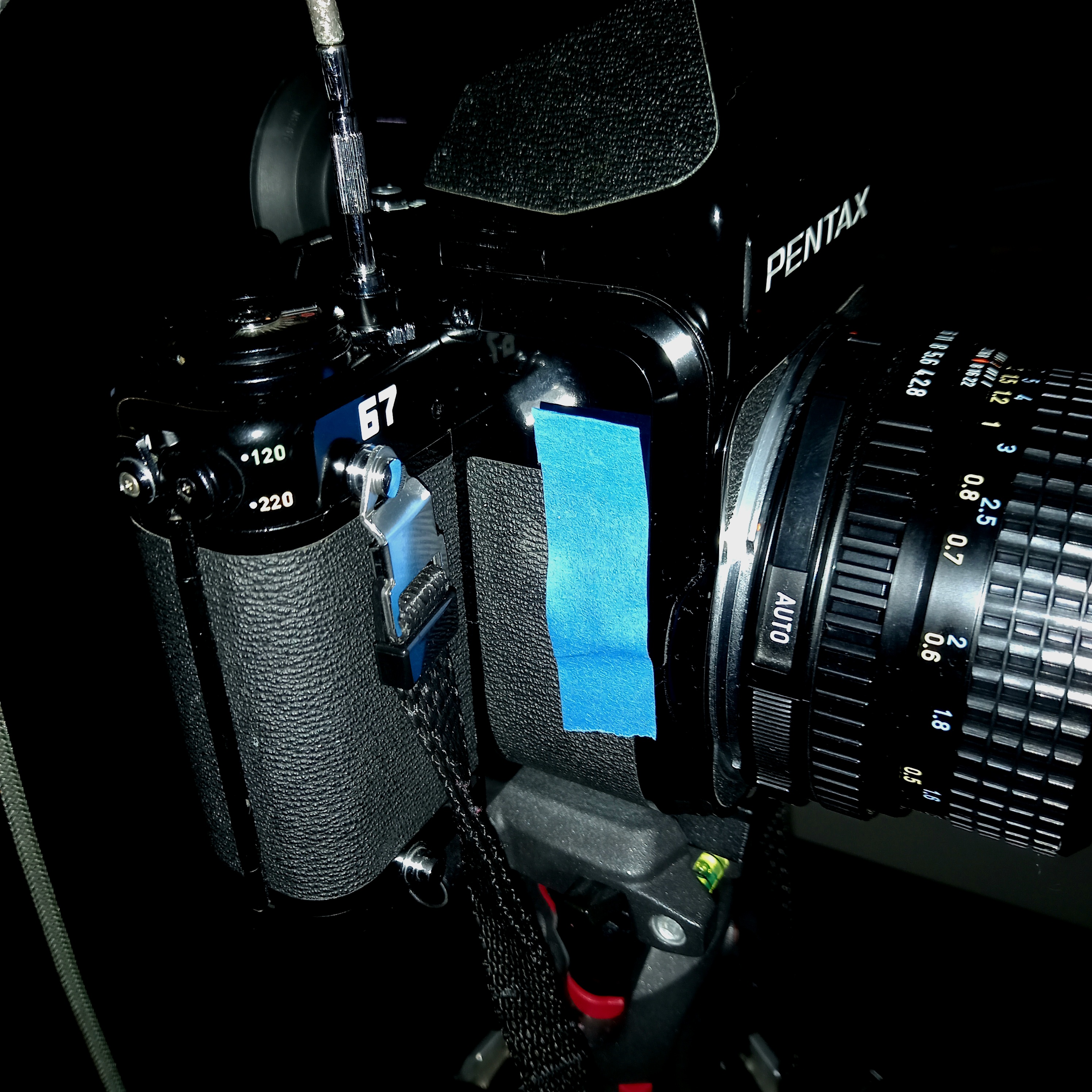

Where MLU is fitted: with film loaded and the camera cocked, the MLU lever should be taped over to prevent it being accidently tripped in the pack, thus draining the battery (see pic).
All 6x7 - 67 bodies have a reset function that also craftily doubles as a battery-less exposure trip for astrophotography (using a cable release and adaptor plate). The reset function will sacrifice one frame of the roll to effect correct reset.
Try and examine a camera of interest in person rather than take what is printed as gospel. Else, ask lots of questions and be very satisfied that you are being given the right answers.
