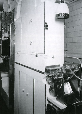

What volume of fluid was in the kettle before pumping into the coating line PE? I'm just trying to compare batch sizes from Kodak to my own company (industrial lubricants). The largest batches I ever saw were 5,000 gallons.
Well, depending on batch (product), the kettle ranged from 50 - 1000 L. Obviously, I cannot give an exact value for any one product, but you can assume that 50 L was a small runner and 1000 L was a big runner. BTW, that is true today as well. They did not rip out equipment, they just run it less often now.
Attached is a photo of the smallest research coater. It used about 100 ml at the low end and 1 L at the high end. It occupied the space of a one car garage including everything.
PE

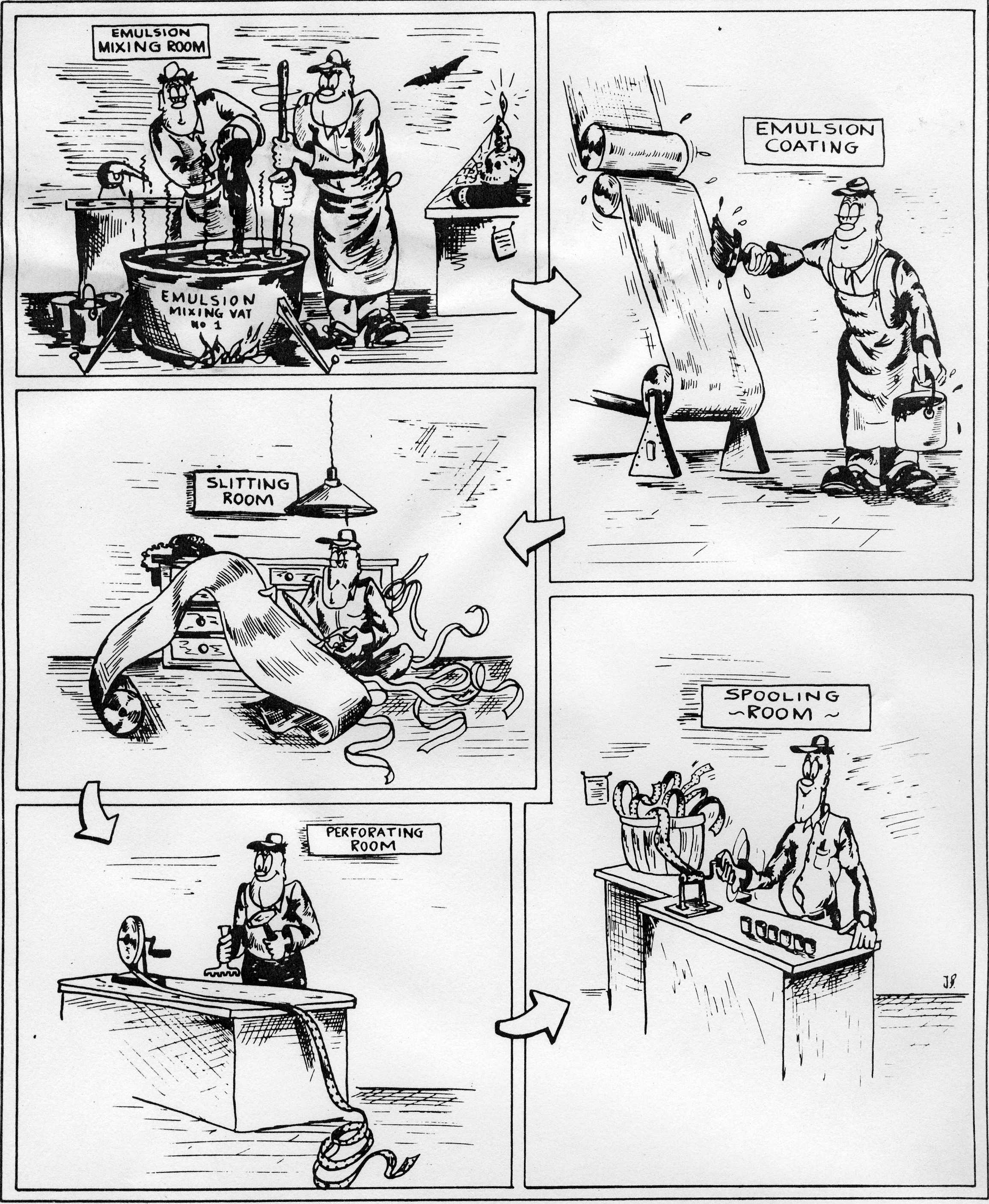

Very interesting. I guess I failed to really appreciate how thin the coatings are. Even with miles long rolls, the batch sizes are not particularly large.
Here is an exact example of the process. Kudos to the unknown artist who posted this all over Kodak Park!
PE

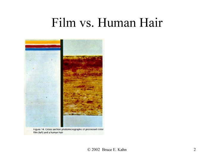

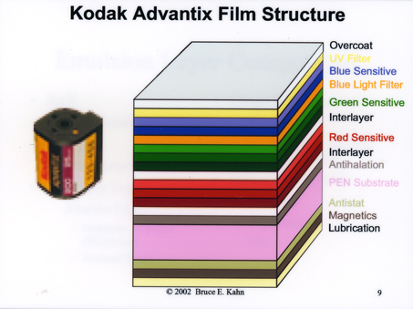

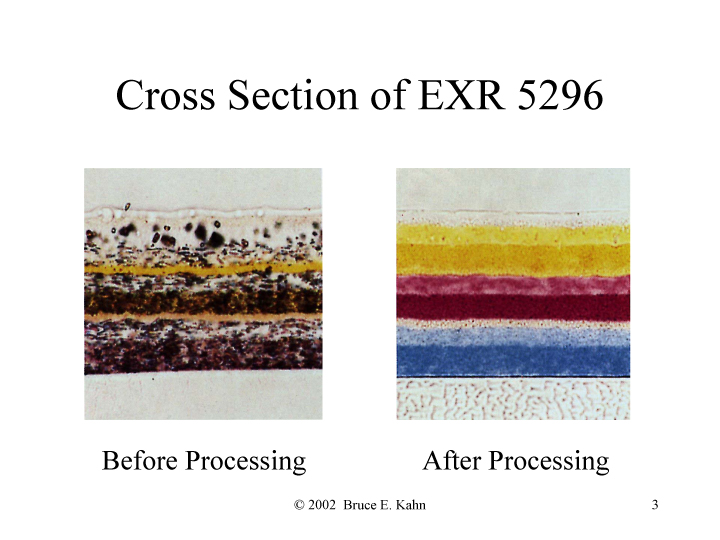

A coating can be thinner than a human hair.
See attached.
PE

Wow. I've never seen a scale comparison like that third photo. That's beyond amazing!
