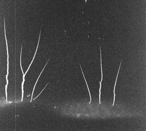

Yesterday I processed a Fomapan 100 135 film, factory load, not bulk loaded. There's the, presumably lot code 023215-07 and the expiration date is 9-2025. There are static discharge marks in at least 10 frames. The clearer example can be seen on a blank frame below (with greatly exaggerated contrast):
And yes, the thin line on the left (running lengthwise on the film) is there on the film and not a scanning artefact. It's a scratch that appears in many frames. I seriously doubt it's camera related. The rest is simply dust. It's an interesting and very affordable film, but sadly it's not worth much if it's plagued with defects like these...

This could be a confectioning defect; trying to run their lines too fast in a cool, dry atmosphere.
This is a typical "peel-off" discharge, where the static discharges as the top layer leaves the roll, usually at high speed.
I have witnessed full width discharges in a cold, dry darkroom that were easily visible and were whitish/blue in color when the film was unwound too fast.

What are the results from developing a virgin unexposed roll? If the marks are still there then it is a confecting problem.
No marks doesn't prove the problem is in the camera, though. It could be that the test roll just, by random chance, has no discharge marks.
The other related thread shows almost identical marks, so unless the same static discharge was in both cameras, improbable at best, then again the manufacturer is responsible.
The same issue has popped up at least 3 times over the past few months AFAIK, in all cases with within-date Fomapan film. I think odds are it's really confectioning-related.
My thoughts exactly...
That is what I experienced on very dry windy days with static discharge.
It wasn't dry, nor windy. It was an average humidity day and my first time noticing something like this with my films. The vast majority, if not all of the static discharge cases that have been mentioned in the forum were Foma. It's not IMHO a coincidence, it's a sign of problems during confectioning. And it's a shame, because Fomapan 100 is an interesting film. Oh, and a bit worrying since I recently bought a 100 ft roll of R100.
