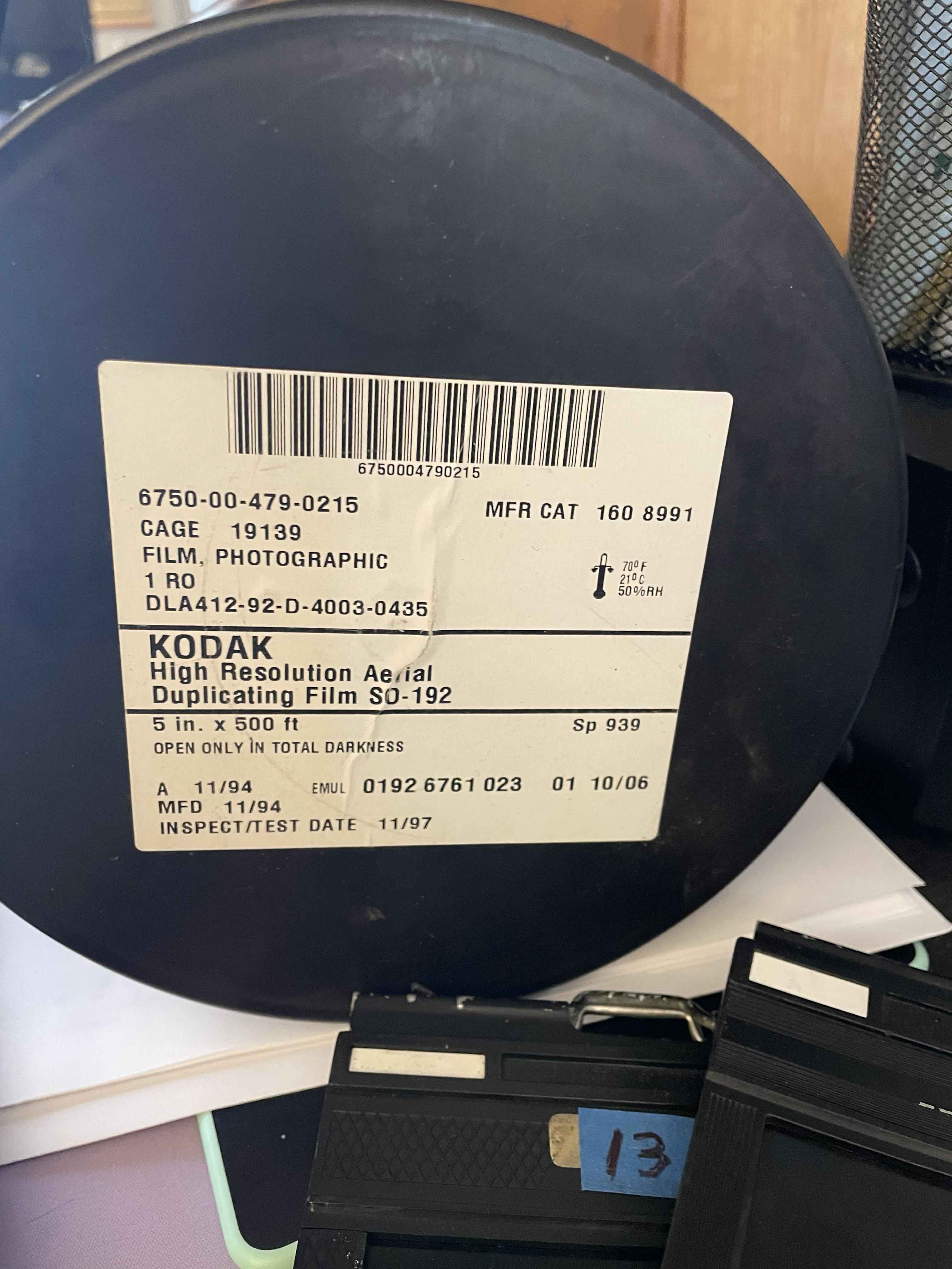

My professor was given a few canisters of this expired aerial duplicating film by some air force guys and he passed it off to me.
I guess it's supposed to be used to make copies, but I've cut it into sheets of 4x5 and loaded it to shoot in my camera. I just can't figure out what ISO it is. The info sheets I could find (here) and (here) don't say. And short of busting out the densitometer, I don't know how to find out. Anyone have experience here?
Haven't figured out how I'm going to develop it yet either, but I'll look into what the versamat chems mentioned in the kodak data sheet and see if the I can get/make something comparable.

The label does say to open in total darkness, so it might be more than just blue sensitive. With that product number (SO-192) it's a special order film, so it could be any emulsion.

SO-192 was designed to make positive copies from long rolls of aerial film negatives. It would be exposed in a roll-contact printer, a very large device, and developed in a Kodak Versamat processor or similar. Probably used only by the US government/military, thus its SO- designation. Maybe the commercial aerial photographers used it too.

SO-192 in listed in Robert Shanebrook, "Making KODAK Film" page 380. This a very, very slow, gamma=1 film with a resolving power of 722 line pairs/mm on Estar Base. I think you will find it has a EI that is slower than 6. D-76 might work to give you a less than gamma of one. It was primarily used to make aerial positives from High Definition Aerial Film/3404. Seeing that it is about 30 years old testing is the best alternative. Good luck.
