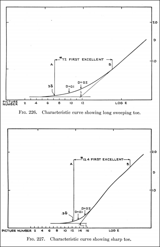

Here is why the test yielded a lasting concept of film speed. The two film curves below are from a long and short toed film. The fixed densities of 0.10 and 0.20 are shown. As is the fractional gradient point, 03G. Notice the differences in log-H between the fixed density points and the fractional gradient point in the two examples? This isn't intuitive and could only be found through psychophysics.
Stephen, the curve with the sharper toe is much slower. This is why we tried to maximize the toe and also get the highest toe speed. The actual speed of an emulsion is the inflection point of the curve over fog. Anything else is meaningless due to variations in toe and contrast. One works with this value to optimize the curve that "follows".

.3G is the fractional gradient speed point which falls at a point 0.3 times the overall film gradient. It tends to fall further to the left in relation to the 0.10 fixed density with long toed films and when the film is developed to a lower overall gradient, Because of the changing relationship between the two points, the ISO standard needed to have stricter contrast conditions than the fractional gradient ASA standard pre-1960 which only suggested the film be processed over a minimum gradient. Please see all the references and examples that I've presented that support this.
BTW, the two examples from Jones also contain inertia speed points.

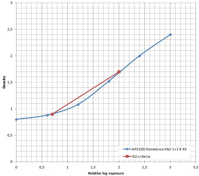

Late response, but what the hell... Yes, I've done such a test in the past with homebrew D76d and 400TX IIRC. I had followed Kodak's recommendation and indeed, the characteristic curve had two points where it met the ISO criteria, for whatever speed it was. It has been a while, but I used the same homebrew Xtol with some outdated (7-8 years) Agfa APX100. I followed Kodak's recommended time from an old Xtol datasheet. The film had quite a lot of fog (fb+f = 0,8!) as you can see at the following figure, but the curve meets the ISO criteria for a speed of 64 as it seems:
In this curve, normal exposure of the test target (gray card) would be at 1,5. Shots at -5, -3, -1, +1. +3 and +5 stops were used. The film was shot at EI100 and most shots show obvious signs of underexposure. Textures at the shadows are mostly gone. Bracketed shots that were given more generous exposure came out ok and fine grained actually.
