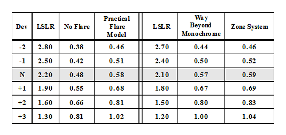

By 18%, do you mean the meter's exposure point because the relative reflectance is 12%. That's introducing 1/2 stop error into the test. And stop down three stops comes from where? Unless you are saying that within +/- 1/3 or so stop, you have found 0.10 over Fb+f three stops down from the metered exposure?

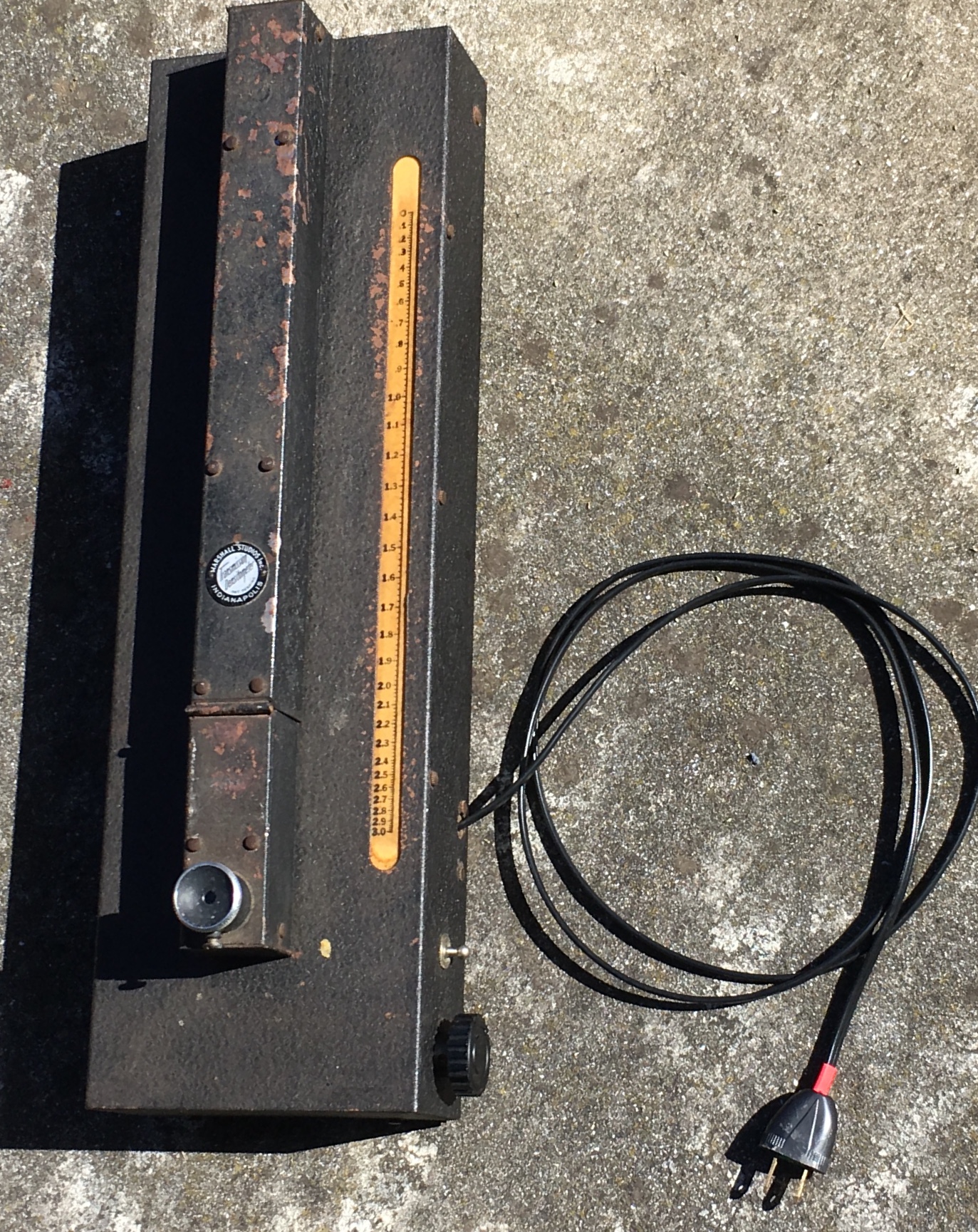

This is the densitometer I use these days. I have a photoelectric one but I prefer the simplicity of this one. It works off the principle of inverse squares...
https://www.photrio.com/forum/attachments/24bed12b-e662-47af-8cc1-214e2639651b-jpeg.202916/

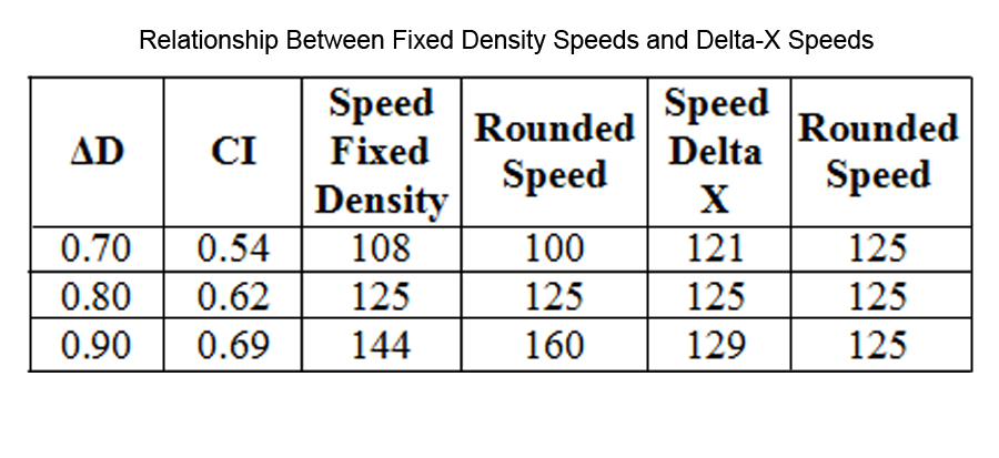

Without proper testing the determination of accurate film speed isn't possible and is mostly a waste of time. Non-standardized techniques generally produce a false sense of accuracy. If the OP wants something for batch testing, relative log-H from a consistent light source will identify any variance between batches, but can only offer relative speeds.
Here is a comparison of two film speed determination methods: the fixed density method and the Delta-X criterion.
In terms of contrast, it's rise over run no matter what you use, plus the OP appears to be using logarithms. The hard part is to define what the aim values should be. Here is a table with different development models. I'm partial to The Practical Flare Model that I worked out.
Stephen,I'm glad to see that our results match so closely.
