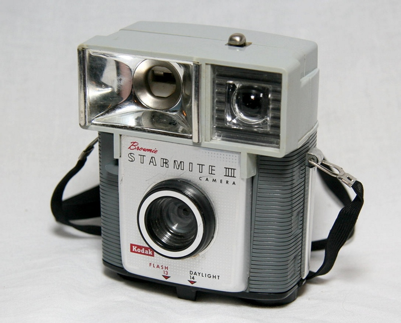

I started out with one of these, 55+ years ago, at the age of 8:
Indeed! :smile:
When I looked at some of the older cameras, it reminded me of a toy 'spy' camera I also had, after I was given the Baby Brownie Special. It was made of plastic, also took 127 film, but had two red windows on the back, to accommodate 16 images. I recall it was somewhat smaller than the Baby Brownie Special, but it could fit in a shirt pocket.
