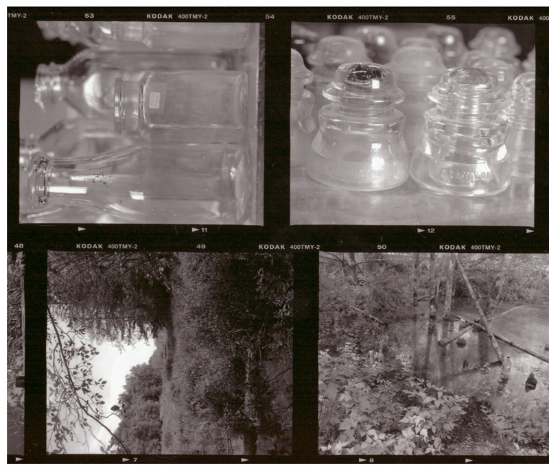

This is a scan of a portion of a contact proof sheet that is fairly close to what I like to see when I am doing this.
It is of 6x7 negatives because, after re-sizing, the results are easier to see in the scan than if I used a 35mm example.
There is a slight difference between the rebate density and the density where there is no film. I find that if I cannot see any difference between the rebate and where there is no film, than I have made the contact proof sheet too dark to either see the photos properly, or evaluate the negatives properly.
The contrast (filtered for grade 2) is on the slightly high side of normal, but for the subjects involved, I am happy with that.
