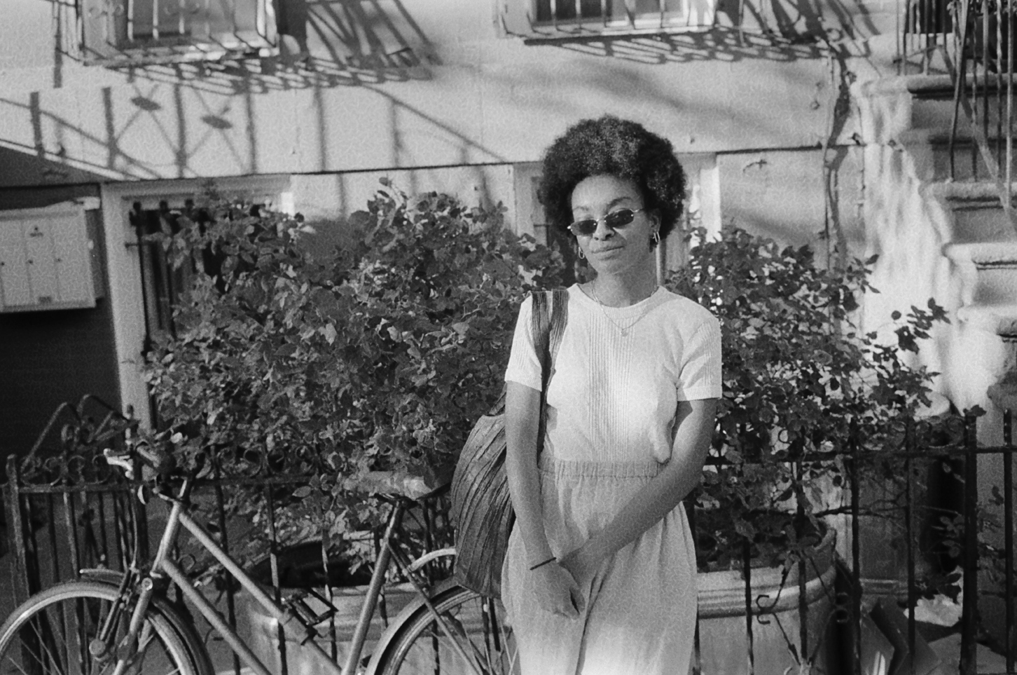

It's TX400, Rodinal 1+50, continuous rotation by a filmomat machine, the chemicals ARE old I'm at the last drops but I've been at the last drops before. The film is fresh

I don't see any signs of reticulation but it would be better if you layed the negative on a light source and made and posted a photo of the negative itself.
It seems like you'd really have to abuse TX400 to get reticulation. What temperature were the processing chems?
EDIT: OK, I looked really closely at the full size image...yup. I see what looks like reticulation in the lady's pants and the highlights around her left breast.
Almost definitely, yes. If the wash water was much hotter or colder than the chemistry was, you will see reticulation like this. Do you know for a fact whether or not the chemistry and wash water were all kept within a couple of degrees?

Yes, you must keep all the temperature of all the processing steps about the same. Presoak is not recommended and not necessary but if you do choose to presoak, the temperature should be at the same temperature as the developer and stop and fix and wash.

Not quite. Temperatures may vary. But only gradually. Abrupt changes can lead to reticulation. .

I copied the image over then opened it in Photoshop and enlarged it to 200%. I have seen this effect before and I can categorically state it is not reticulation. If it were, the grain/emulsion would 'lump' together like a string of sausages. On this the grain is in seperate individual particles. Yes the temperatures should be kept within reasonable parameters, but you cannot get reticulation by going from one very cold bath to one that is warmer. Reticulation only happens the other way with dropping warm film into a cold bath. It is caused by the film emulsion shrinking in the cold bath, With todays emulsions, they are so resilient, it would be very difficult to get the effect anyway.
The marks that 'look' like reticulation, is actually grain. The film I would suggest was scanned on a flatbed scanner and this is what grain can look like when scanned this way. Scan it on a dedicated film scanner such as a Nikon and the grain would be the normal shape. If it were the print scanned on a flatbed the effect would more or less be the same.
Another problem which is causing this is a 400ISO film developed in Rodinal. Rodinal, or at least the original Agfa version was recommended for film up to 200iso after that you take what happens. Also development in Rodinal should have minimum agitation and the usual was for the 1st x 30 seconds the agitation should be continuous and for the remainder of the time one inversion of the tank every 30 seconds. You have grossly over agitated hence the visible grain you mistake for reticulation.
Rodinal and the derivatives are acutance developers where they give apparent sharpness, but this does not happen with continuous agitation, all it does as I said before is to increase the size of the grain. It is not a fine grain developer even if processed as recommended hence the recommendation it is used on slow to medium speed films.

Hey guys, so I'm responding directly to Bike Rider, but this is generally for everyone. I've been processing with Rodinal for years now. At first hand processing. I got the filmomat in June and have put a good number of black and white rolls through it (mostly tx400). I scanned the film using a Noritsu LS600. I hit up the Noritsu facebook group to see what the members had to say about the film, and it seems like no one else had the machine create results like that. Most people judged Reticulation just like on here.
What you have to say about the structure being a little different than the typical look I agree with. But maybe it's becasue the temperature change wasn't as drastic as what ever caused those more common types of reticulation / this was a milder form.
Going back to the over agitation, I've already factored in continuous agitation to my processing times, and so have the others on the filmomat group so I doubt it's anything to do with that.
What you're saying about cold to warm water though, do you have some sources I can read or watch about this? Becasue I did the opposite, I think, of what you're saying. I put COLD water to presoak for a minute, and then -- ACTUALLY I just realized sometimes I'll have COLD water and mix it with room temp water that's been sitting in my machine for a day or two... so that prob warms the water up significantly and then the film and once the developer goes in it's shocked by the cold.
anyways I did more processing today after hearing what people had to say and yep, I got good negatives this time around after keeping the presoak bath and the stop bath (I just use the tap water) the same temp as the developer (also fix was the same temp as everything else too me bad, but I think I could get away with letting the fix be room temp).

Soooo when I process, I use that film o mat machine. I get a big bucket of COLD COLD tap water, I wanna say 40-60 degree fahrenheit but I'm being really liberal with that judgment. And I mix my developer with that water and add a little hot water to bring it up to 68 f. I usually use the same bucket of cold cold tap and put it in the machine to be used as the stop bath and as the pre soak. usually I don't mix new fixer so that's often room temp. Rodinal 1+50 Tx400 film n a heart of gold. lol. Ok good luck! :smile:

First of all If I can explain how Rodinal is designed to work to give increased apparent sharpness. The solutions of diluted Rodinal work on the film to produce a visible image but because it is so dilute, with the reduced agitation the edges of the dark areas exhaust slightly quicker than the remainder of the developer film and this gives a clear line between areas of differing densities of grey. (Very much similar to the application of the 'Unsharp mask' in digital manipulation software.) This is also apparent on INDIVIDUAL film grains too which they are more visible! As you state you are using a 1-50 dilution the 'edge sharpening' effect will be more apparent. That said you can quite happily develop a film with normal agitation but will not get the enhanced sharpness because the film is constantly bring covered with fresh developer. The grain will be increased and if you develop a film for the recommended times on the sheet that will come with the developer, that too will tend to also make the grain more visible. (Or even with your modified times). As the edge sharpening affect is more or less cancelled, you can use one of the ordinary developers such as ID11/D76 and get very much reduced grain and the edge sharpness will be about the same
Reticulation is caused on film when a film is developed in normal or higher than normal temperature and during the process the emulsion will naturally soften and as you will know the emulsion is easily marked or even removed at this stage. Then if the film is plunged into a much colder bath the emulsion will shrink because of the change in temperature and this is what causes the reticulation.
Going the other way from cold to hot may have other effects, but one of them is not reticulation! One effect (disaster) being that in extremely high temperatures, I have seen the emulsion detach from the film base itself. I assume you used a stop bath and the fixer were around the same temp as the developer. If it was a hardening fixer then also this would stop any reticulation, even if you used water which was comparatively cold. No, what you have got is a high level of grain and not reticulation.
I would also suggest that the ladies jumper being white, would of course be dense shade, possibly almost black on the negative and this would tend to show the grain more than say a mid tone. Especially as Tri X isn't known for being a fine grain film.
Here's a thought. Try the same film again but cut it in two. Try one half in the same developer but this time keep all chemicals within say 2 degrees centigrade then the other half in say HC110/Xtol etc but again keeping all the chemicals within 2 degrees of each other Ideally include that same lady in the same setting with same clothes and ideally light conditions
Then scan both identical negs or a range from the two sets of negs and see which set, if any, produces the same effect
Then let us know
