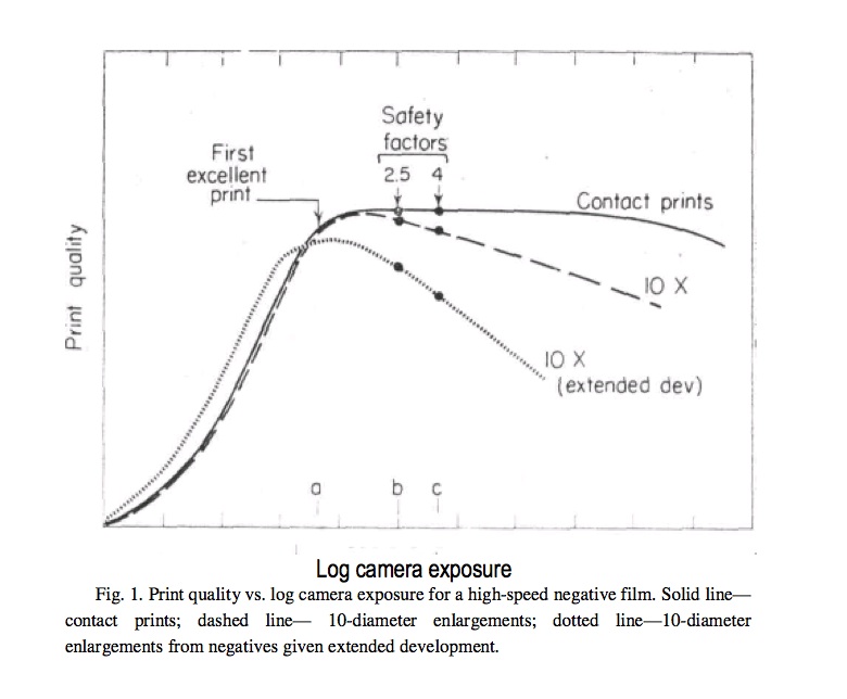

Can somebody help me understand if the improvement in tonal scale means more exposure latitude, or instead smoother transitions between the grey scales with the same absolute tonal range.
Yes, more exposure latitude when contact printing large negatives vs enlarging small negatives.
Conceptually why is that so?
Does this phenomenon also mean you get more exposure latitude when enlarging MF cf 35mm negs?
