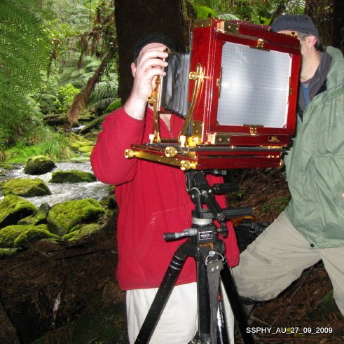

And what LF does not have weight?? For example, supposin' you're high-falutin' and successful (read: cashed up!) and can make the equipment pay for itself in image sales ... a Linhof Master Technika Classic (a pearler for $10,000 odd...) and say 3 lenses to cover just about every landscape/scenic need will weigh you down a bit over 4+kg (this is what my mentor used in the 1980s-1990s!). Add 4-5 film holders and the weight goes up still more. Some of the Walker Camera LF jewels can cut down weight with polycarbonate and titanium, but for that you also pay a price premium, ditto the plush Ebony SV-series. Little by little, bit by bit, the weight of a LF system most definitely goes up proportionately to what you add to it. There was a member here a few years ago who joined my walking group with a truly ginormous Tachihara 8x10. Plonked incongruously stream-side in a dark and dank rainforest, it was so pretty (and big...) that the wind dropped and the rushing stream paused in silence for a quick gawk. Honourable mention to the 20kg studio tripod that also came along as a comfy perch for the beast.
"Heavy as heck"?? You were saying...?

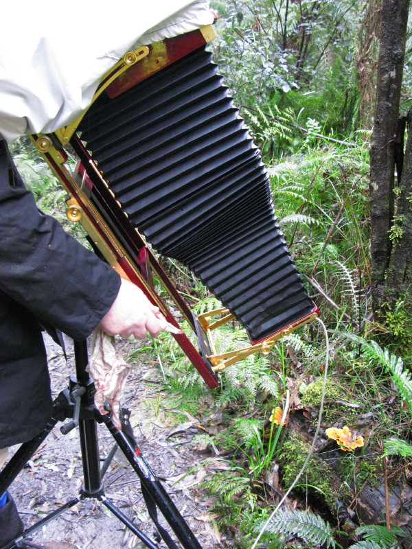

Here's another pic of that Tachihara sticking its snout at an innocent little rainforest fungi...
