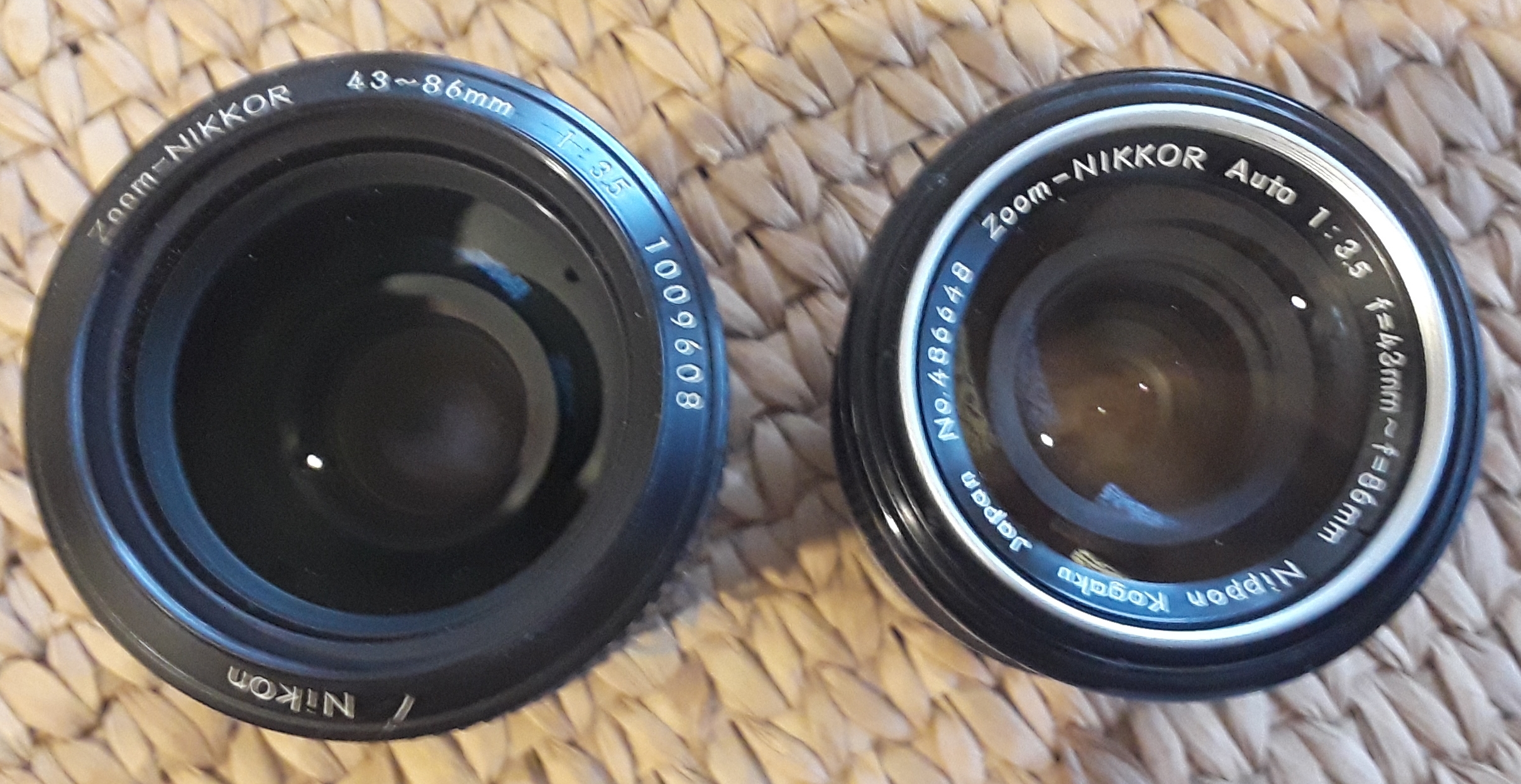

There were two versions of the 43-86. The first, with the engravings inside the filter ring, was a dog. It had horrible distortion on the edges, and the color rendition was always suspect.
The second, with the engravings outside the filter ring, is a very nice zoom, and I use it as a "walk around" lens with my FE, FE2, FM2n, and a Nikkormat FT3. Although it's a push-pull lens, I also carry a 80-200 f/4, and a 24mm f2.8, as a "street kit".
I did not know this! I remember working in a camera shop in the 1970s where the Nikon salesman was constantly pushing the 43-86, but when I test shot with it, I thought the images were awful, displaying both distortion in the corners and chromatic aberration. Others have called me out on this, especially journalists, and now I understand why. If I add an F series to my collection (which I plan to) I'll know which to search for. Do you have access to any photos or specifics to help distinguish the two versions?
Thanks!
Andy
The poorer performer is on the right. It's non-ai. The lens on the left, I believe, is ai-s.
Thanks a lot! It's going in the "Nikon F System File", which I hope to begin acquiring early next year. Unless those dang kids start buying them all up to use with their dang digital thingamabobs... :D
The one on the right is the model I remember the Nikon guy pushing. I feel much better knowing that I wasn't the only one who thought it was a woofer.
I enjoy the rendering of pre-AI Nikkors, but sometimes the resolution is night and day. Yesterday I developed a roll that was split between the Nikkor H 50mm f2, a well regarded lens, and a 135mm f3.5 AIS. The tele looked like it was shot on different film, being sharper and having more contrast. That's what 20 years of optical coating development does to an image.

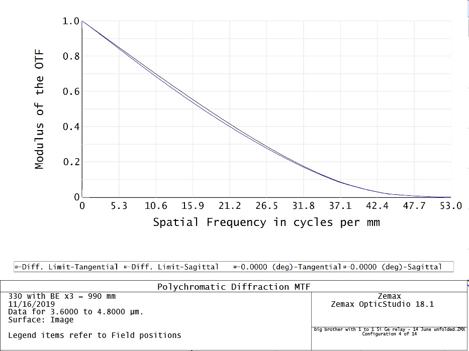

I think you should go re-read my statement in post 26 a bit more carefully, consider that your responses don’t align well with my original statement, and then leave it at that.
As an example, the following are what MTF plots I can share of a 50x zoom lens that I designed in 2013 (the date in the plots are today's date when I dredged up the design and captured these plots, but I worked this design in the spring of '13). It required on-axis diffraction-limited performance across the entire range of focal lengths. This was the upper range of focal lengths for a two-objective system.. hence "big brother" in the title. The other half, "little brother", extended the focal length range to 138x -- overall the focal length ranged from 10mm to 1380mm at the same f/# -- with overlap at the lower focal lengths.
At 25mm focal length
At 330mm focal length
At 990mm focal length
At 1380mm focal length
Other examples cannot be shared, and I cannot and won't share further information on this design. It simply serves as a real-world example.
In any case, perhaps now you understand what I mean when I say I am speaking from experience, and that it is possible to achieve consistent performance across the entire range of a zoom design. I can say this because I've achieved it myself many times over my lens design career, of which you see one example here. The old myth that zoom lenses cannot be as good as a fixed lens are, in this day and age, just that: A Myth.
What you don't know is what the design team decided was "good enough" MTF performance across the range of focal lengths... you are making an assumption which may not be correct. If you see a performance variation across the range of your modern zoom lens, it's because there are other considerations (size, weight, cost, schedule) that came into play during the design of that lens. As a general statement about optical design: Rarely is optical performance pushed to the max at the sacrifice of all other considerations. I only see that in astronomical telescopes, where optical performance is the most important consideration.
What you don't know is what the design team decided was "good enough" MTF performance across the range of focal lengths... you are making an assumption which may not be correct. Il.
The lens test reports by photozone. de are done by ONE set of testers using uniform conditions across all lens brands and body brands tested.
Indeed, it is improper to directly compare MTF values published by different testing bodies. it is even improper to compare Rodenstock lens tests vs. Schneider lens tests!
I conclude with the statement that the tests by photozone.de are objective measurements with statements of absolute resolution per picture height... there is no assessment of what is good enough versus not good enough ..there is no subjective labelling of resolution... They only report the hardn resultant from their uniformly done tests.
I do NOT state that zooms can never be equal to fixed focal length lenses. I am in fact a contrarian to that position; I know that that recent zoom lenses today have performance in excess of fixed focal lenses that were in their day superlative lenses, but fall which nowbehind the newest zoom designs!
