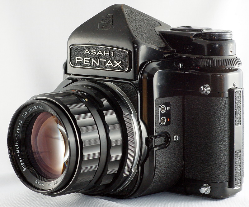

is there a new flash that works on a Pentax 6x7? X sync cord?

I'm using a Vivitar 2800 with a cord. It works. That is until I tried to photograph my brother in law then it didn't work. ???? old stuff. I bought a replacement with the cord just now.
Is there a new unit that I could depend on? It has to have the X sync cord. There is no hot shoe.

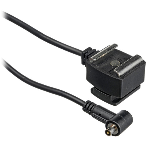

Buy this (pictured below): attach your flash to it...then plug it in to your pc "X" sinc. (pictured above)

I think the confusion stems from the word "new." The short answer, nonetheless, is "Yes, with a bracket and PC cord." Since the 6x7 has no ISO shoe. But it appears the OP has pretty much figured out what to do, so all the rest of this is just -- stuff.
A made in India hot shoe w/PC Cord DL-0136P arrived from Samy's. The Canon Speedlite 430EX flash now works on my Pantax 6x7 and BOY can it get bright. f22 and rich negatives here I come.

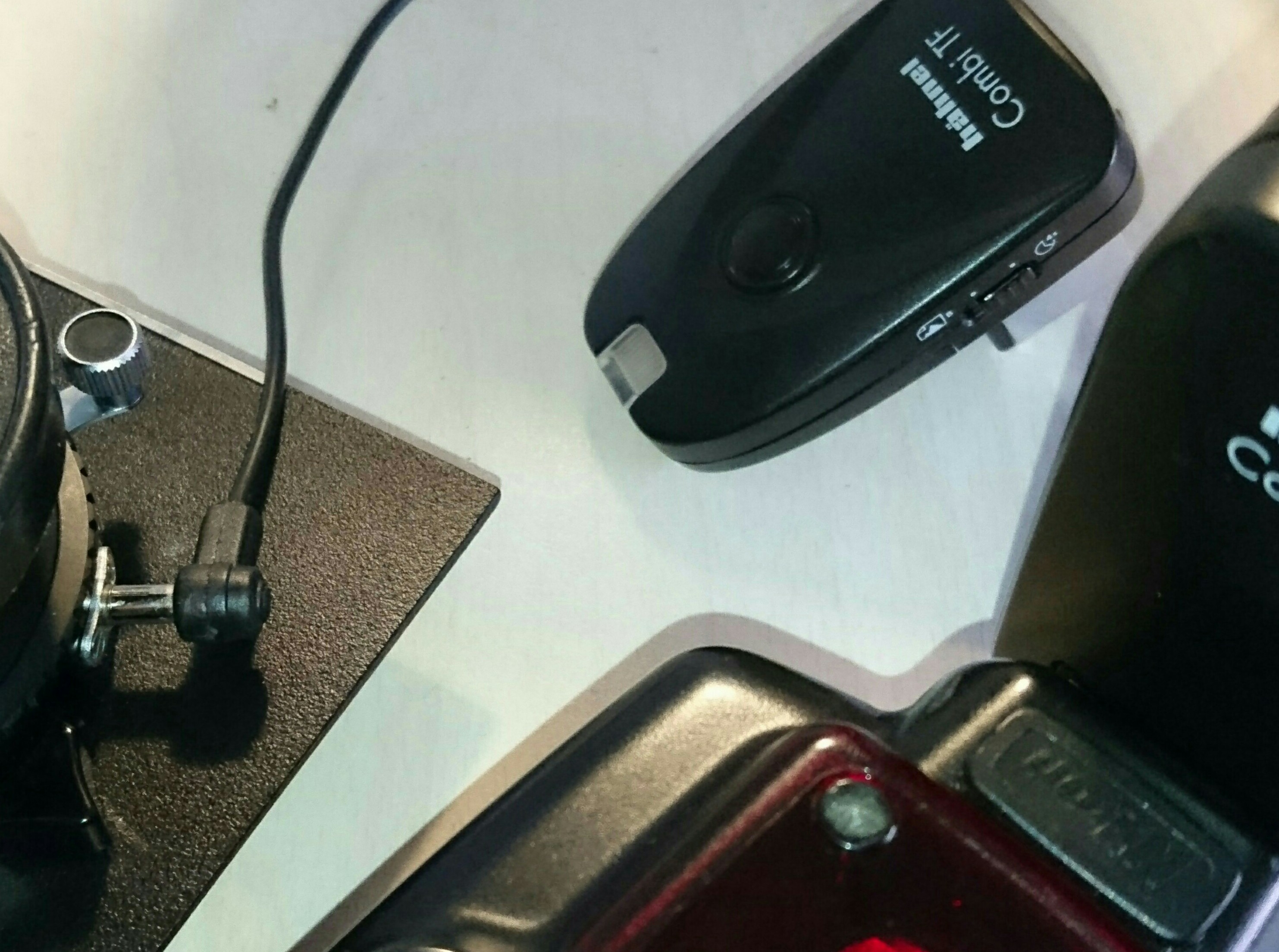

My kit is the one for nikon but it works perfectly in all manual mode with just about any other brand. On the pc-hotshoe adapter ive triggered my flash from my LF shutters and zeiss ikonta 6x6, Yashica MAT 124G and the pc port on the RZ67PROII. It works on the hotshoe on my mamiya (645 PRO and RZ67PROII) and Sony A6000. As long as the centerpin connects your all good. I do however have some Youngnou 602 triggers that won't work with anything other than my nikons (F90x and F100)
To me it's an added bonus that if things go wrong with trigger voltage all you do is Fry a few $ worth of reciever and not a circuit in your camera.
